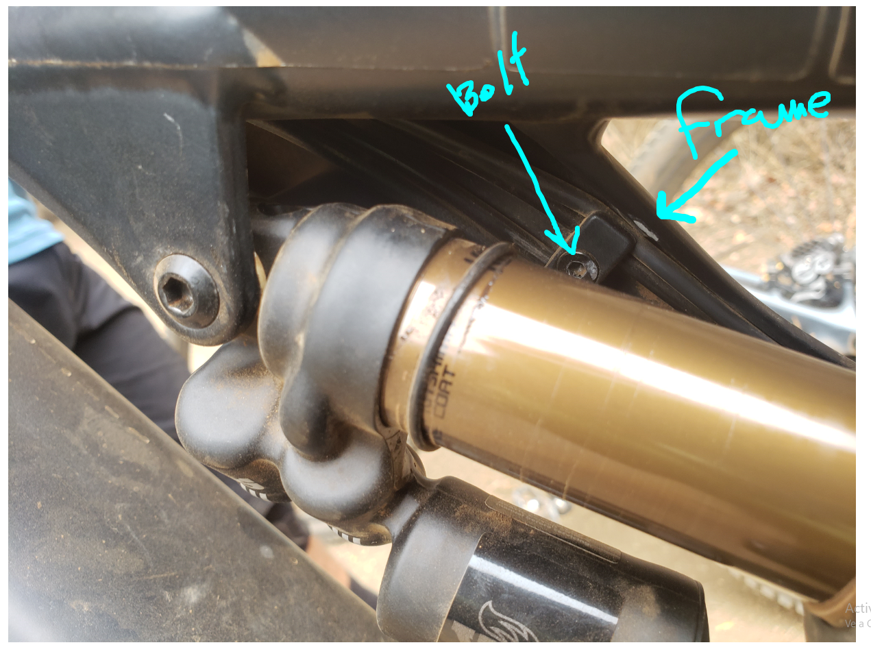

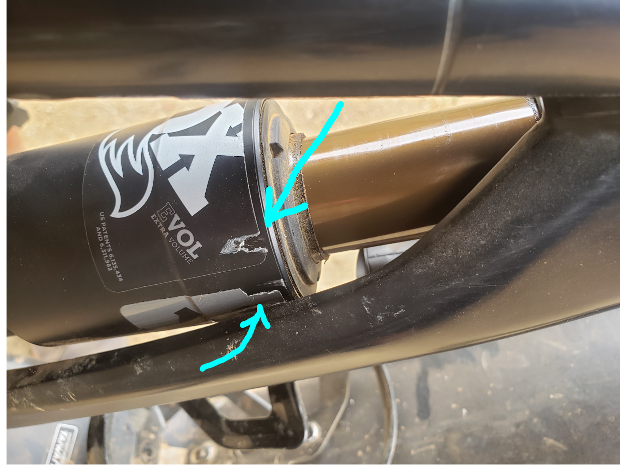

i've mounted a Fox X2 on my Kenevo 2020 and it touches slightly the frame. I don't know why this is happening, it seems the frame are not all equal because i've two friends who have the same setup: Kenevo S3 size + X2 2020 and they don't have any issues.
The shock is 230x65, and i've bought a reducer to transform it to 230x62.5, hope this will solve this issue.
As you can see in both images, there're two point where it interferes. My concern where the frame touch the shock cage, it is less than a milimeter. (The other point is the bolt that supports all cables but it wasn't so tighten so it is solved).

Hi, some people do experience this. In some cases it’s so marginal a slight file on the frame will sort it out

my S4 cleared with a 62.5 stroke
It was so close that I filed it anyways
Wouldn’t want to damage an expensive shock or frame
my friends s3 had rub at bottom out with a 65 stroke

Is it possible to insert 1 mm spacer to the top mount? So that the shock move a little bit away from the frame
