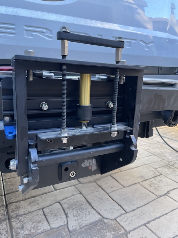

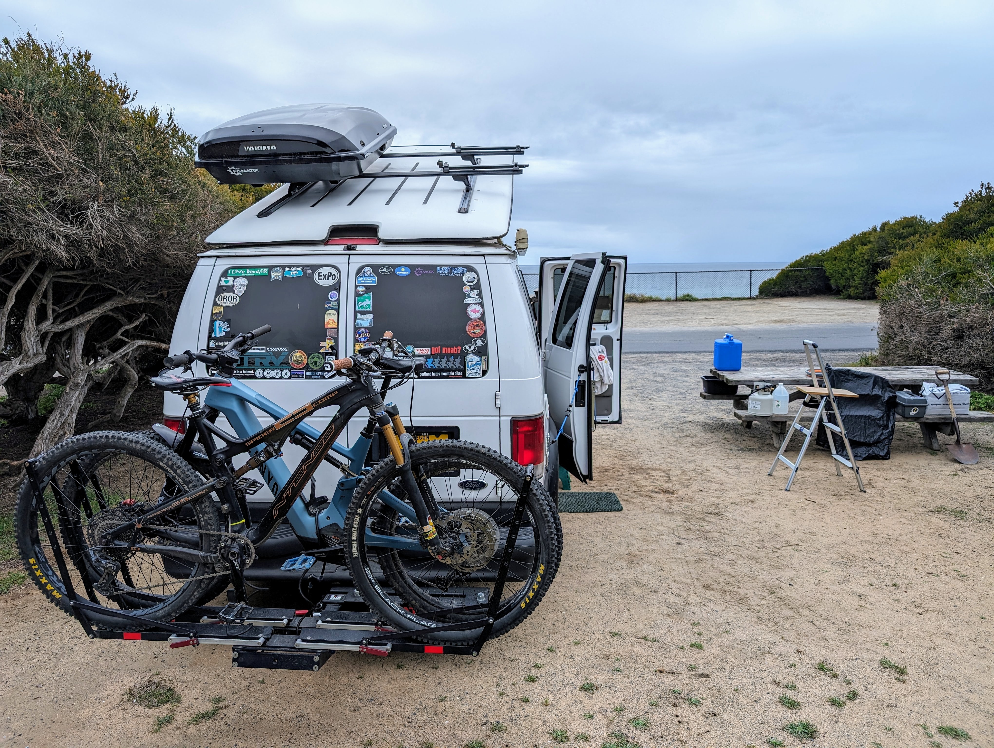

We have the previous version Super Duty rack (75 lb. rating each tray) that we’ve used without issue for six months to carry two Fuel EX-e bikes. I think it’s the same as the previous ‘Heavy Duty” version except with reinforced trays. We had to buy the 1Up to replace a nice Kuat rack in order to clear a trailer tongue. We’ve used it on a Sprinter van and a Honda minivan.

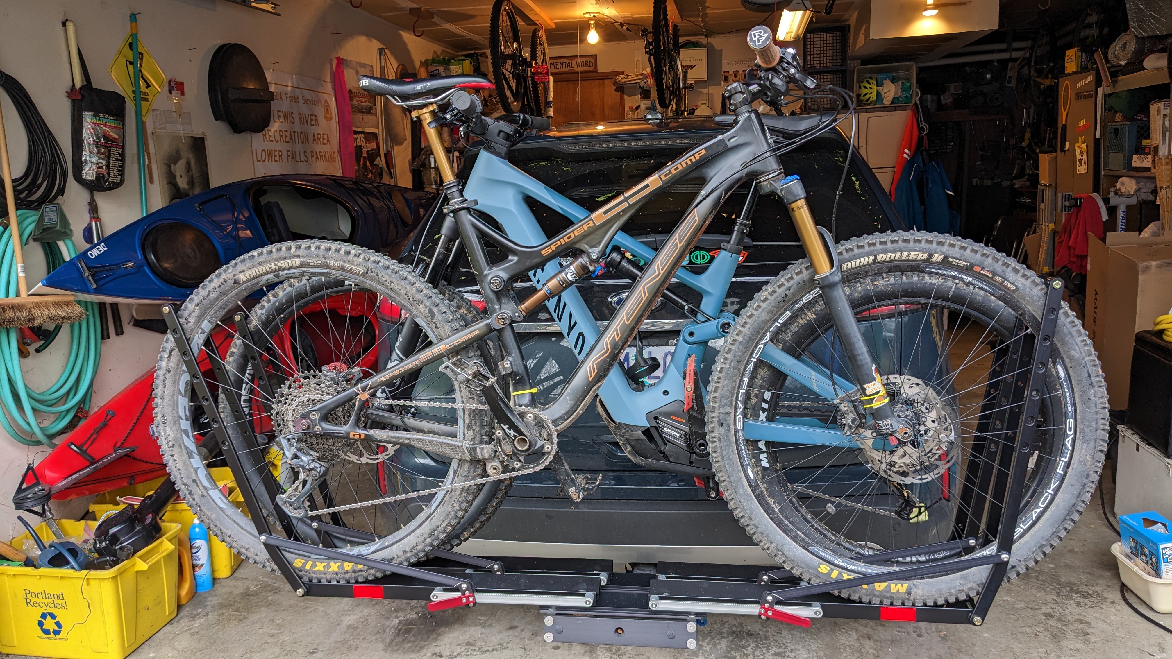

The bikes are easy to load/unload - easier with two folks but my 120 lb wife can manage it alone. No problem fitting two bikes facing opposite directions. We do use a Velcro strap to help secure the back of the front wheel to the tray to reduce some minor wobble, and the bikes appear very stable driving. The rack itself seems more rigid than our Kuat.

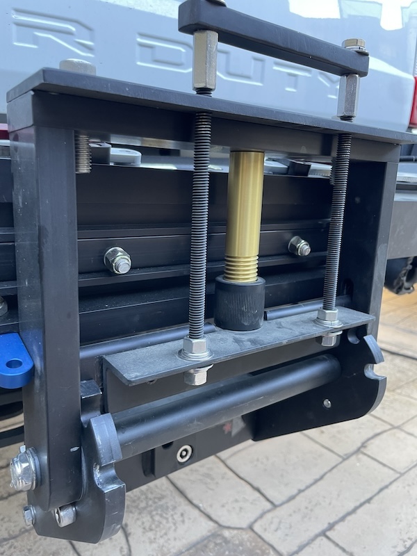

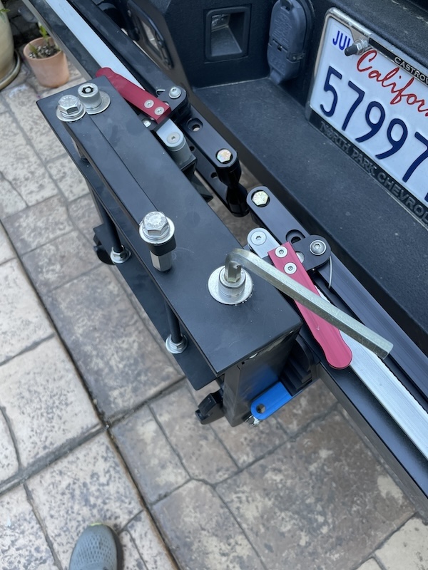

Like you we were also concerned about the wimpy hitch pin. We added an anti-rattle/anti-wobble U-bolt clamp to stabilize the rack in the receiver as we do with all our attachments. Tightening this after the knob that tightens the ball insert makes for a solid, secure setup. We’ve checked the ball knob when traveling and have never seen it loosen (unlike the Kuat ball knob).
The 1Up hitch pin has a lock, but it can be snapped off by knowledgeable thieves. For this reason we add a cable lock at trailheads to at least discourage or slow them down.
So far we’re super happy with the 1Up rack. Overall we like it more than previous Thule and Kuat racks we’ve owned.

Thank you very much. I saw some mention of those u-bolt clamps but can’t visualize how they are used.
levity
Feb 15, 2018
522
1,565
SoCal
Very effective. $10-15 on Amazon.
This one even offers colors to match your bike 😄
