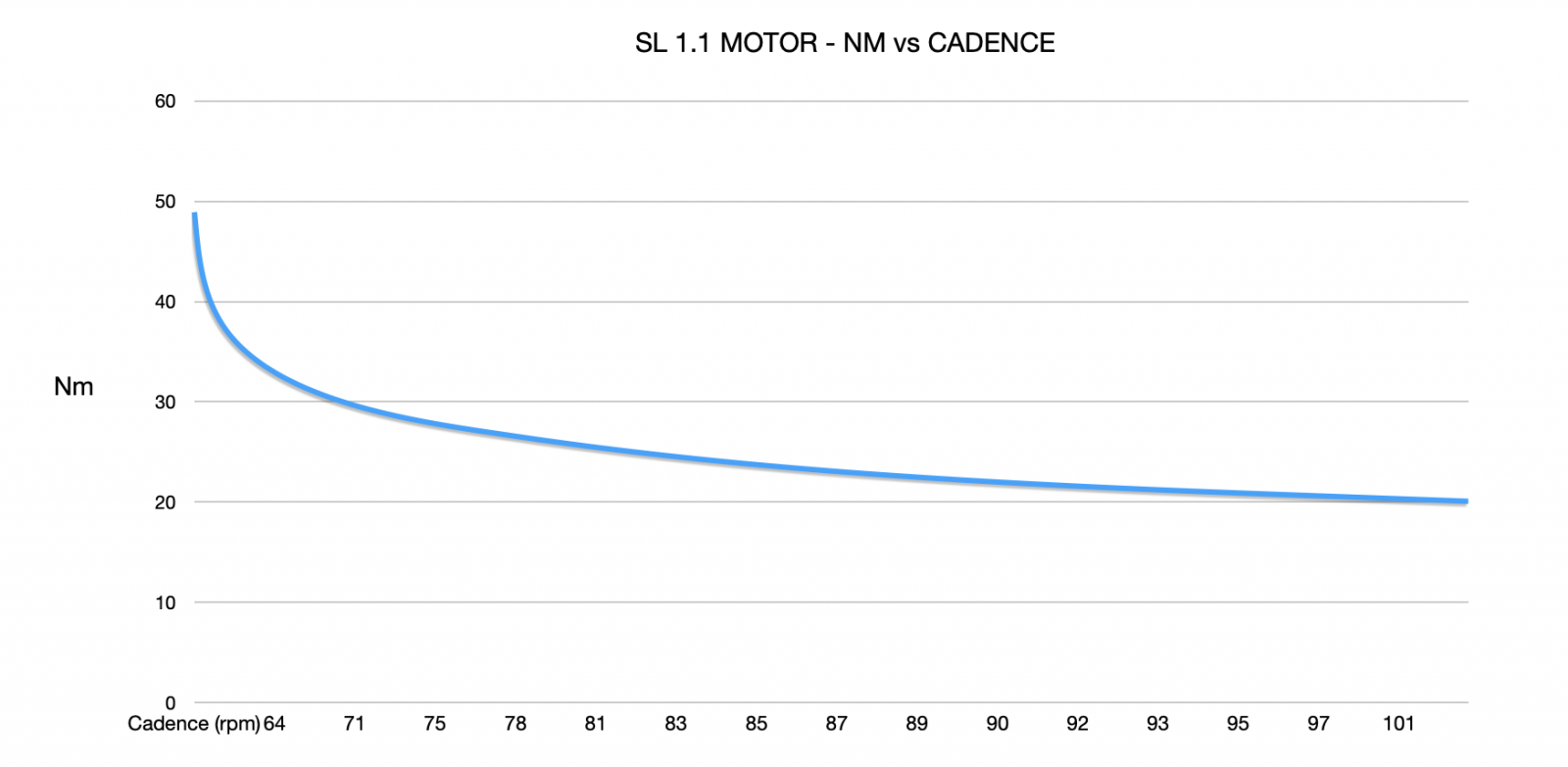

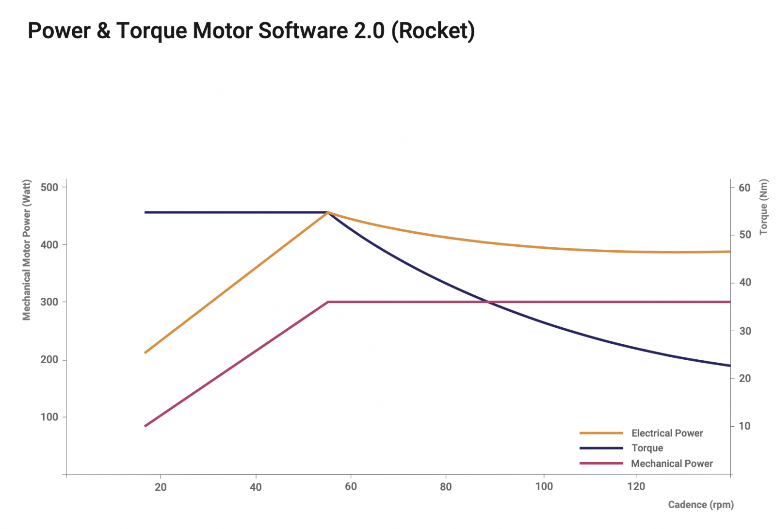

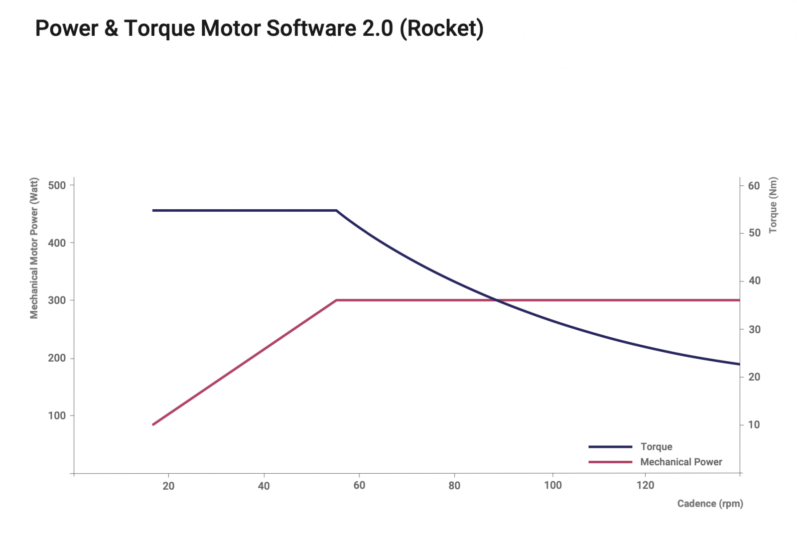

Torque Comparisons:
At a Cadence of 90 RMP, the Fazua will provide approximately 35Nm of torque compared to approx 23Nm on the SL
FAZUA:

There a bit more to it also though. Software and efficiency come into play. Although the power on the Fazua is higher I think that the battery will be rinsed through much quicker.
At a cadence of 80, Fazua electrical power is approximately 410 watts, mechanical power is 300 watts. Thats losing 110 watts (27%) of its power through heat loss / low efficiency.
At a cadence of around 55 there is an even bigger delta. 450 watts Electrical that translates into 300 watts mechanical. 33% of energy is lost (150 watts).

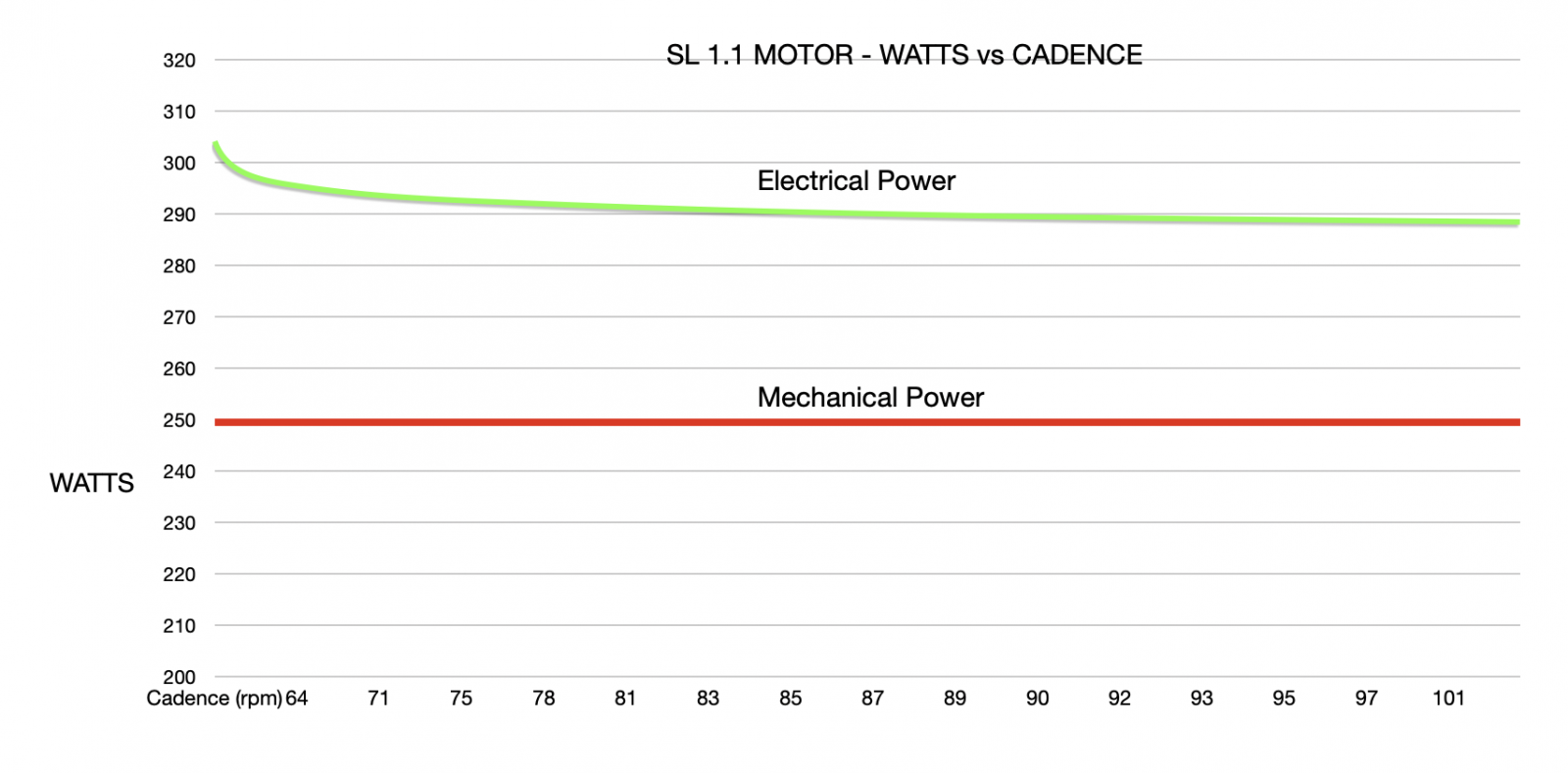

The SL has an electical power of approximately 290 watts. And a mechanical power of 250 watts. Its losing 40 watts (14%) of its power. So much more efficient. Sadly I cant see the same calculation at 55 cadence on the SL, I didnt capture that. But it will be less efficient also at lower cadence, but I suspect not as much as the Fazua.
So you can see that its not just all about out and out power. Its about the entire experience / package.
I suspect that the Fazua will out power the SL on climbs. But id you're on a longer rider there will be a cross over point where the SL power exceeds that of the Fazua due to the more efficient system.
Hope it all makes sense, just thinking it all through in my head!
