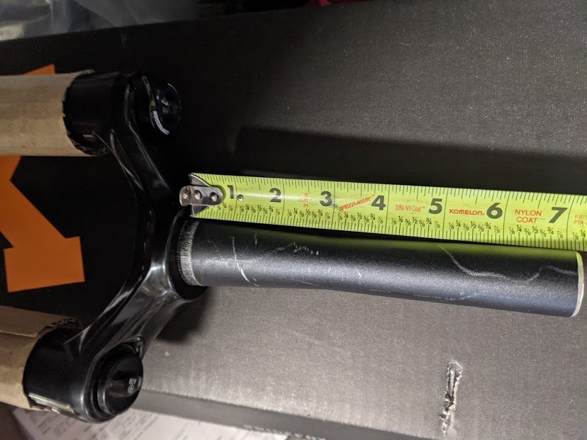

I should start a new thread but does anyone here the fork steerer length on a size Large?
In case anyone is wondering. Stock steerer length on a size Large is about 180mm or 7.125".
