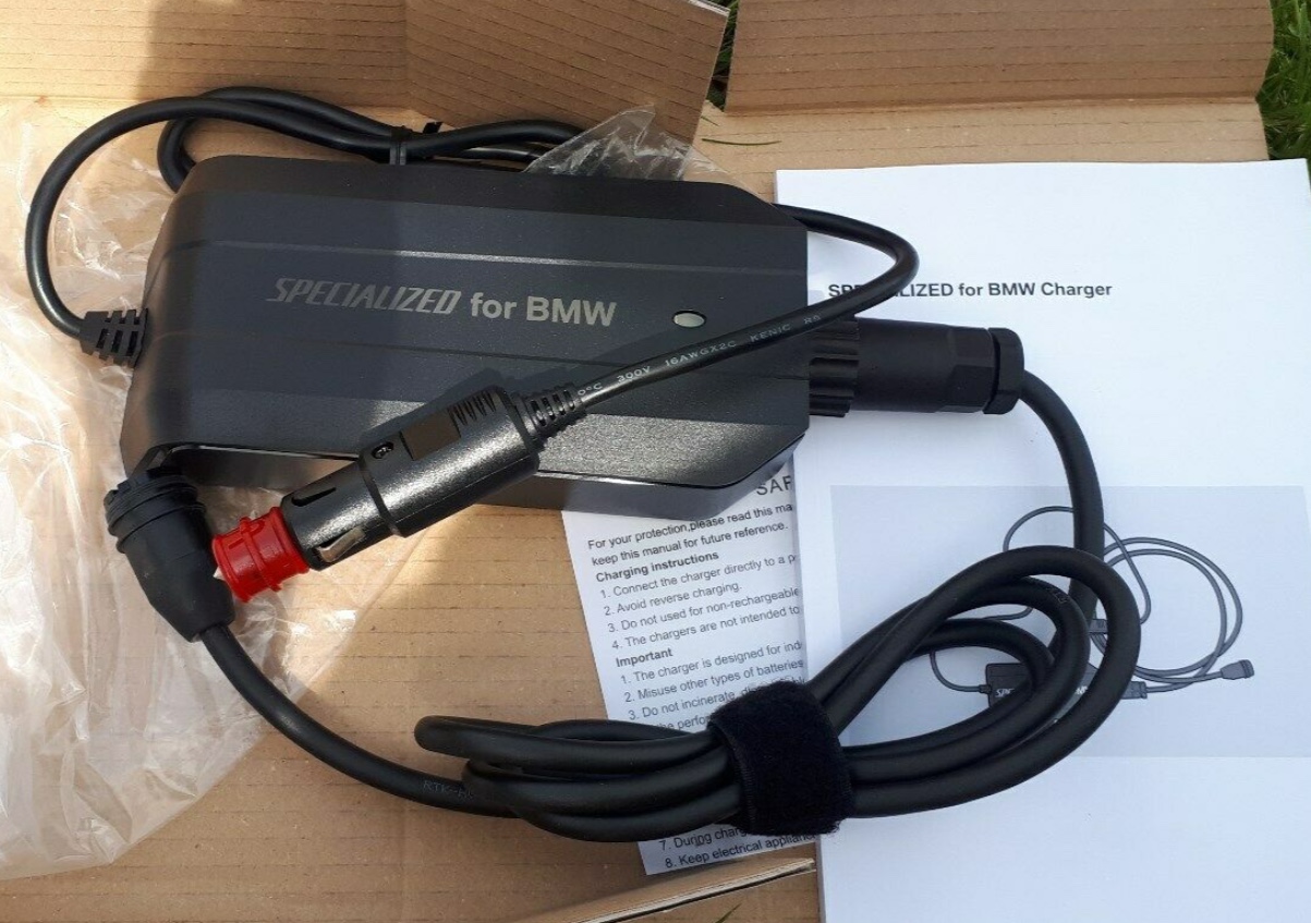

Last year Specialized & BMW released a limited edition Levo complete with an in car charger:
Levo / Kenevo car charger (BMW Levo)
The charge rate is 2A (instead of 4A) in order to be compatible with typical car cigarette lighter sockets.
You can buy direct from BMW. Part number 80922453902. £72 Inc VAT.
Building your own is probably not as easy as you think, see: DIY Turbo Levo charger

Grassicks BMW in Perth obtained one for me. I think it is more whether the parts department can be bothered to look beyond a set of matching mats, and the guys at Perth were prepared to do the digging required. The charger does need to be specially ordered from Germany, but only took about 5 days to come. At £72, why would you try to re-engineer it?

I found one on eBay and am waiting for delivery. This is a picture from the listing:

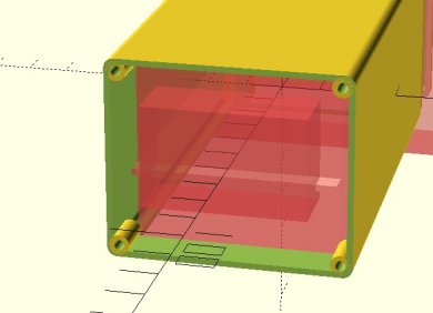

5B1AE421-5064-4E04-8FD1-F26F14CDB202.jpeg Testing proved viable, now I am getting to the safety features along with output options and low voltage cut off for the car battery.
Box test print soon.

Word of caution to those with the BMW 12v charger (or I guess any other 12v appliance).
Was charging with mine today and when I checked it the charger light was switching between red and green every 2-3 seconds, but had only been charging an hour so no where near finished.
I checked the 12v plug and it was red hot! Tried again in a diff end outlet and got the same result!!!
Gonna hard wire it in the morning via a decent switch and fuse.
