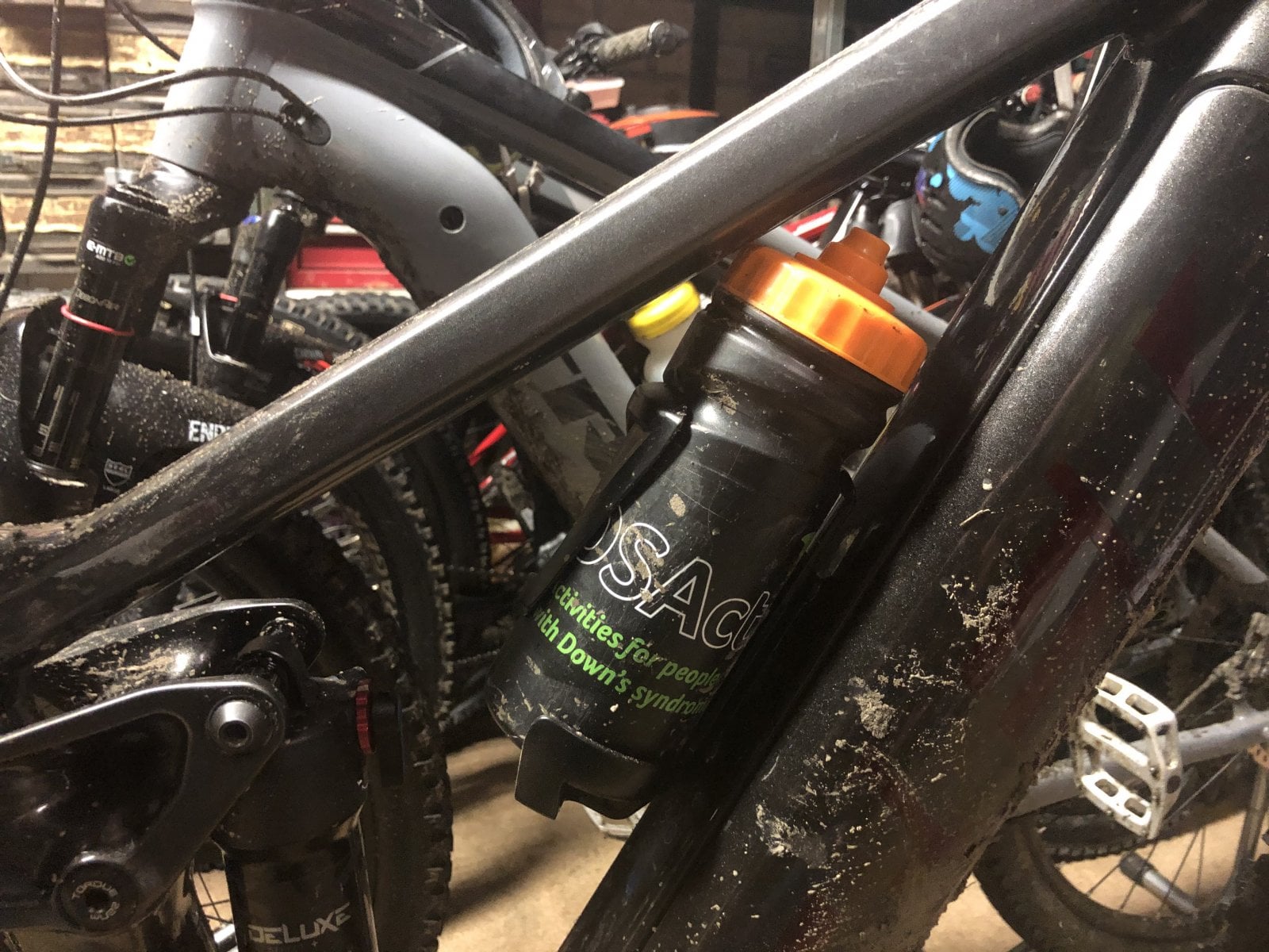

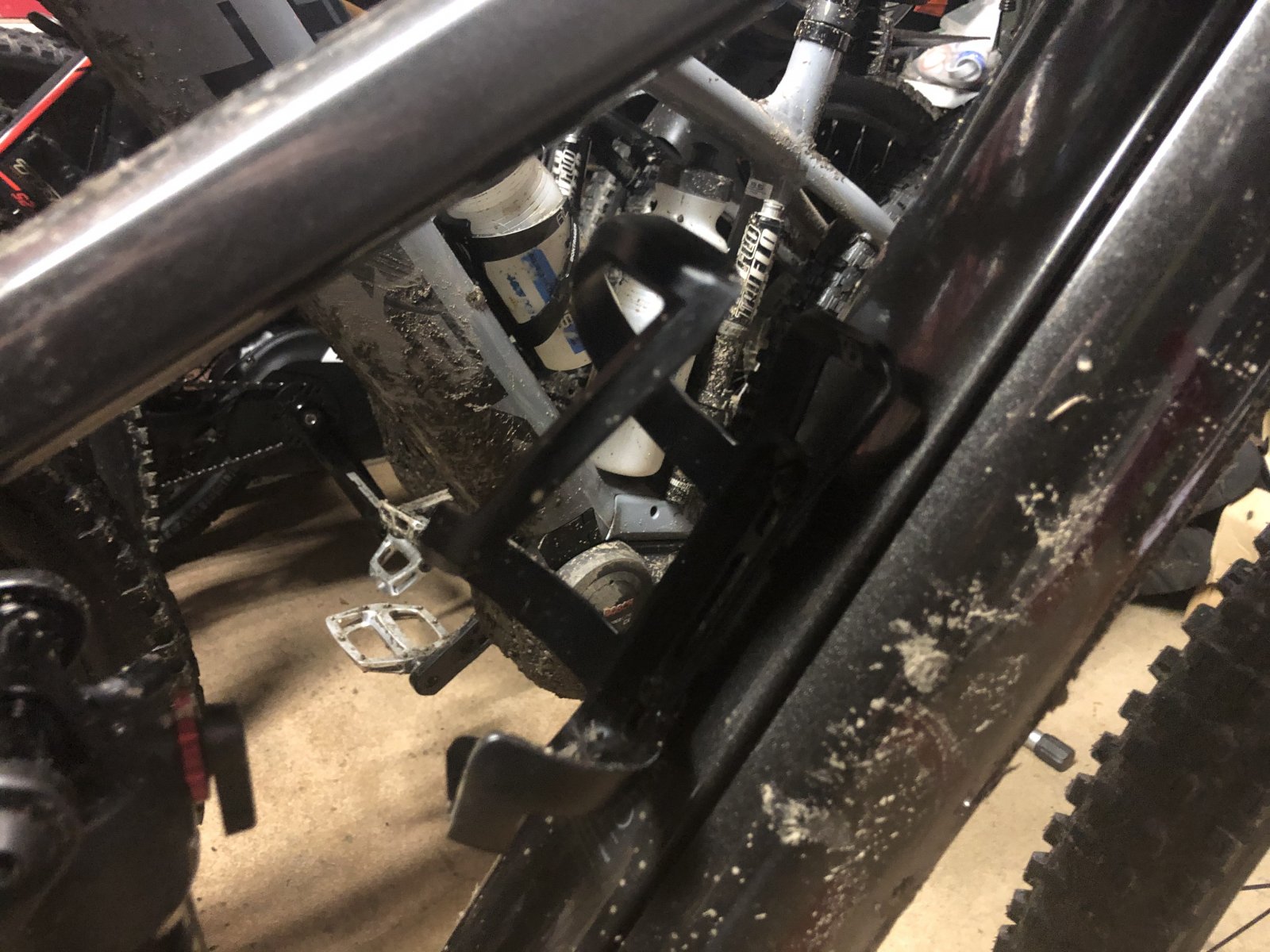

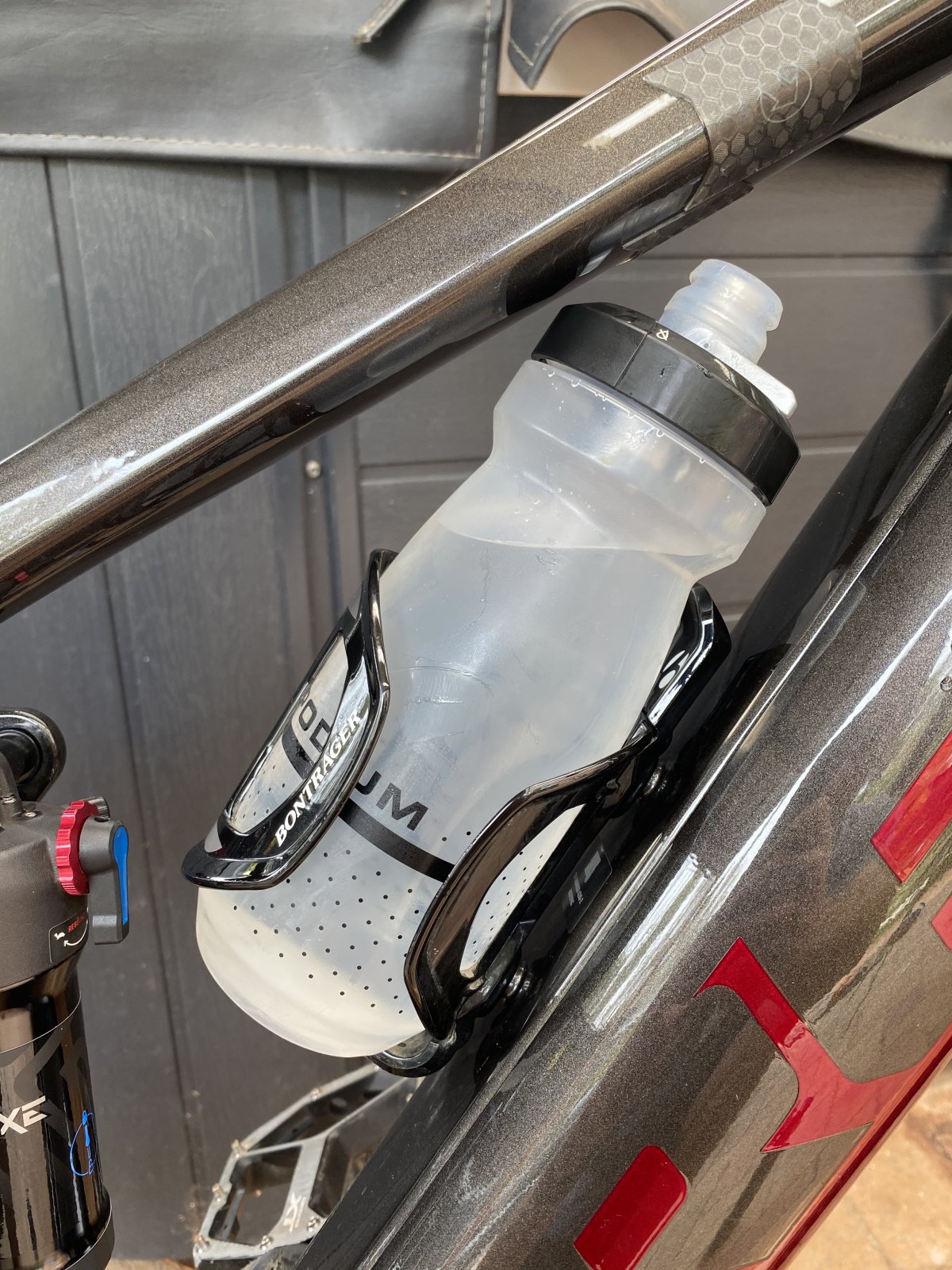

Bontrager (older one) you can switch to be either side exit. With the Camelbak Podium Chill 620ml it JUST fits. I used frame tape to stop it scuffing. You can use the non-insulated one (second pic) 620ml which is a couple of cm shorter if you’re worried.

Mine is Large frame too and I have been using CamelBak bottles. So exactly what I was looking for? Thanks! I guess the exact model is Bontrager Sideswipe?
Good Times
Nov 8, 2019
101
84
Sydney Australia
I would say that’s the latest equivalent. Mine’s about 4 years old and I think they’re a little different now. But works a treat, bottle doesn’t shift ever.

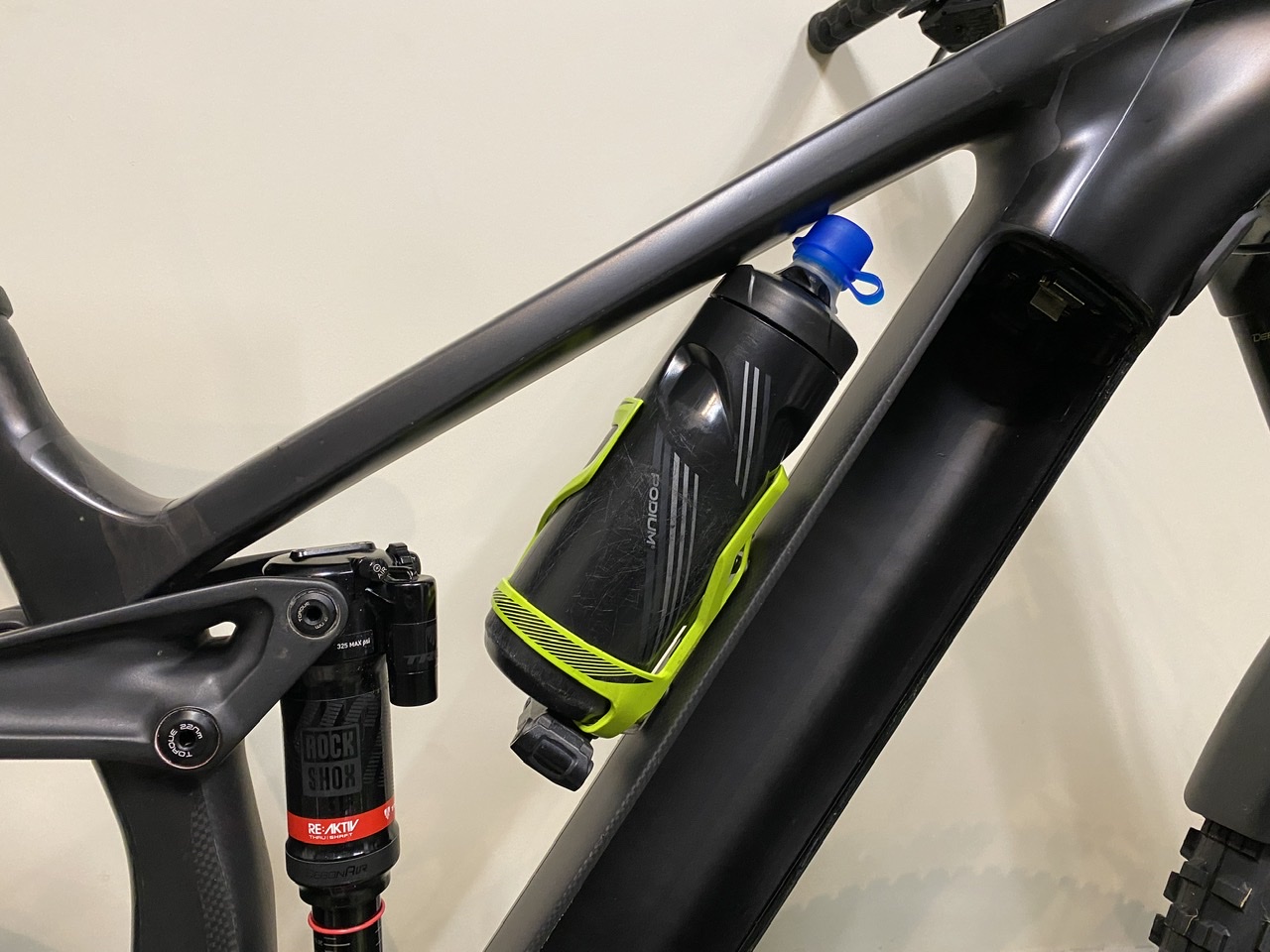

Here’s the Specialized cage off my Stumpy - complete with SWAT tool attachment.
The bottle is a Camelback Podium, and is slightly bigger than standard... and it rubs when in. A standard sized bottle would be fine.
