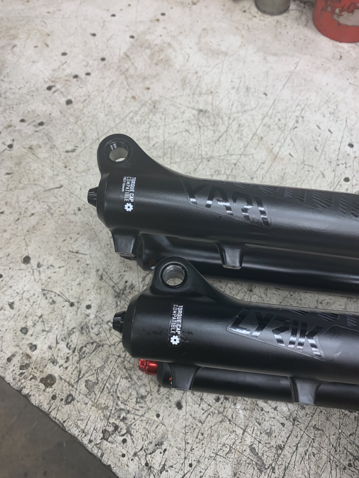

Has anyone upgraded their fork to a new model that doesn't have the extra think crown that Trek have specced on the rail models?
I have a 2021 9.7 on the way specced with a yari, and I have a set of lyriks with the push ACS3 conversion on my 2018 Slash. Will be doing the majority of my riding on the Rail going forward so wouldnt want to waste these forks just sitting in the shed. They do however just have a standard size crown.
Has anyone upgraded in a similar manner? Got any pics to show?
Cheers!

I thought the yaris & lyriks were the same chassis but different internals? COuldn't you just swap the internals over?

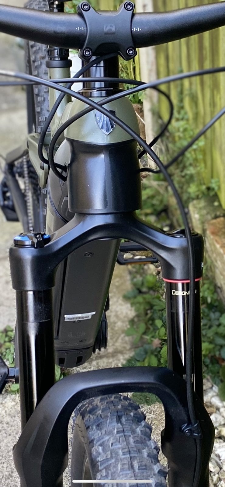

Cheers!
Yes I have on my rail 5 no issues at all!
I think the spring will have knocked around the inside of the stanchion tube enough to cause issues with trying to put an air spring back in its place. Push are very vocal on it being a one way ticket, guess it couldn't hurt to try though..
TF tuned have informed me that they can use the smash pot conversion system in the other leg using a slightly different travel (eg, 160 to 170mm). They swap the damper over. That way, you can swap it all back if you want to sell on as original or convert back again.

I have normal Lyrik on my Nomad and compared to that Rail's Yari chassis also has different lower legs. Biggest difference is length so changing fork to standard you will alter the geo of the bike.
It is as simple as just swapping the parts left to right?
Not too sure. They did say that travel would need to be altered slightly, say by 10mm, for some reason. Give them a call. They’ll be happy to talk you through it. There’s 2 employees in there that have done this and added a 230x60mm Ohlins. Basically ups rear travel to 157mm with 170 fork. Think they ride mino link in low to balance it out a bit

I swapped the Yari for a DVO D1, that I had to upcycled from 27.5 to 29, since it was on my previous EMTB. The fork doesn't look to off with a smaller crown. But what looks funny is the 26" bike that inherited the Yari with the oversized crown.
Did you consider the leg (length) difference might have something to do with comparing a 27.5" Lyrik to a 29" Yari?
