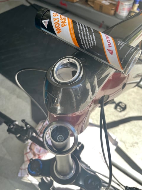

Drop the fork and grease the headset bearing .. My Rail 7 was seriously lacking in grease on that bearing and I was getting a creaking .. bit of grease and its sorted.

Rail 7 with less than 10 rides all off road and the creaking definitely seems to be coming from the headset. Will address as per the suggestions here by @Davidwylie & @BrentD Thanks for posting reporting back @Drewf The creaking has been progressively getting louder. It's not motor or crank related. After the last long ride it was getting to be so noticeable had to start looking for answers.

Task done yesterday but only tested it around the house. Seems quiet so far. Kind of surprised at the size of the bearings. Was thinking maybe they'd be tapered and much larger. Often forget I'm working on a eMTB not a moto. Seems these bikes are going to take some regular attention to keep in top shape, which is fine by me. The fun factor is so damn high. Also wondering if some of the creaking might've been coming from the cables flapping against each other. Spent some time trying to route them a little cleaner. We'll see.....

So stripped back mine, It was a cracking/creaking noise. didn't happen all the time and the amount of gunge that came out was unreal!
We cleaned the bearings and the seating and the reinstalled it all and it seems fine now!

The second time it happened was last summer. So during the second summer of my bike. I located the noise to the headset. I did something I really did not want to do. I started to take the headset apart, by the advice of the local trek dealer. I found it quite dirty and also a little too dry, along with places that had some rusty Color. I again went to work with my grease. Greased it up and put it back together. The end result is zero noise from the headset.
By advice from the local trek dealer, I try to put some waterproof grease on the connections of the headset regularly.

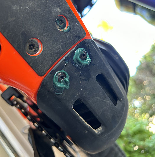

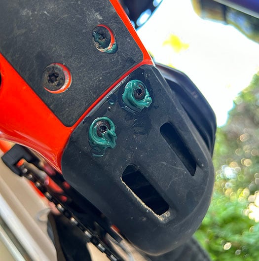

had this creaking issue on my Rail 9.8 for several months, kept getting worse. I chased every single pivot bolt, removed and lubed. relubed the headset, cranks, pedals, etc. even replaced the main bearings as i was sure that was it. nope. could not locate the creak to save my life. i was finally able to trace it to the area around the motor....and.....it was these two little mf'ers right here. both were a little rusty, and one had worked loose...lubed them up, problem fixed. hope this helps somebody fix their creak quicker than it took me. i never imagined such a small, meaningless screw would create so much havoc...
Wow, that is for this!! Despite fixing the major creaks, I can still hear something so I will give these bolt a check over at the weekend! Would never have guessed they’d cause an audible creak!
