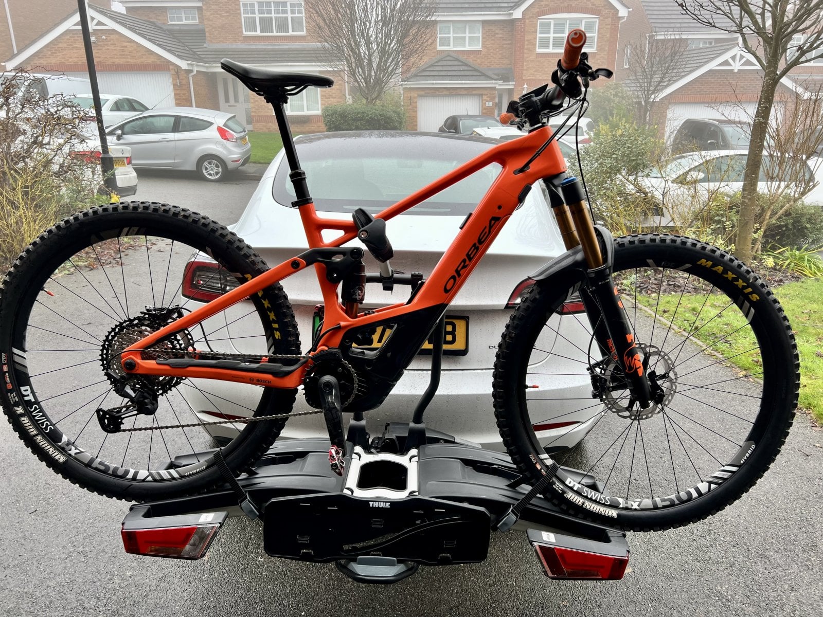

I have the Buzz Rack E scorpion on my Tesla model 3.
I only have the one bike version, but they make a two bike one.
I chose the one bike version as you are limited to the nose weight limit on your tow bar, which I think by memory is 58kg.
So two e bikes plus the weight of the carrier which is about 18kg would be pushing the limits.
It does effect the range of the car, but not by as much as I thought.
I think my average watt usage is about 240, and the bike fitted brings it up to about 290, that's traveling at about 60mph on the motorway.

Hi, I have a model 3 and just watch out as the weight for a bike carrier and bikes combined is only 54Kg. This meant selling my easy fold XT and getting an eurorider to drop the weight of the rack by 4kg. In order to get under the or just over the 54kg I have to remove the batteries from our bikes, seat post etc which gets us to around 55kg with both bikes on board. Yeti 160e and a Cube Sting BTW.
Thats based on the factory fit detachable tow bar.
