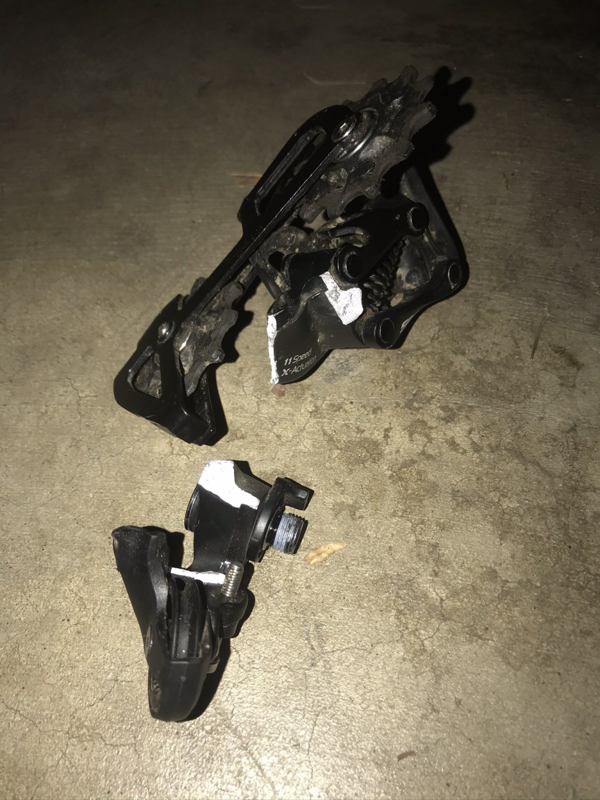

Hi guys anybody seen this before
I pedal to the top of the hill, the chain was slipping from on gear to other on small gears.
I stopped, check. Upside down bike and few test. Nothing aside the chain seem a bit loose but nothing to concern
when I started to pedal to go downhill. I felt a crank noise, and next when I saw toward the drive train, the chain and the jokey were tangled and the whole derailleur strip out of the fork. I guess the chain becomes loosed, and got off alignment getting off the jokey and with the torque of the pedalling got tangled and the force literally stripped out the whole derailleur
any way, I have rode 1000 km in about 5 months, so I don’t think I have abused the bike. Yes ok I am heavy (100kg) but don’t think that was an issue with mtb. And the chain will be kore robust
question it is time to upgrade? Anything better than the standsr drive train?
recomendation size and model would be appreciated it
I guess this is not covered by the guarantee?
cheers

I’ve got one , that looks exactly the same, also trashed three spokes, so needed a wheel build as well.
Why the hell is it not on a gear hanger that brakes, not the whole bloody unit snapping off?
I didn’t upgrade in case it happens again.......

And you guess right .... it’s not going to be covered by warranty. £90 for a new unit. New inner cable , and set up .

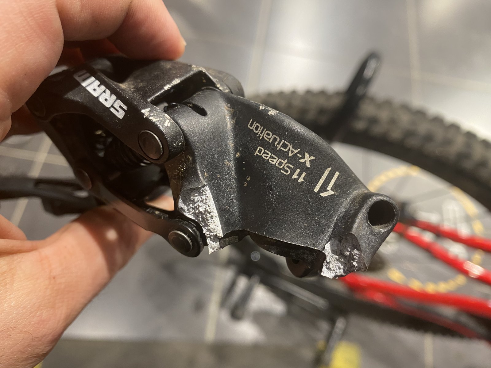

Buy a new one unless there is a less expensive derailleur that's compatible.
Buy it online and for sure send the broken derailleur to SRAM. PLEASE IGNORE what others tell you about it being trail damage, the derailleur is warrantied for two years send it with no note just your return address, please let the forum know what happens. SRAM is not as easy as Shimano, I'm 4 for 4 with Shimano my buddy has not paid for Shimano pedals, shoes, and derailleur's in 8 years. I sent pads and disks back with the same success. I may beat the shit out of my bike's, not sure. However I break derailleur's every six or so months, usually sticks getting sucked up into the drive chain near the derailleur. Most times it breaks the derailleur in half between upper and lower pivots that thrust the chain cage to change gears. I'm too impatient to wait for Shimano so I buy a new one, the free replacement takes 3 to 4 weeks. Then I'm home free, spare derailleur in stock, just send in the next broken derailleur, install the spare keep riding, rinse wash repeat. Since the parts break so often I buy the least expensive that's compatible, XTR shifts really well, unfortunately it breaks just as easy and for slightly crappier shifting I'd buy two for the same price. Just sayin?
So last piece of free advice you never asked for. Ebike's are nearly 3/4 of a horse power in high, that beats the living shit out of the entire drive train, if it connects to the motor it's going to break unless you replace it before it does, cassettes 750 mile max, chains 350 unless you clean and bathe your chain, $28 can't be bothered. When you step back and look rationally at what is being asked of an electric mountain bike, wearing parts should be expected. Some good riders are able to ride without putting the same stress on their bikes, I don't ride that well yet!

Ok im going to bag mine up and send it back to Sram , I will post back what happens.

Yeah happened to me when a stick got caught and I stopped quick but it bent it bad. Tried to bend it back a bit and bam. Snapped
