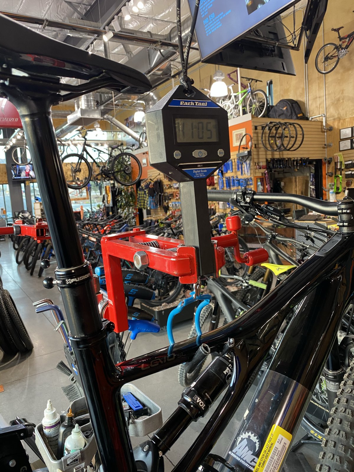

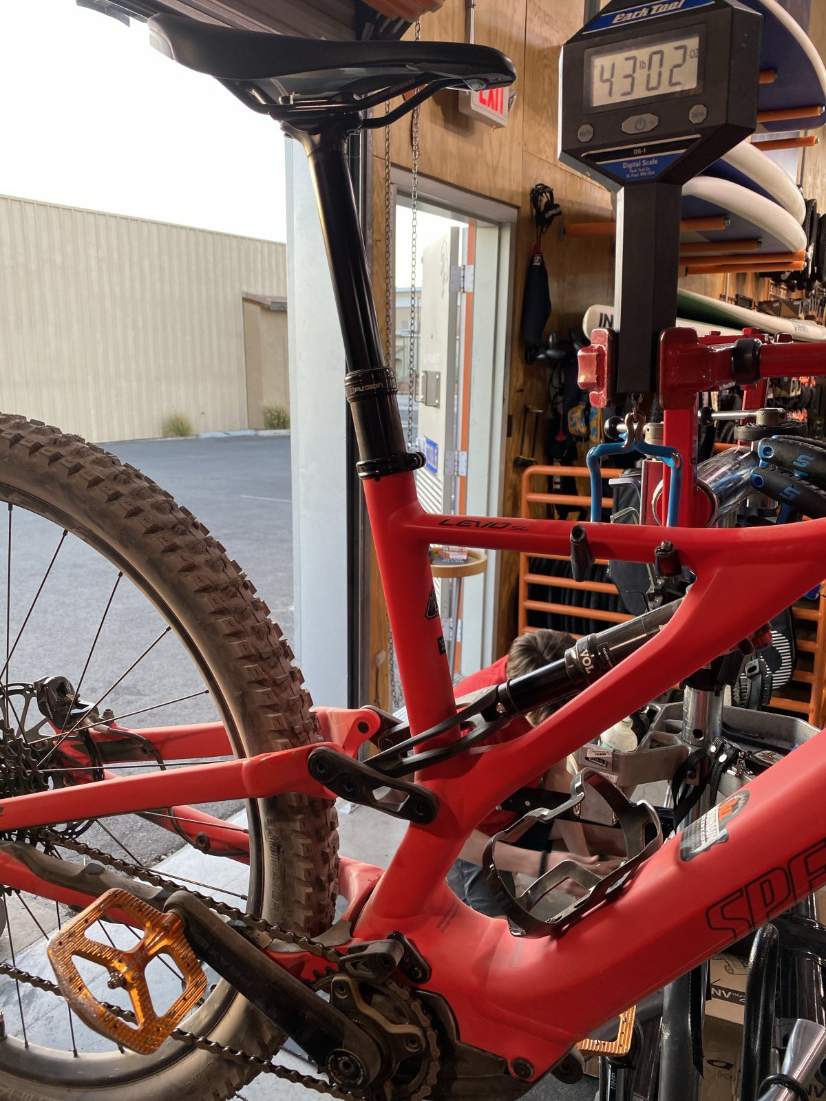

It’s about 3lbs actual.
Pictured alloy bike was without tubes (513g).
Pictured Carbon comp, exactly the same except frame and tubes.
Diff 1lb 13oz or 1.81lbs plus tubes at 1.13 = 2.94 lbs difference.

I assume the tubeless bike had sealant in it - in which case the difference between tubes and no tubes would be less than 513g.

Yes, Same pedals.
Ok RE sealant, yes. Estimate the sealant at between .2 and .4 lbs, then alloy frame is ~2.5lbs heavier.
I was leaning towards alloy until I did this research. Just too much weight difference.

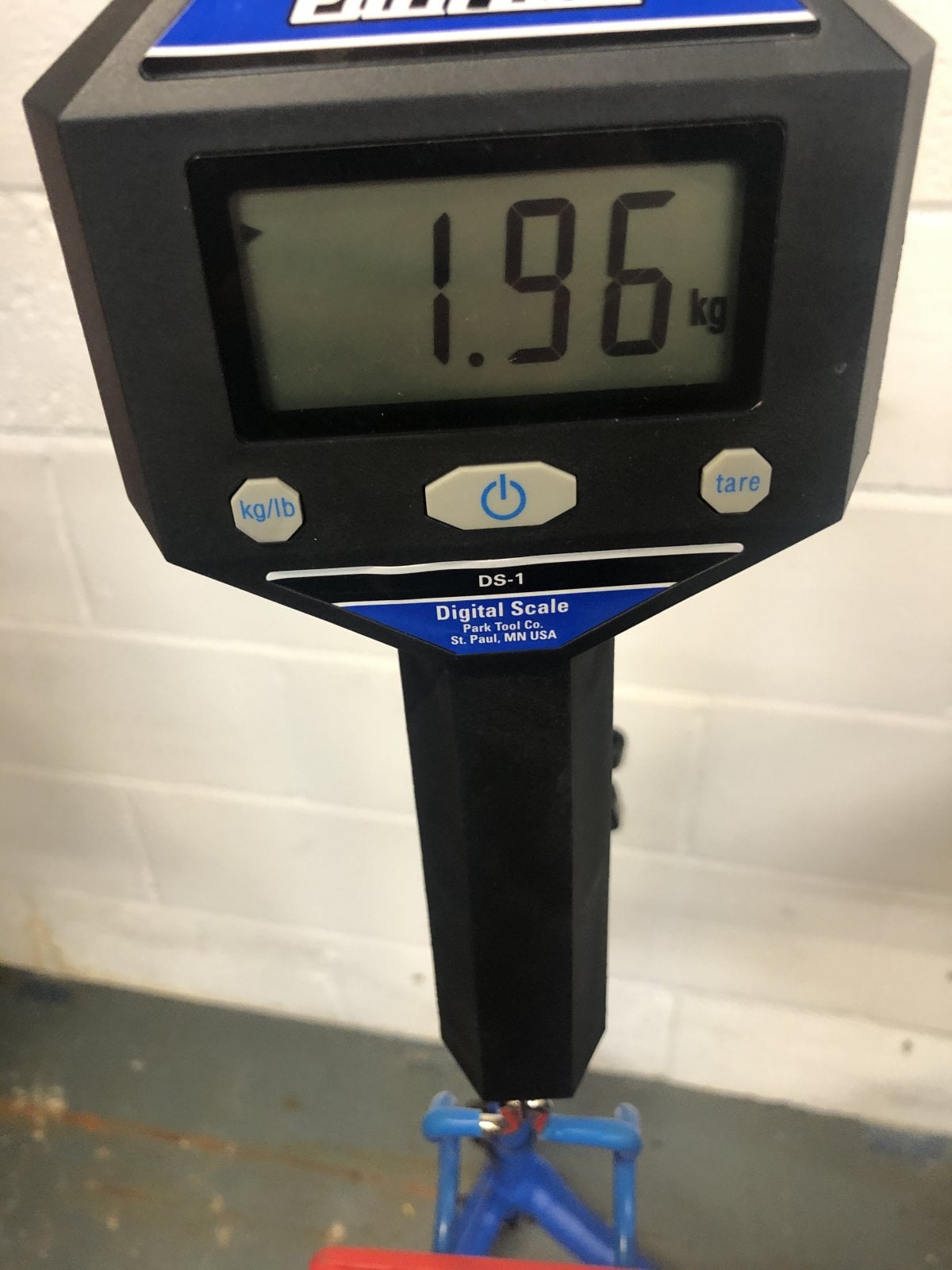

@73Steff kindly posted the weight of his Alu Levo SL's front triangle, chainstays and seatstays.
5edfb520-a19a-4bc7-b84b-7ab0be283c4f-jpeg.26233
For anyone struggling with basic arithmetic that'd put a carbon SL front frame triangle, chain and seat stays at just 830g (this doesn't include the linkage, bearings or hardware though)
Not impossible I suppose. But I'd be incredibly surprised if it's as light as that.
Carbon XC hardtail frames aren't as light as that.
