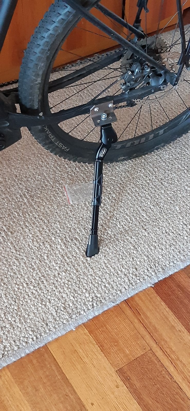

Specialised don't have a bike stand for the Levo, despite having two holes in the L chain stay - weird. Looked on Amazon - most products have no description, bad photos and confusing reviews. Bought a fischer model 85995. Confusing reviews suggested it could be fitted onto a chain stay. Only one picture. Luckily, a bike-riding friend and his machinist flatmate made a bracket. See photo. It works well. However, the original stand bolt and its spring washer is the weak link - it comes loose very quickly. However the stand still works. Will have to go back to Nuts and Bolts, Tasmania. I have full confidence that they will spend 10 minutes finding the best solution and charge 50 cents for a washer or two. Total legends.

Thanks, everyone. If I'd known about this forum, I would have got the right stand in the first place :mad:. Appreciate the attitude but I am almost 60yo. The Levo is my everything bike. Will take the stand off when I go into the wild.
