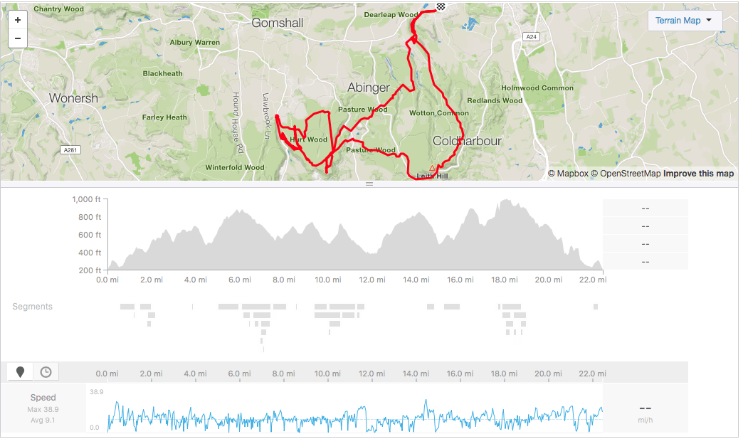

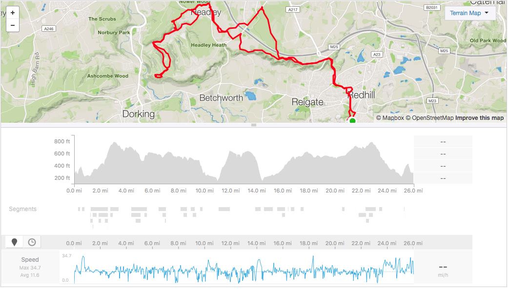

Both these rides i had just hit red when finishing, prob 70% of each ride in trail. I am around 14 stone with riding kit on. Bike is a Vitus E-Sommett.

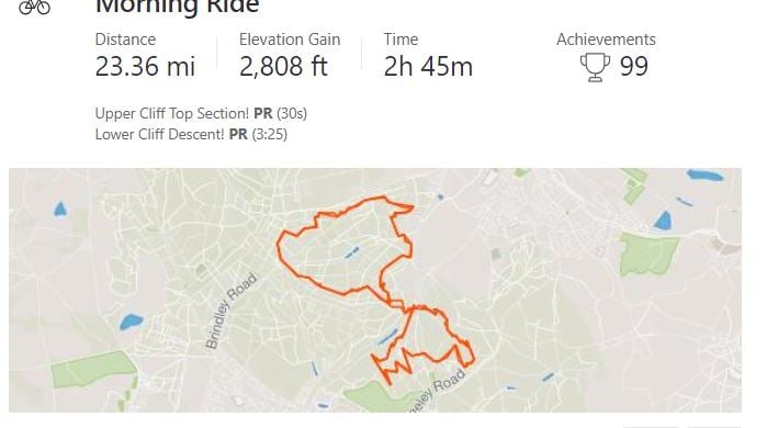

Elevation gain was 744 meters, rode 34.88 km and battery ran out at about 33 km. Total ride time was 2 hours and 1 minute, all in trail until the battery died. Don't know what my cadence was, but it was fast, as I was trying to get another E bike KOM.
That does sound a bit on the low side to me as well, but not massively so. And it sounds like you're getting consistently similar results. I'd be wondering about them if I was seeing the same - which probably doesn't reassure you!
I wonder how much effect the ground surface could be having, e.g. if the whole ride was over soft sand or something. Do you always tend to ride over the same surface? Maybe try a whole ride on a hard surfaced road for comparison if it doesn't bore you :)
I'm also thinking about any down hill sections you do - do you keep pedalling when going down hill and with motor assistance still on (i.e. under the 32km/h (?) in NZ) ? For instance where I am, when I've gone up a hill, then I'm mostly free wheeling down the other side or pedalling past the motor assistance, so down hills are "free" for me.
Am I right in thinking the assist limit is 32km/h there or is it 25km/h? Or are you even running derestricted? If the limit is higher then the motor could be running more of the time, and actually having the effect of reducing distance? Which sounds a bizarre thing to imagine being true, but it could make some difference maybe?
Ok so converted for my UK brain to make sense of you managed 2440ft elevation in 20 miles with an average speed of 10mph. what average speed would you manage on the same ride on a normal mtb?
What was the terrain? you say pumice? is this hardpack? or loose gravel? technical? smooth? dry or wet?
What was the overall profile of the ride, lots of sharp climbs or longer steady gradients?
You don't know what your cadence was? surely you know if you were ushing high gearing or spinning low gearing while climbing though?
How did you climb? fast as you could every where?
Where was the (green) assist bar on the display mostly sitting while pedalling? full? almost full? from what you're saying it sounds like it would have been pretty high the entire time you were pedalling.
What tyres? width? compound? pressures?
What do you weigh incl all kit?
and lastly why are you so concerned with getting meaningless KOMs on an asisted bike? some riders might be in Eco while others might be in Boost or have an entirely different system. it just doesn't make any sense to me.
