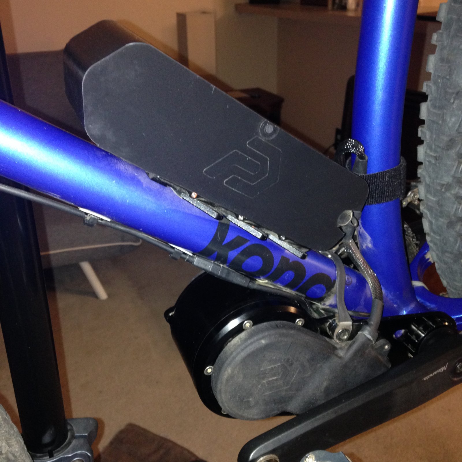

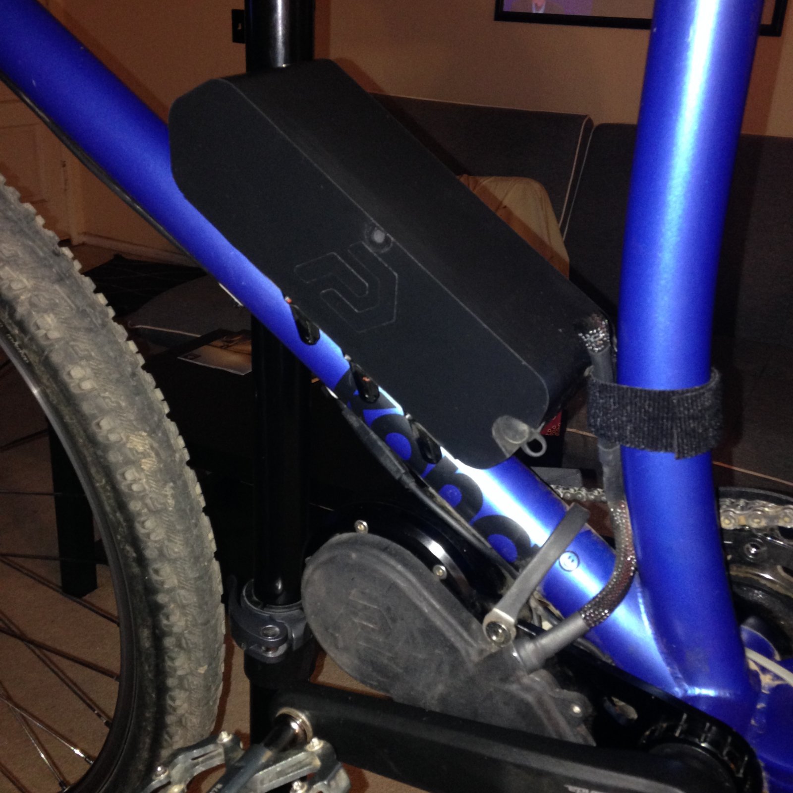

Just received the Revel Propulsion kit, which, including battery, is assembled entirely in the US. The kit was packaged extremely well and is a masterpiece of design and execution. Weighed the motor/controller, display (which can vary the speed from 20 mph to 28 mph) and mounting hardware and it was slightly less than eight pounds, replacing two plus pounds of BB and crankset, so net less than six pounds. The battery and cradle, which mount using the water bottle bolts on the downtube, weigh slightly more than four pounds. The kit has a torque sensor and is PAS only. Torque is rated at 60 nm so designed for individuals who like to pedal. I'll update this as the build is completed, but any questions, just ask. BTW, I'm not affiliated with the company in any capacity, but have been waiting for a light weight mid-drive like this for a long time.

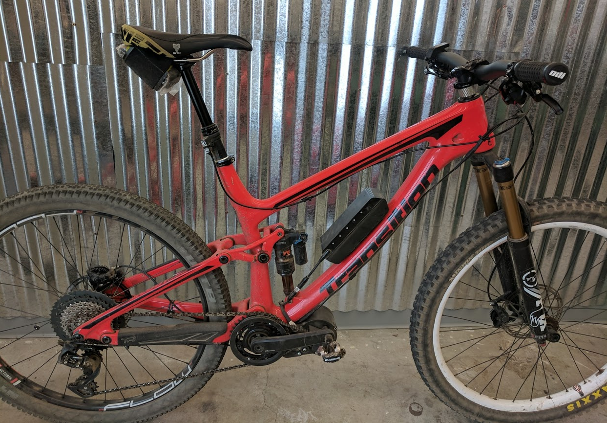

Here's a pic of one of our conversions. A Transition Scout carbon. About 40 lbs with relatively heavy bits and pieces (but a decently light frame). High efficiency and light weight allows us to use a small, lightweight 378 wh pack. Additional packs can be added parallel (if you have room to mount them).

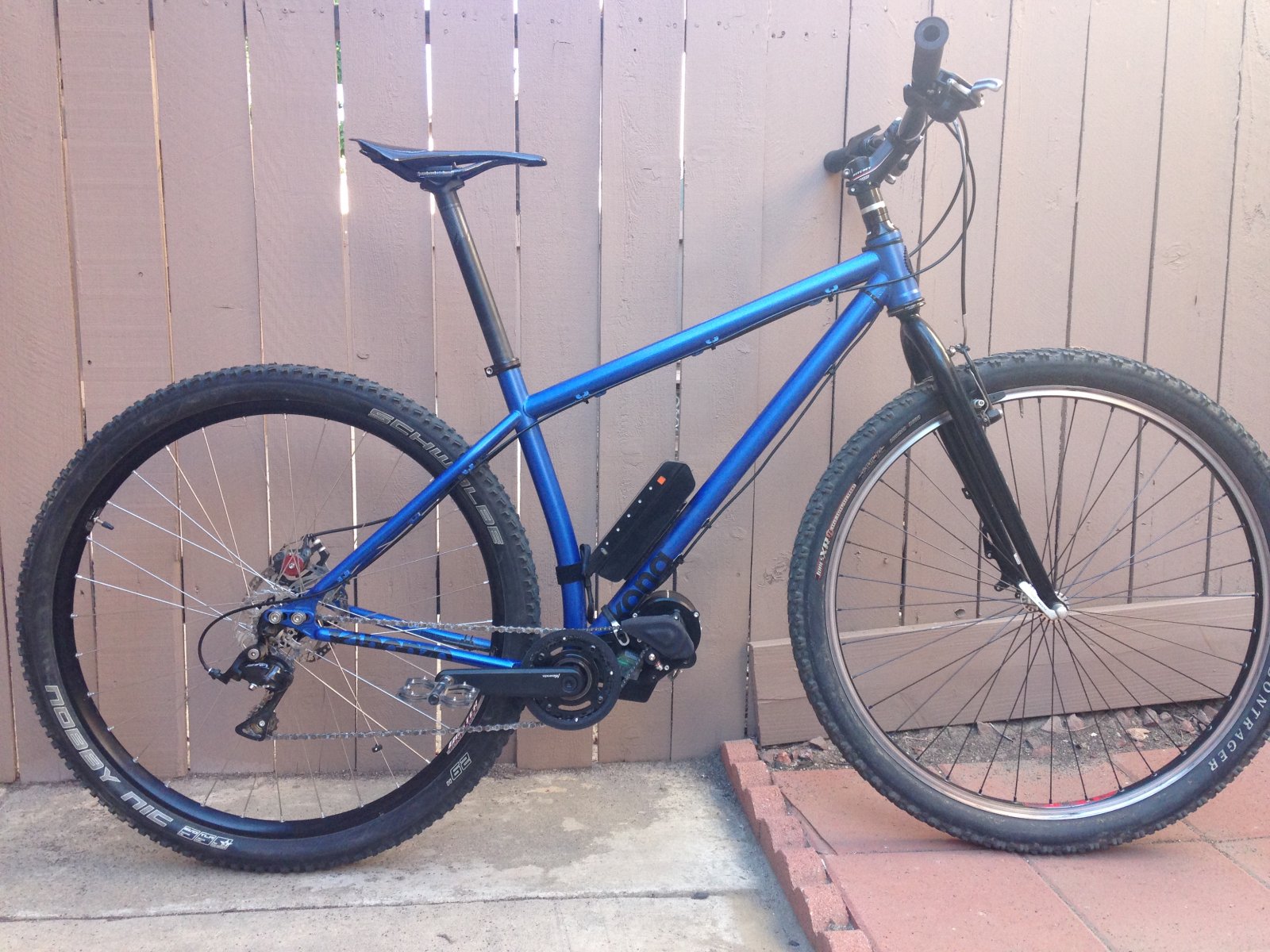

Completed the kit installation uneventfully on a Kona Honzo, and the bike plus Revel system weighed slightly less than 36 pounds. Bike handles well with the added weight in a low center position and the motor nestles against the down tube nicely. Power is comparable to Bosch and Yamaha that I've tested or owned. This thread doesn't seem to be of much interest. Is DIY taboo on this forum?
