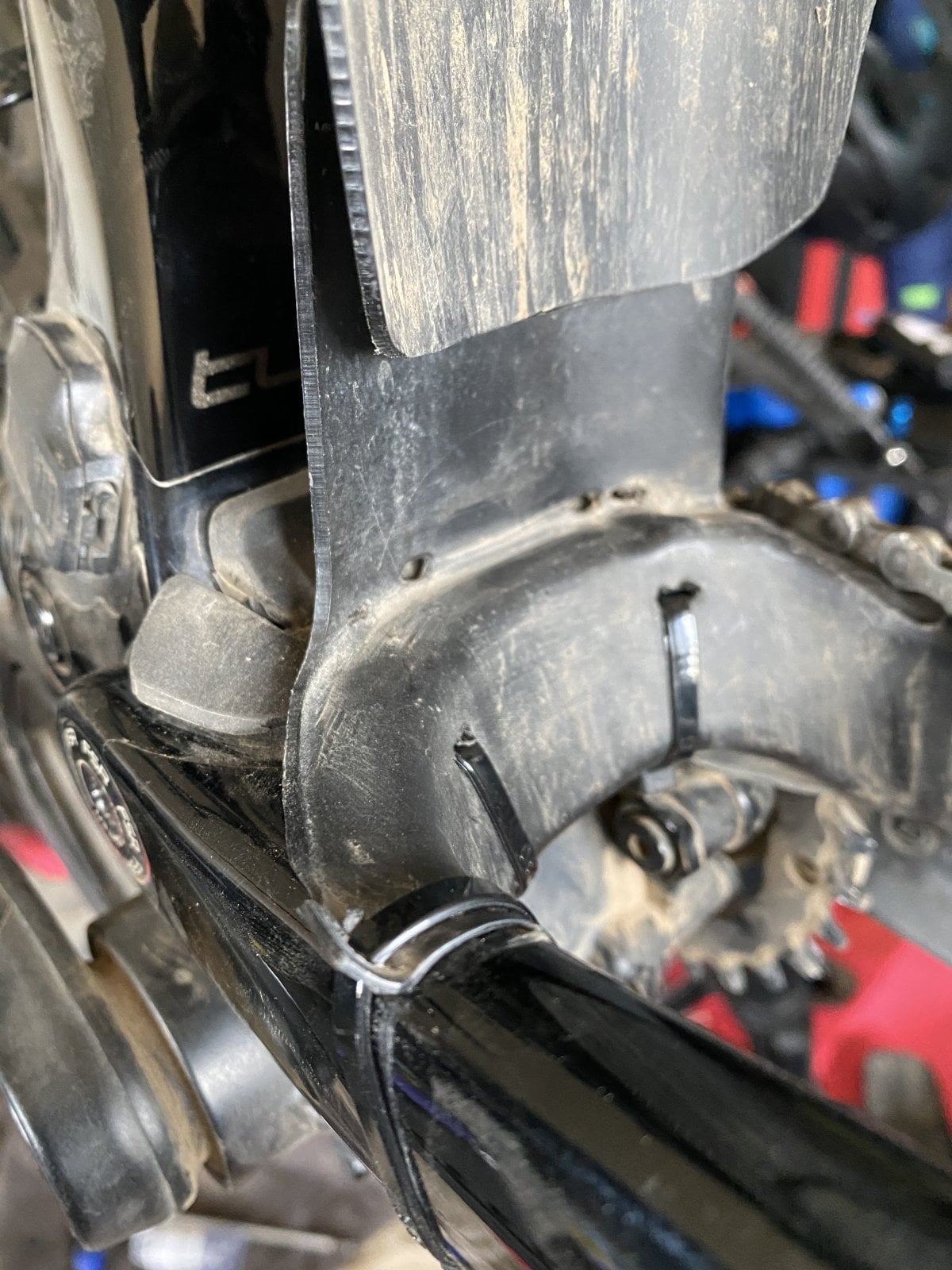

My solution which keeps the guard high
Mooncat
Aug 10, 2020
20
13
That's exactly what I was planning to do (it looks like you tried another couple of extra slots at the top too). I was convinced the slots as received were in the wrong place but didn't want to go poking a hot screw driver through it until I had other feedback. When you spend a small fortune on a two piece mudguard, you feel robbed when only one part fits properly.
Yeah it was a strange fit the bottom piece as Kenevo version was perfect. In any case, this was a solution for me.

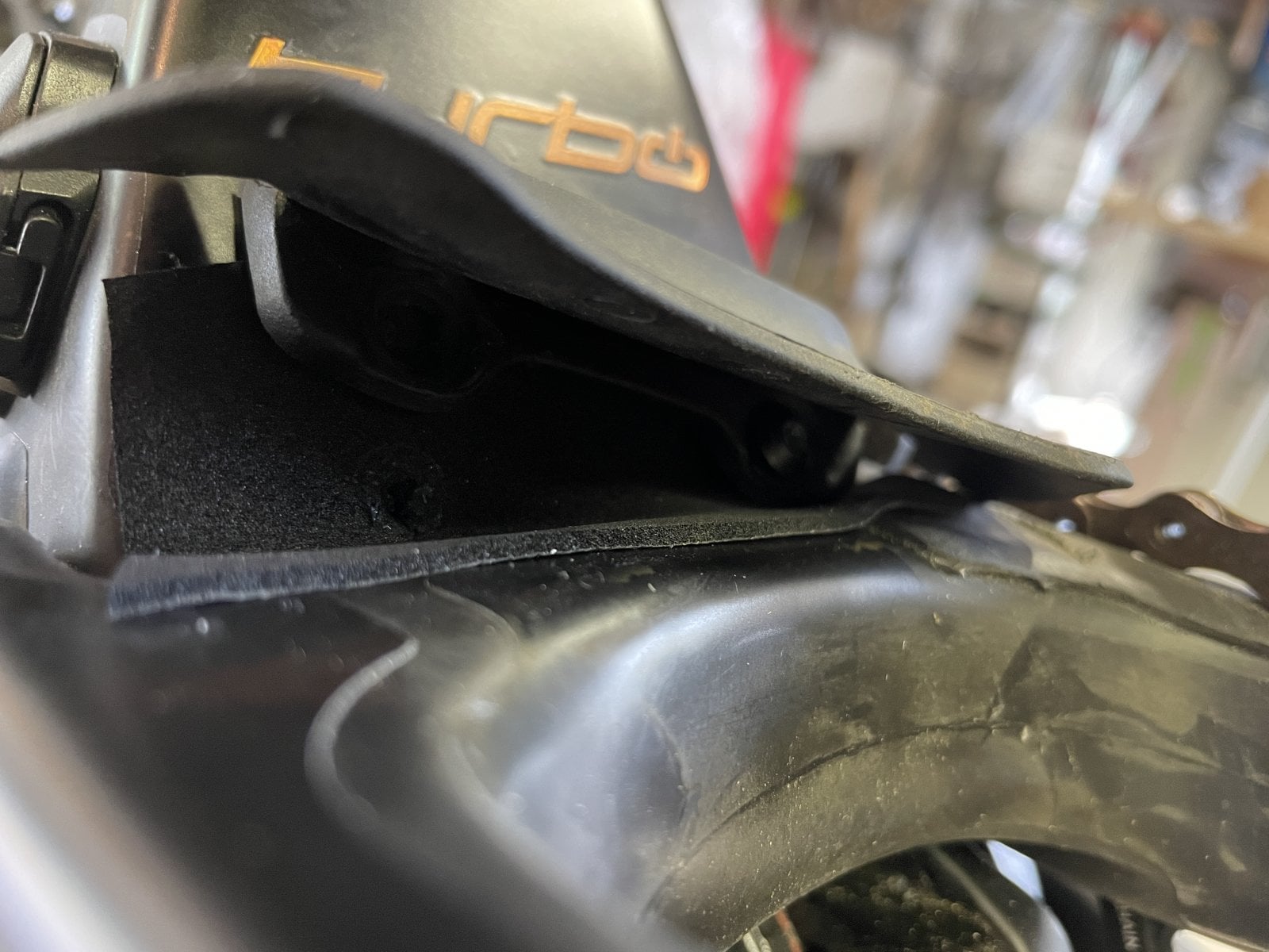

I taped the area under the rubber protector since it is open and has wires going to the motor with mastic tape. Then a 9$ amazon front fender to keep mud away from the linkage into which i added velcro straps.
