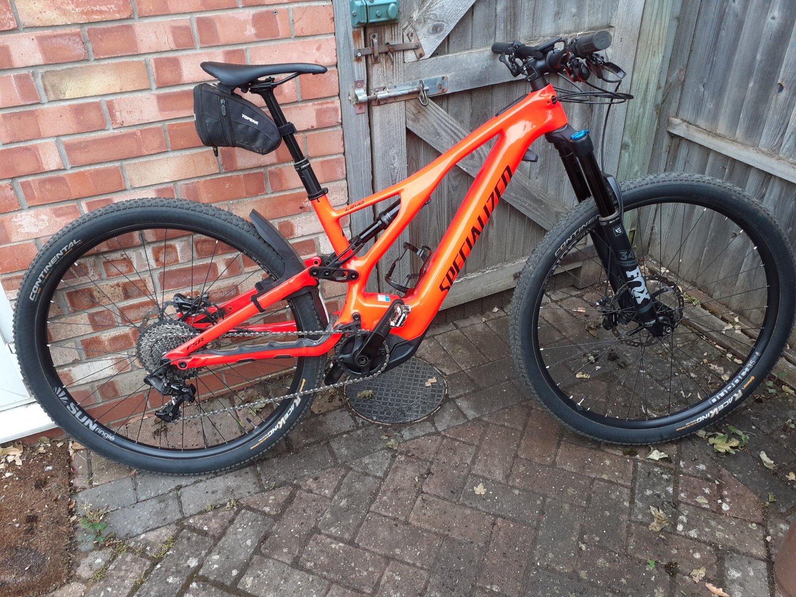

I ordered this and it has arrived, but doesn't fit
The screws that mount the bottle cage to the frame are too short to go through both the bottle cage and the pump
Where Can I get longer screws for this ?

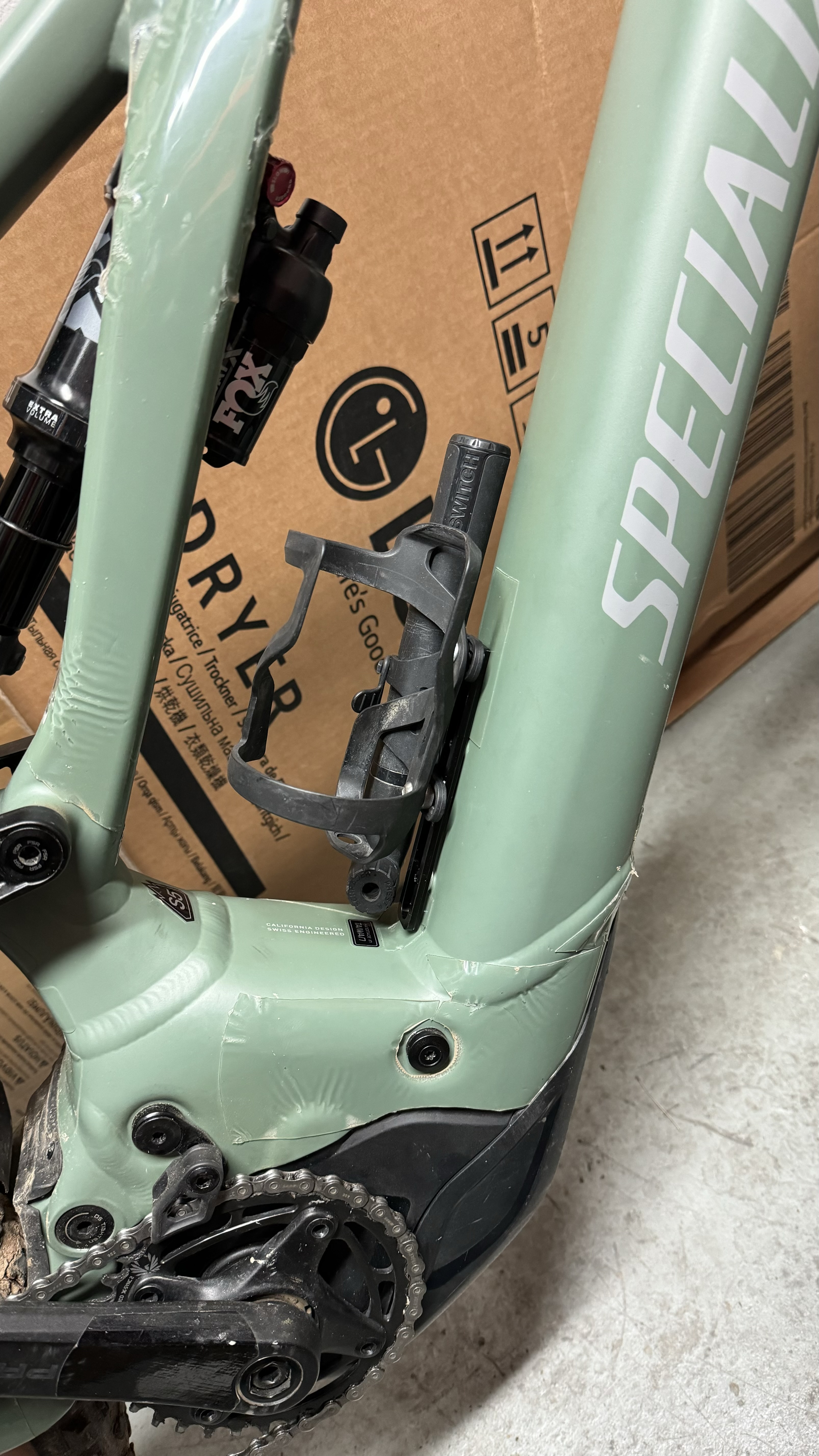

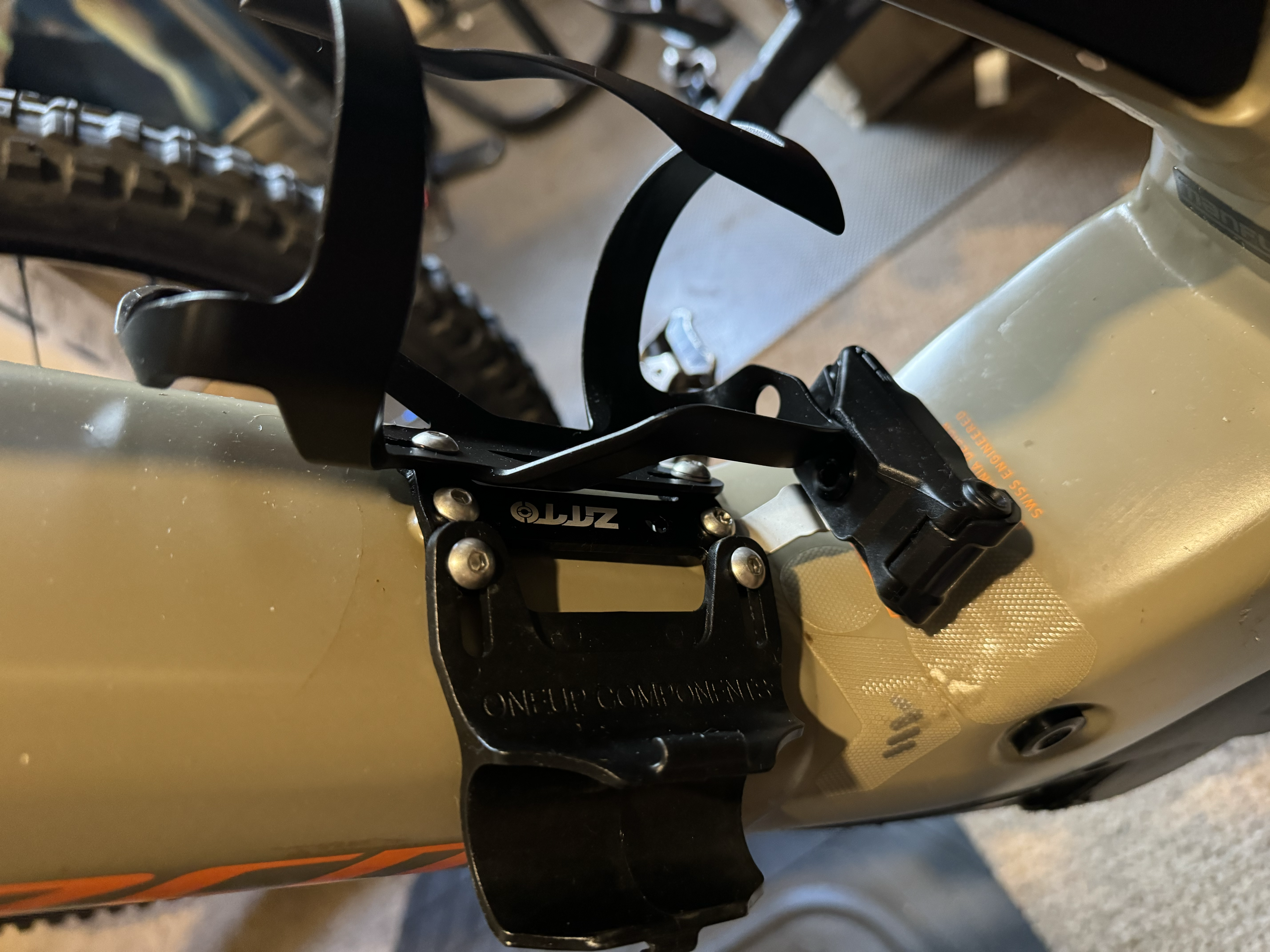

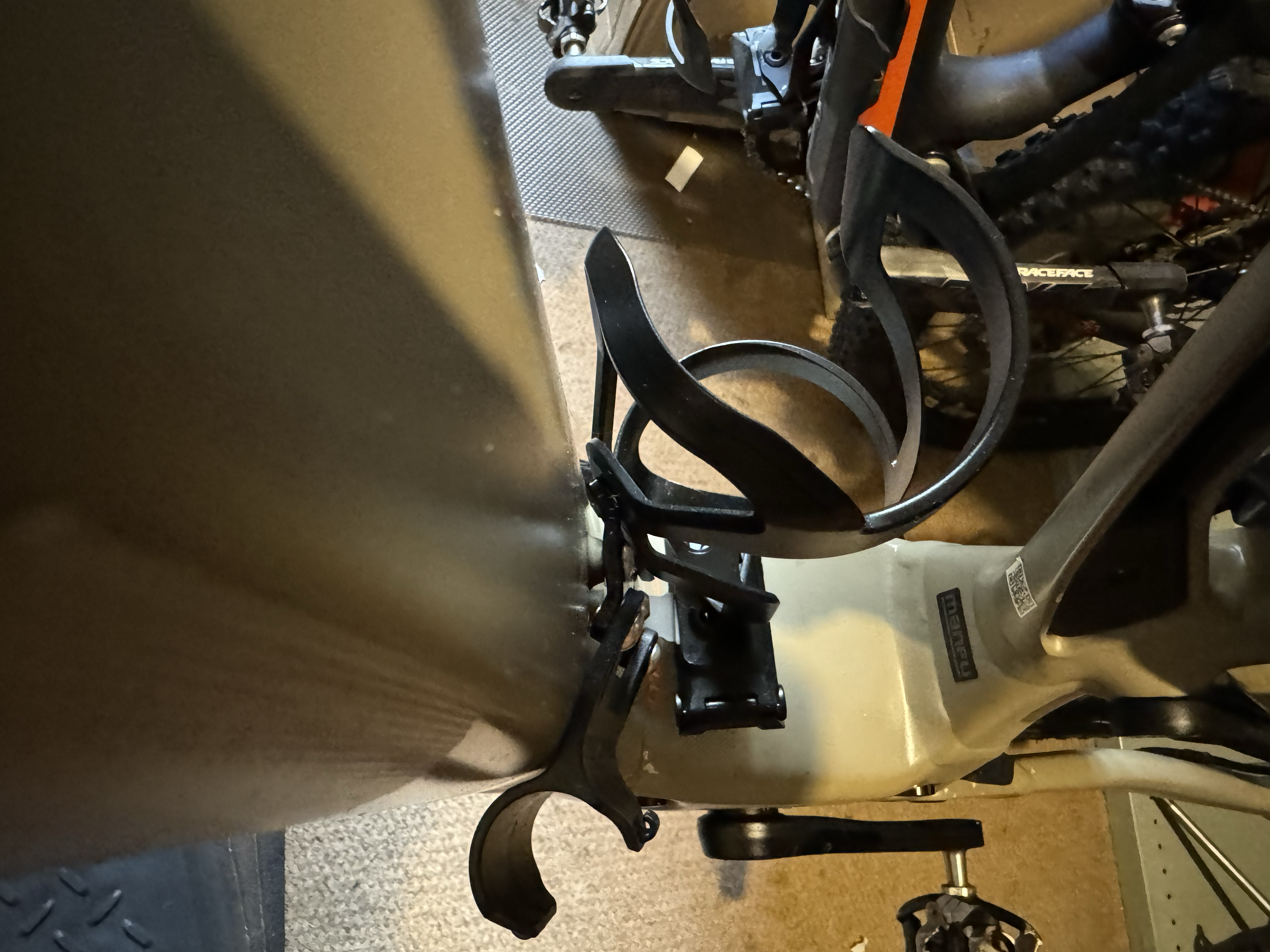

rikidc
Jun 5, 2023
9
9
Spain

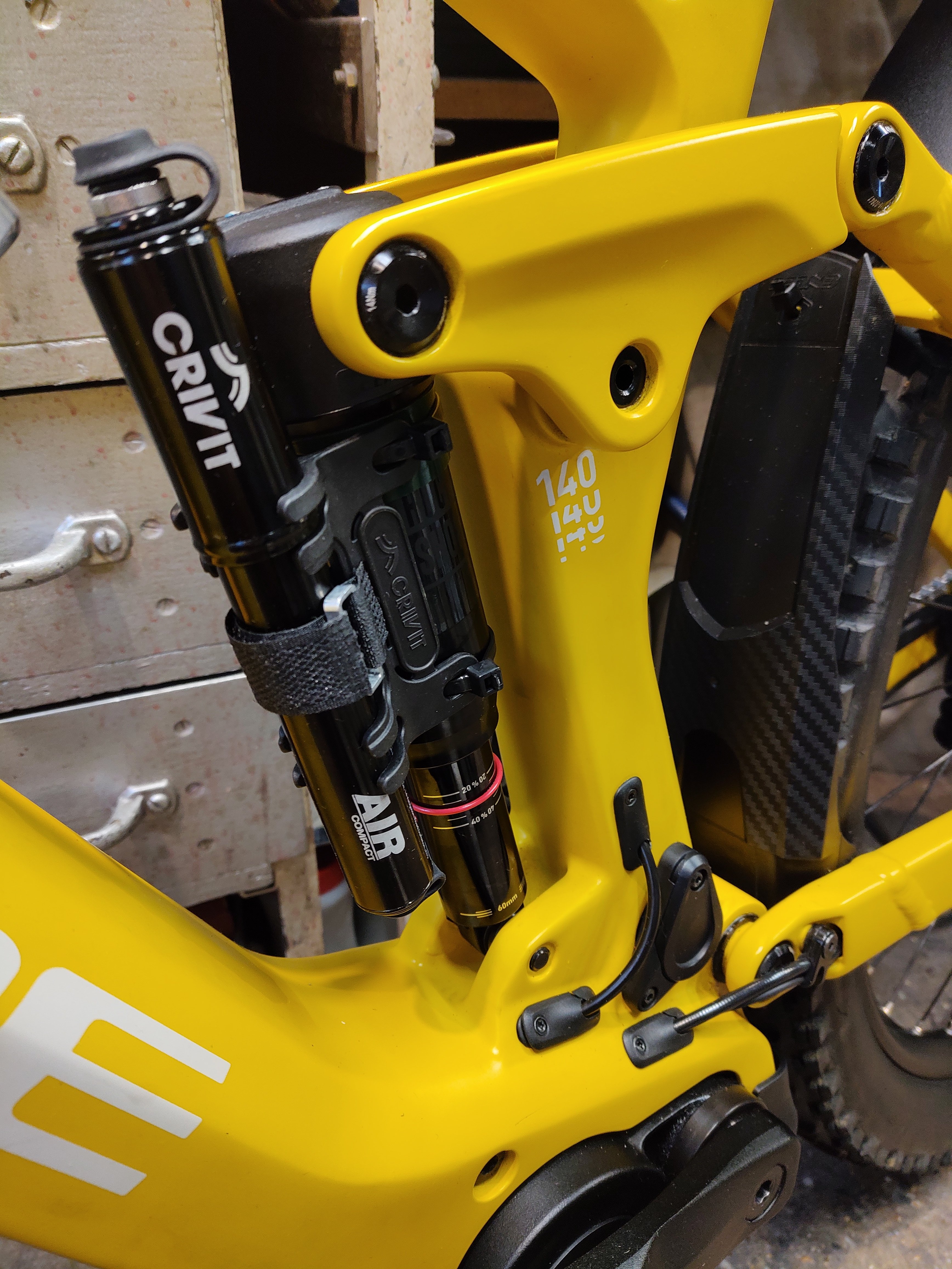

Hello I managed like this in Levo Gen 3
Using a Wolf Tooth B-RAD-2 to shift cage upwards and small washer in the bottom screw with frame to tilt a little bit forward
Using additional thicker washer on bottom screw between cage and B-RAD to create additional tilt to avoid collision of water bottle with shock reservoir
I can fit up to 950ml bottle with no issues in S5 size

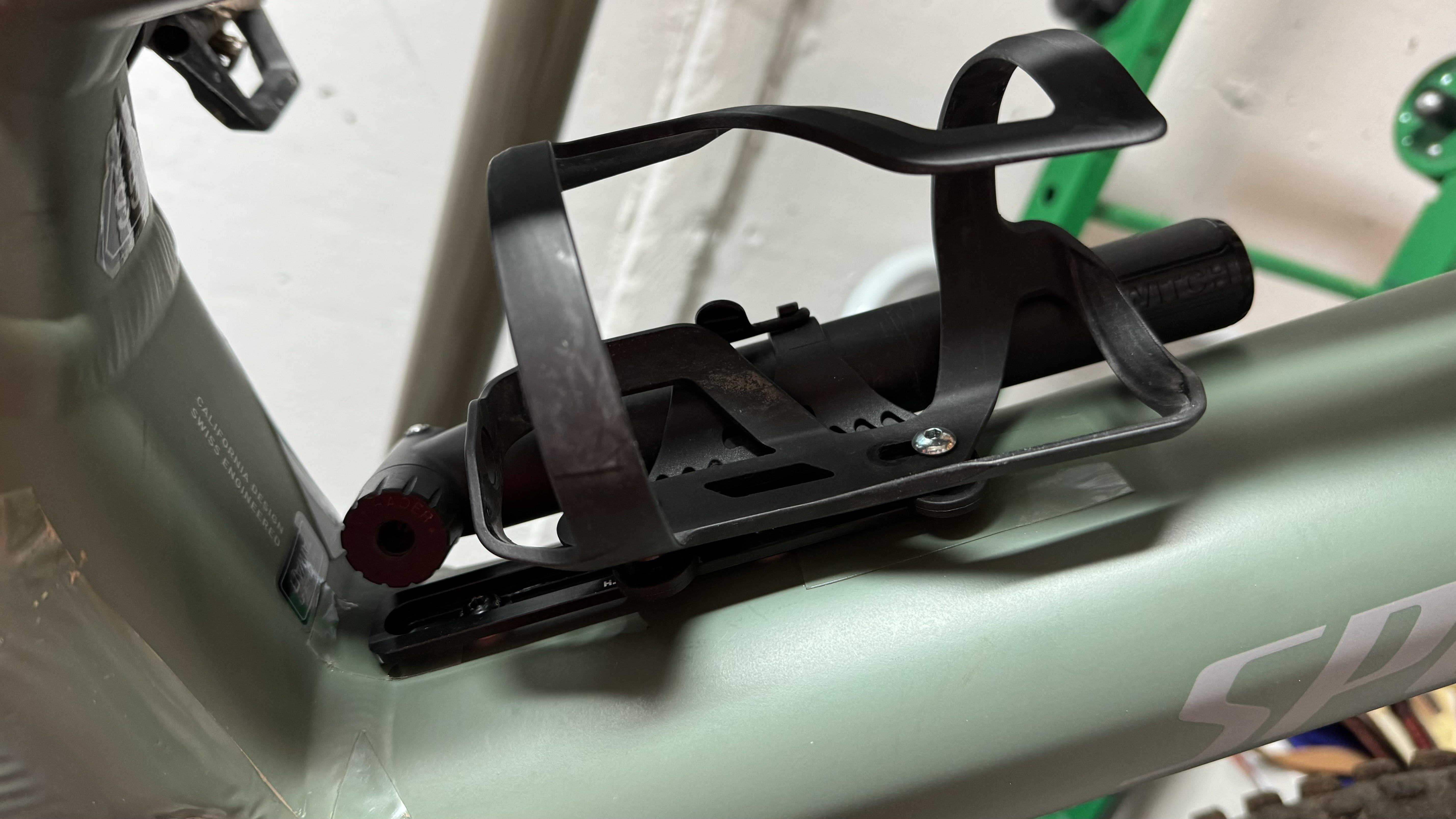

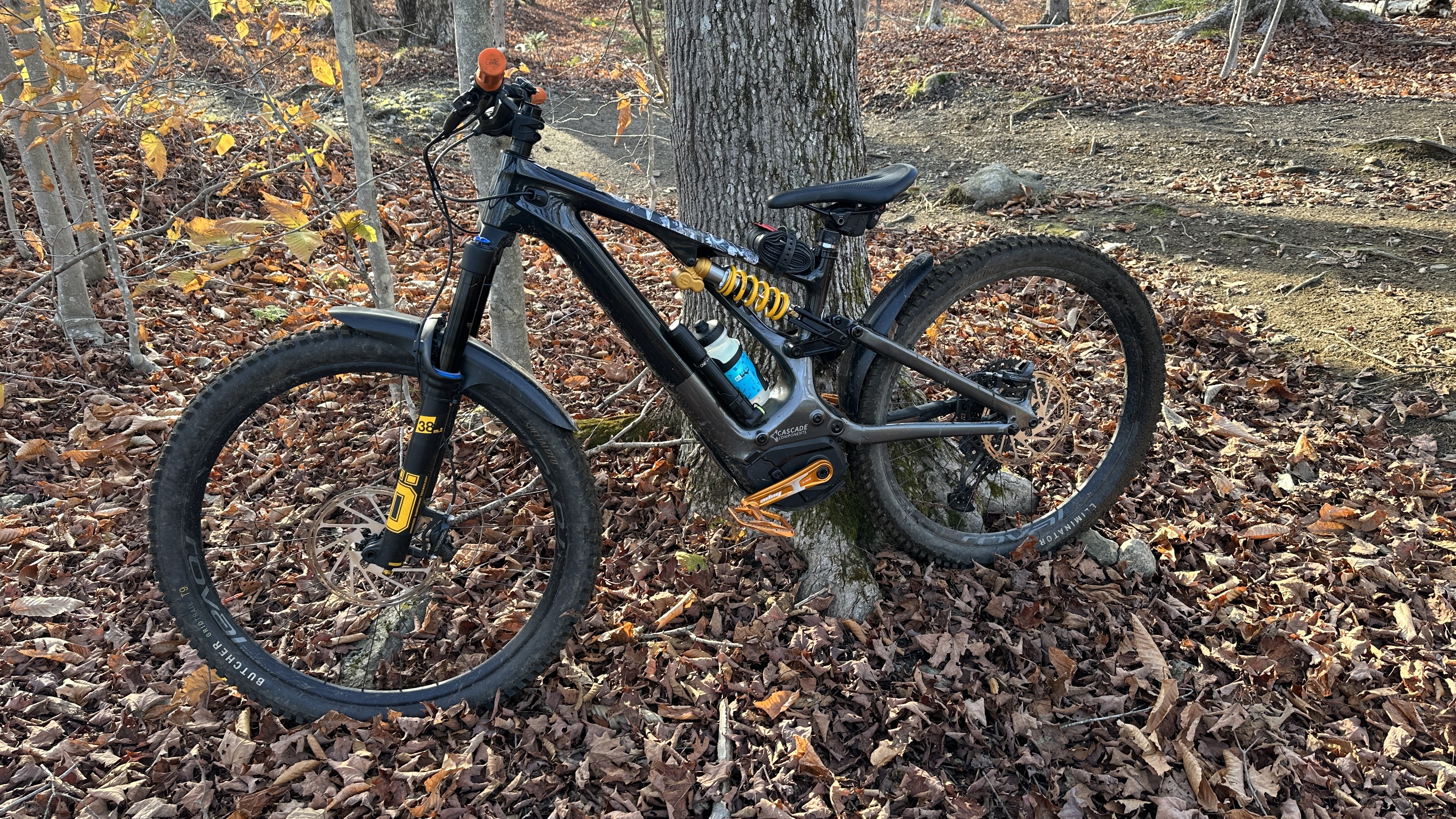

irie
May 2, 2022
2,521
2,533
Chichester, W.Sussex, UK
Drilled small holes in the water bottle holder frame to attach the Lezyne pump holder. When raised up as far as possible the bottom of the 600ml bottle just misses the top of the Ohlins shock.

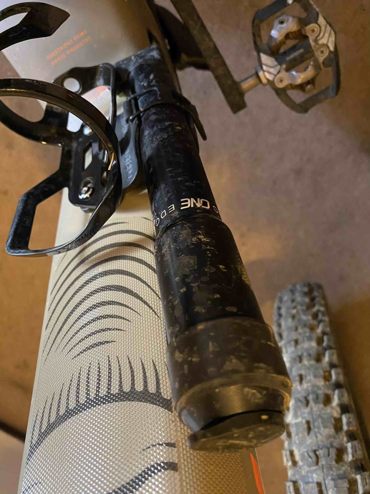

Christurbo
Jul 11, 2023
384
722
North Wales
This is what I did to ride backpack less:-
OneUp EDC tool in the steerer tube (has everything I need).
Lezyne pump stored in my lightweight Leatt base layer top (has roadie type pockets at the rear). Etc.
So no need to bolt on ugly pumps etc to the frame for the once in 3 year chance of getting a flat.

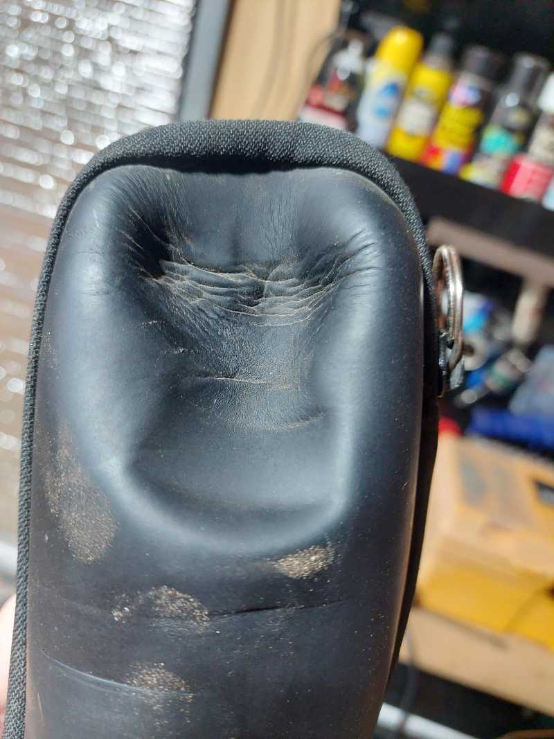

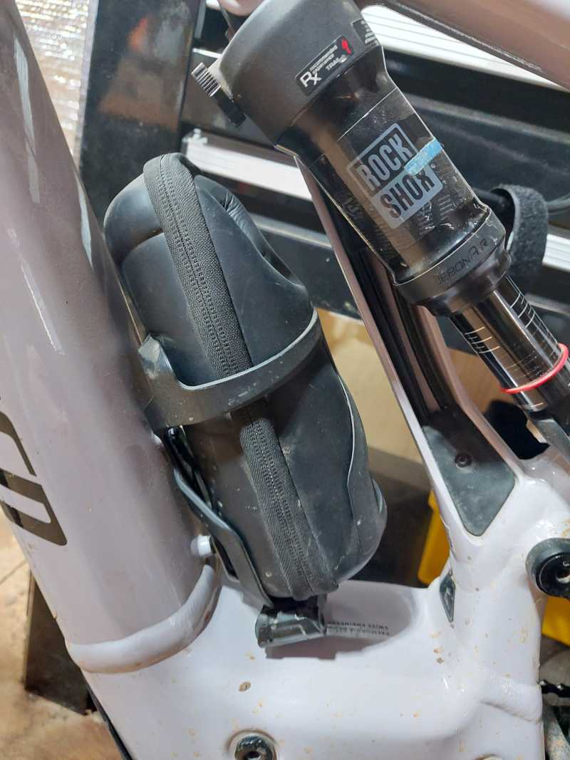

If you are eliminating a pack and still not using the bottle cage, this soft, weather resistant, zipper container from Amazon might work.
I carry a Lezyne mini-pump, tire tools, patches/plugs, and a multi-tool inside.
It can be formed to fit around the shock. This one is fitted for a Fox Factory Float X2 that has taken a brief vacation to the Service Center in North Carolina.
The zipper pull broke off early on and I replaced it with a key-ring.
I do still carry a hydration back or belt pack. But this prevents me from having to move tools from one to the other.
