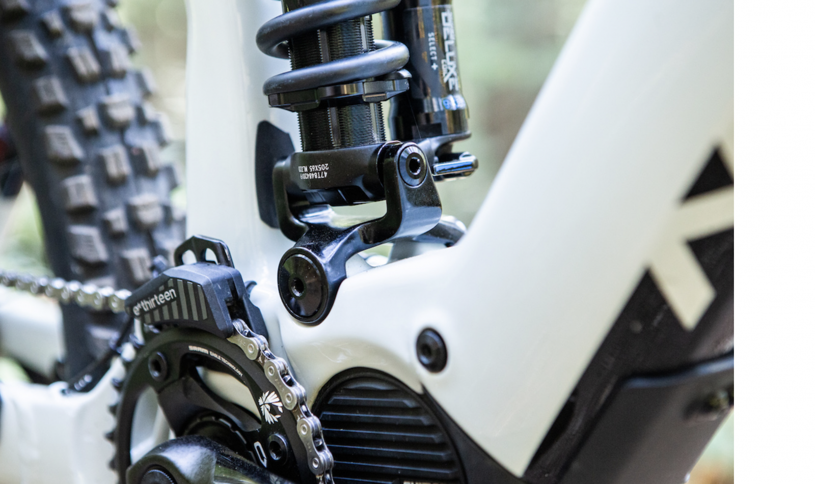

And the Norco Range VLT uses an E13 Chainguide, not sure if this would work, and if it needs a specific bracket - I know the OEM shimano chain guid bracket doesn't fit on the Norco's due to how the motor is mounted in the frame
E*Thirteen
looks to be using this direct mount but not sure

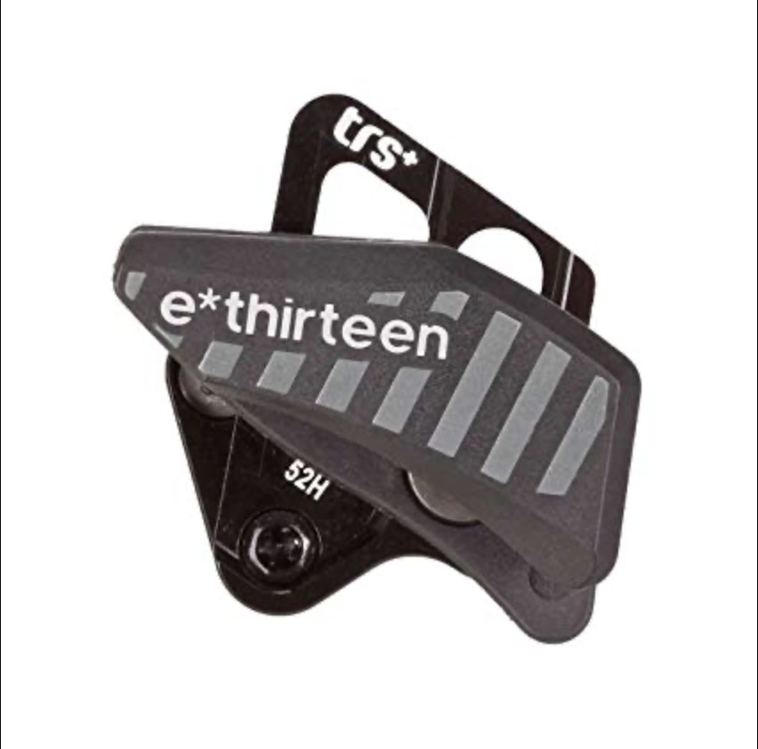

This is one of their products that should fit https://www.ethirteen.com/collections/all-chainguides/products/trs-2-bolt-chainguide?variant=29367286595687
E*Thirteen
Awesome thanks for the reply but unfortunately this doesn’t fit as well
