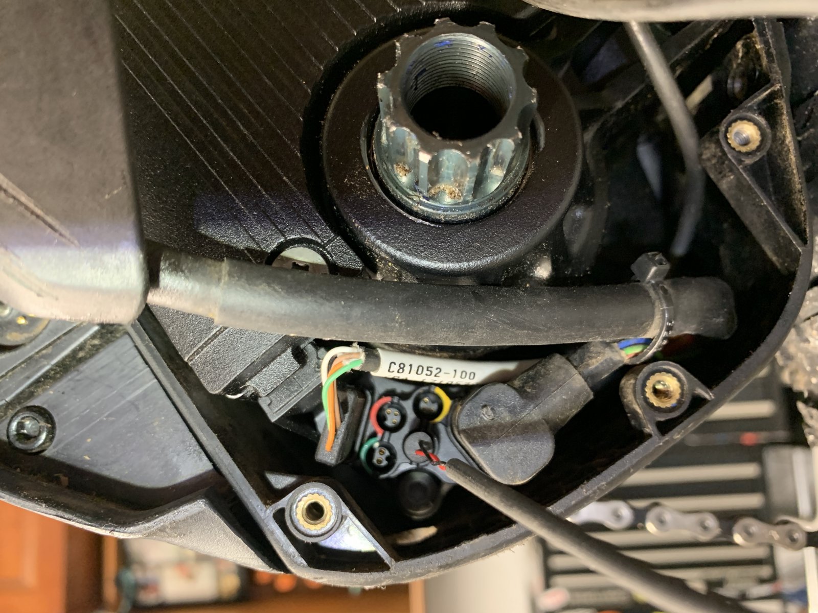

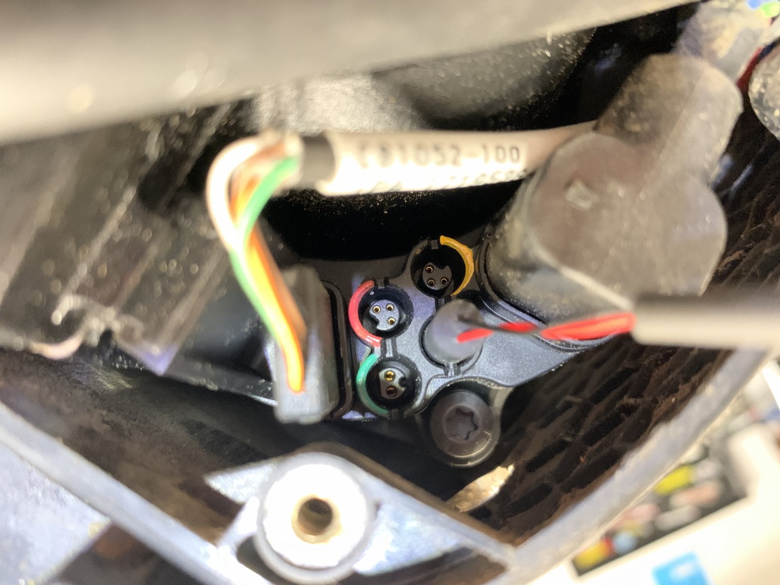

2019 Levo just back from LBS for motor replacement for belt slippage. Seemed to ride fine in park lot. Next day ride 20 meters and get speed sensor alarm (2 flashing red and blue bars) which mission control confirms. This has happened before and is usually fixed by turning motor off and on or cleaning my LSS magnet.
I put the stock magnet system back on, checked that the sensor wire was plugged in and intact but the bike still alarms and dies after 20 meters. Is it plugged in correctly?
Does the sensor wire have polarity?
Thanks, guys

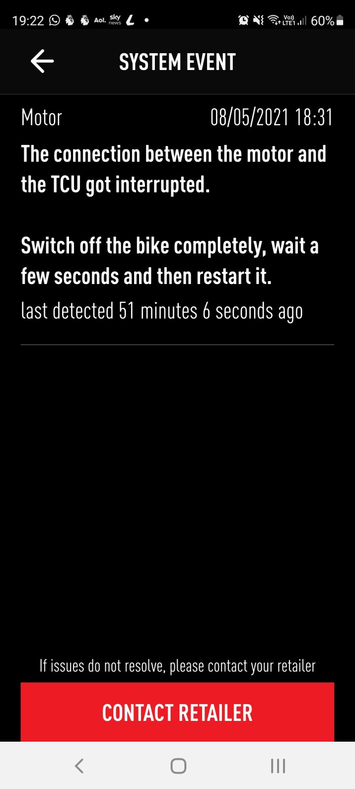

hi i have similar problem , just had my motor repaired/upgraded, still red blue light, so i bought and fitted a new sensor, still same error code , walk asist is working but still same error code, any ideas please
stevo66
Mar 20, 2021
19
st7
hi, i have replaced the sensor , the cable harness, i have had the motor repaired and upgraded,, today i fitted the new cable harness ,,and still have the blue and red light.. im all out of ideas now

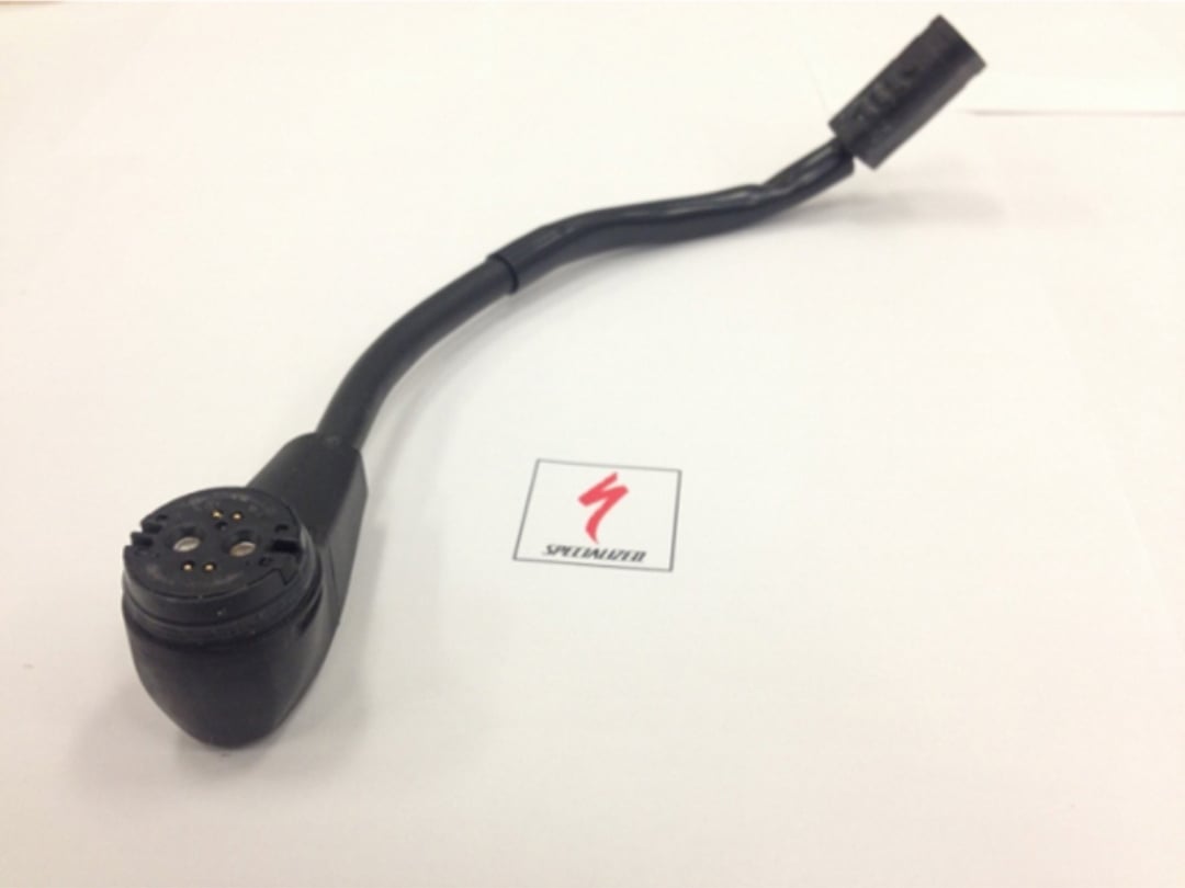

If that is your new motor the LBS also forgot to fit blanking plugs on the 3 other ports ( green/red/yellow). The least bit of damp in there and they will create a fault.

that is not the 2019 Levo battery to motor cable. The Levo version has a "d" shaped plug at the motor end.
i know, i got that 1 last week they replaced it and sent the new 1 today which i have fitted earlier today, after fitting a new sensor, and after having the motor repaired and upgraded, im still getting the red and blue light

Thanks to Mikerb--I'll plug those open green/red/yellow open ports
