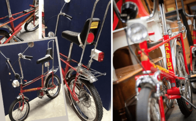

A very good mate of mine restores those Chopper bikes... they're worth a lot of money if restored correctly according to collectors. Below is a pic he sent me of his one - he orders 'new old original' parts from the UK specialist clubs and auction places. I believe he's working on a second one... authentic parts are getting harder to get.
Him and his son are both respectable DH racers... so I wouldn't exactly call him a 'nerd.'

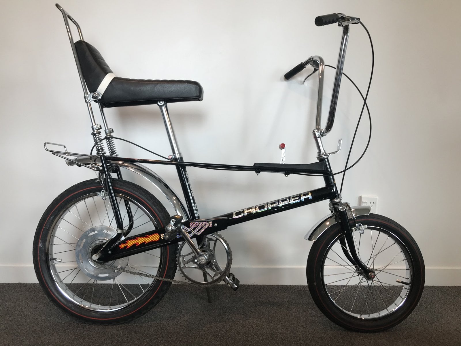

Just looking at it - yeah, poorly designed mechanically and so they broke easily. Handling was pretty bad too. Apparently they were banned at some point because they posed a serious hazard... not to mention that central T-shifter being a widow-maker! ?

The seat stay and the chain stay isn't triangulated... instead they form a trapezoid. So a heavy enough load pushing up against the rear axle just eventually folded the rear end.

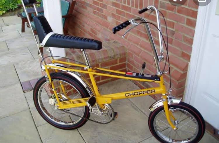

Mine was a chipper
The Choper's wee brother.
mine was red like this one.

I was actually typing about it when your post went in!
Besides the castrating effect of the T-bar shifter... the most common characteristic reported about it was speed wobble compounded by the fact that the small front wheel would trip-up the bike when going over pot holes.
I did a quick (ball park) evaluation below of the front end (head angle, fork off-set, in relation to the small wheel diameter) and as you can see - it has hardly any caster (sometimes called trail). The more the caster amount, the more stable a bike is at high speeds. There's hardly any caster on that bike which is why beside speed wobbles, it would also 'turn-in on you' if you did a no-hander, or if you hit a pot hole, or when @Monkey Dog ran over coke cans!
This is a common trait when bikes have really small wheels up front. Which is the reason why if you look closely at motor-scooters, the front forks often have a zero or even a reverse rake offset - which is the only way you can introduce a decent amount of caster (or trail) when small wheels are used.
The forward rake offset on the Chopper fork design actually created the caster instability problem. It would've been much better off (and safer) if the fork had no offset whatsoever as this would increase the caster. But hey, don't let good handling get in the way of cool styling! ? :)
