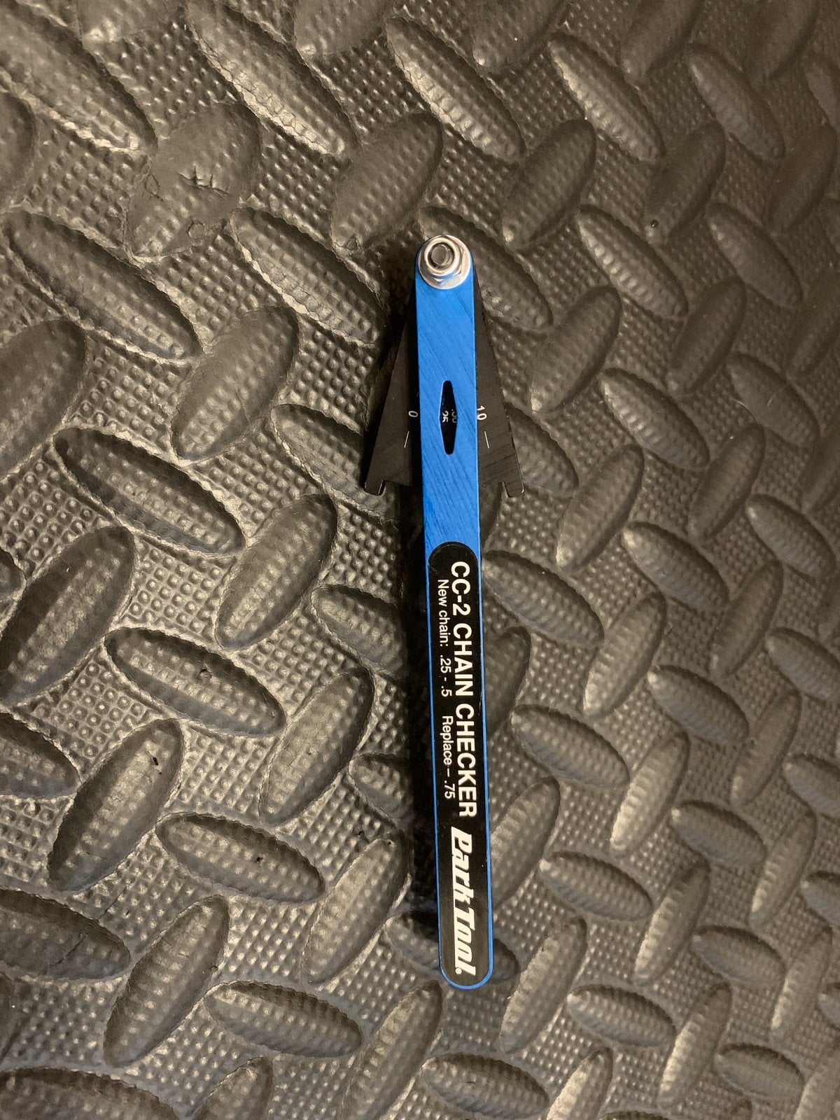

What chain wear checkers do you guys use?
I have a BBB chain tool but it only has a 0.75-1% indicator.
I've seen this one on AliExpress,
€ 0,68 28%OFF | Bike Current Meter Fiets Chain Checker Wear Indicator Meetinstrument Gauge Reparatie Checker Racefiets Accessoires
Seems almost identical to the Parktool one except the price being 8.5€ against allmost 40€ for the Parktool.
I use one of these
