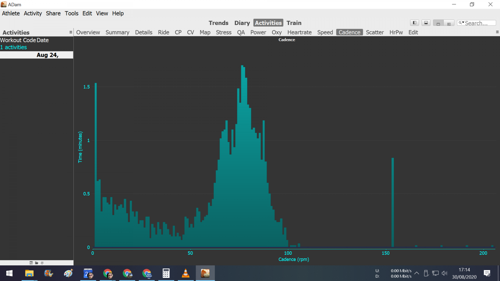

Wish list: ability to export ride and GPS data to a pc, then ability to see ride parameters corresponding to my location on the GPS map in a large monitor. Not all BLEvo data, just the basics like motor power, rider power, cadence, speed. My simple Garmin watch does this with Garmin Connect for my runs.

14,001
20,758
As Golden Cheetah is only desktop based, it would be nice to have some similar analysis available via Mission Control - even if it was via a web option where you could analyse your ride afterwards. I think we've already suggested some of this earlier on in the thread, but more basic.
Though in reality, how many of us would use these regularly enough to justify the development ??? :unsure:
For Instance (these are a Kenevo ride from last year analysed in Golden Cheetah) :
Monitoring the time you spend at certain speeds for example.
Or more importantly, Cadence motoring - when I had a low cadence issue from injury :
