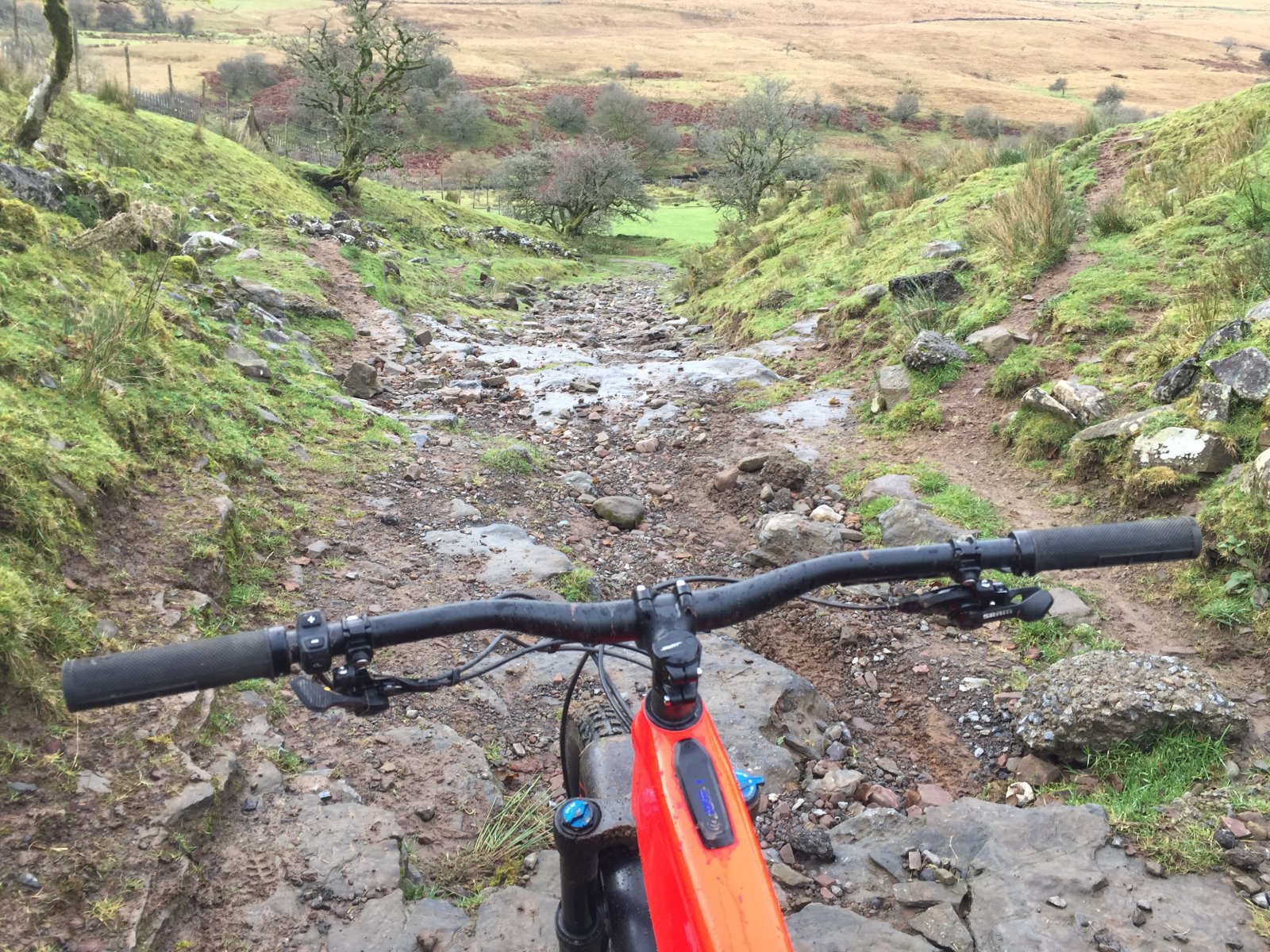

its mainly for rocky riding, like in the pictures, sharp and rounded rocks but lots of them.. im finding my michelin wild enduro a but crap in the dry..

Imna answer your qusetion...
But... I want you to think for yourself rather than take my advice or preference. (I'm not YOU and I ride NOTHING like you do)
In answer to your qusetion, Tyre tread choice doesn't actually matter hugely for rock chutes like that.
I'd happily ride down that confidently on pretty much any tyres.
Looking ahead, choosing a good line, staying loose, off the brakes and committed is all that's required. and speed/momentum is your friend
now it'syour turn...
Ask yourself "why" you've chosen two different tyre tread paterns?and more importantly "what" you're thinking it's going to achieve?
BOTH the tyres you're thinking of buying are a good choice upfront or on the rear for riding that, But one of them does not give anywhere near the braking performance of the other.
Now which one were you thinking of running up front and which one rear? and Why?.
Enjoy your homework ;)

Well I rode those rocks with the standard butcher tyres and ripped a knob off the rear. The sidewalks on them are awful. I’m just looking for something that can do that stuff for the summer so...
I guess if I wanted balanced braking, I would just fit dhf front and rear or the dhr2 front and rear might be better. I was planning to fit the assegai to the rear just in case I really like em and kept them on for winter, looks a better mud tyre, but I don’t know that, just looks it.

I used to ride a mx bike down those lanes, the first pic above is called boulder hill and I didn’t care what tyres I had on, as long as the pressure was right I would send it up and down there no problem, as you say, momentum.
