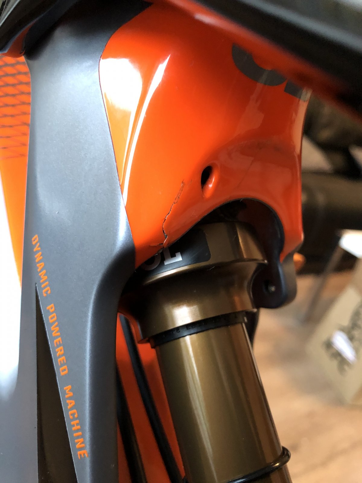

i have had alot issues with this bike, i would like to share to benefit others
Rideaway
Mar 10, 2021
20
Nelson
8 months ownership
2 cracks in the carbon frame both around the same place - bottom of seat tube
1 paint flake, exposing the carbon just beneath seat clamp
1 failed bottom bracket angular gearbox
1 failed motor

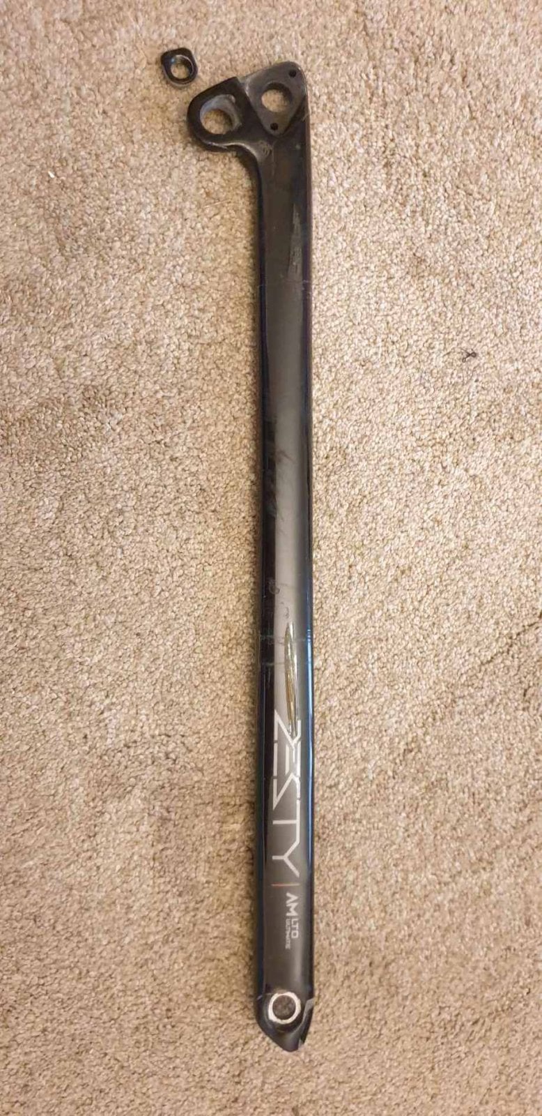

I noticed very little rear triangle stiffness, there was alot of side to side flex on all three frames. Mates when riding behind me would notice the rear end swinging.
This always caused the fixings to work loose.
The carbon surrounding the bushing on the rear triangle arm worn away due to this, the carbon frame arm had to be replaced and the bushings that fit into it.
