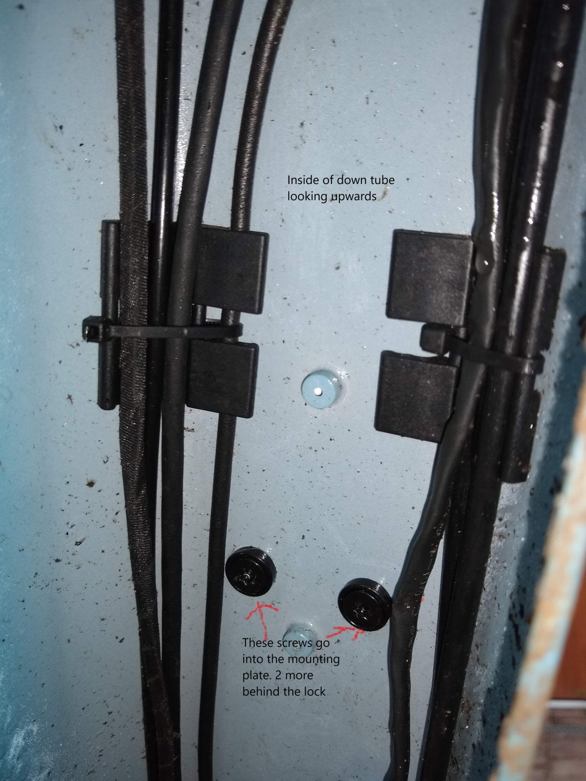

- check how the scott specific plate fits to your frame. you will need to remove the primary battery, and the lock , from the frame. in the frame you will find two rubber covers - one in the middle of the down tube, one behind the lock. take these covers off, there are then pre-machined holes, which will line up with threaded holes on the plate. thats how you bolt the plate to the bike - but don't bolt it on till next step.

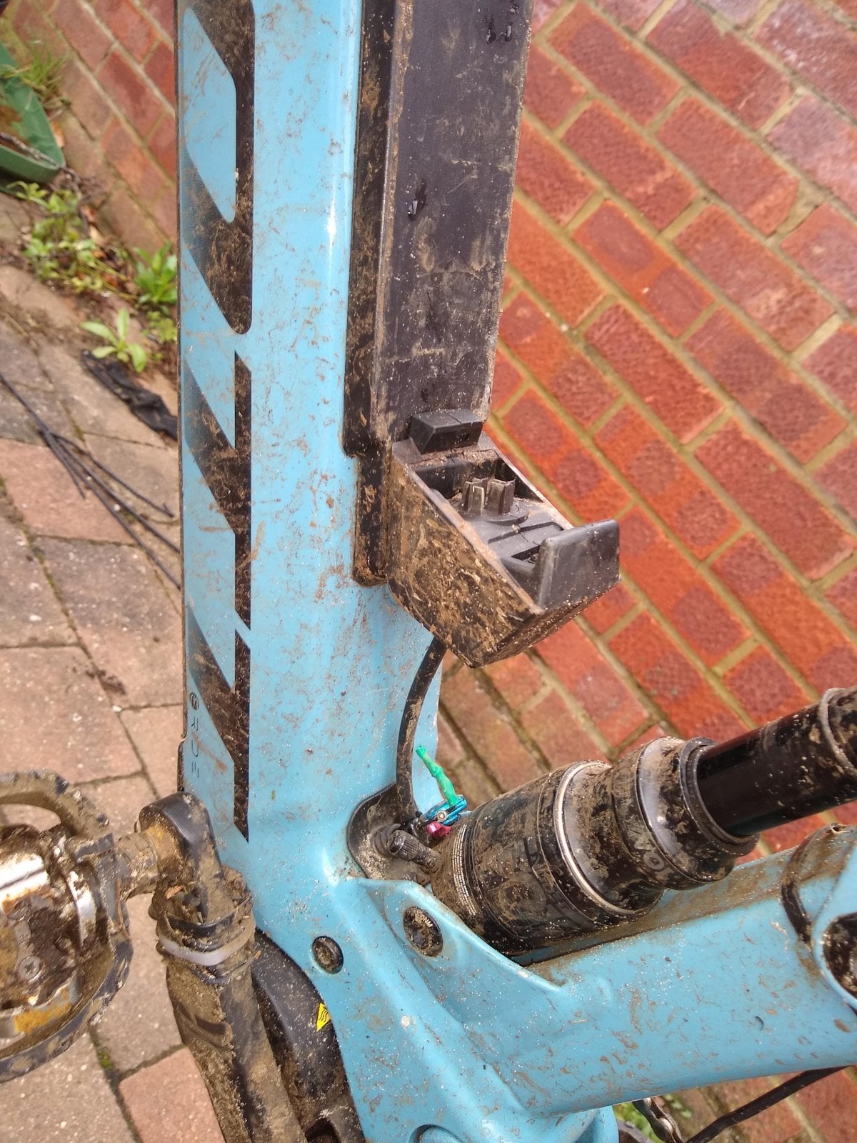

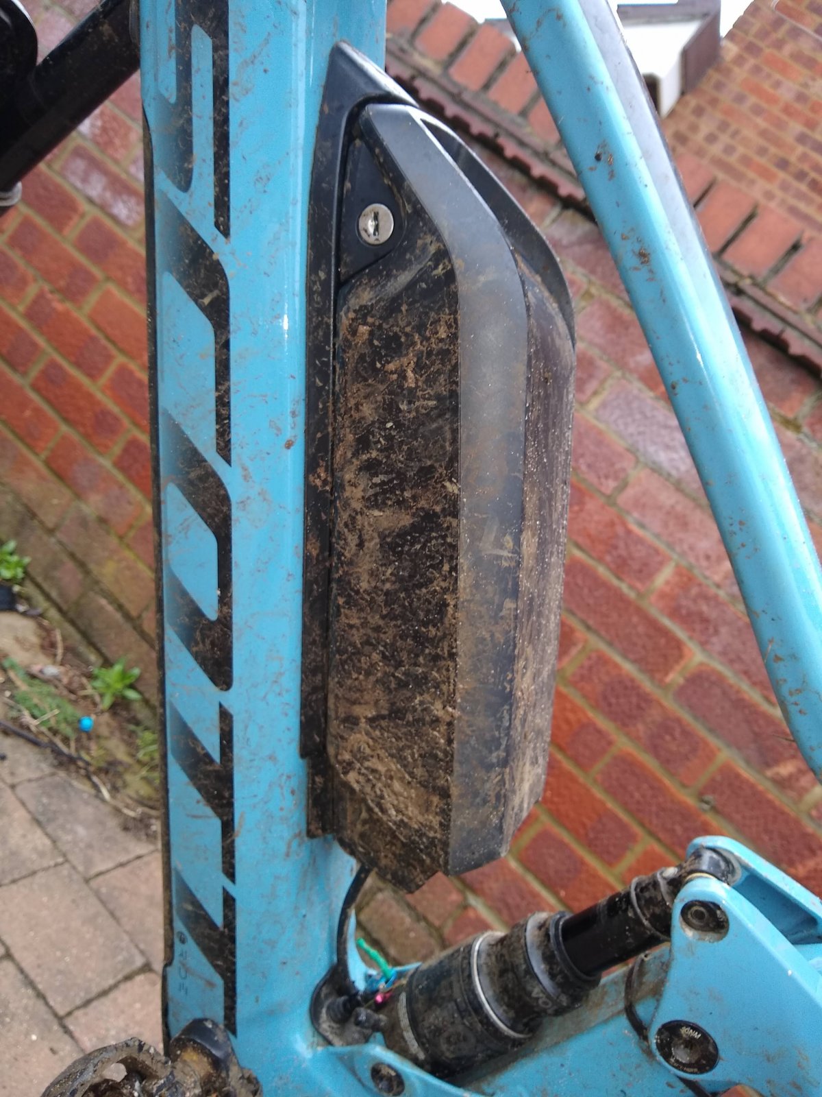

- fit the bosch parts that hold the 2nd battery in place, to the scott plate. battery should then be able to to be clicked /locked on and off the plate.
- bolt the plate to the bike. mechanically the bike is now able to carry the 2nd battery.

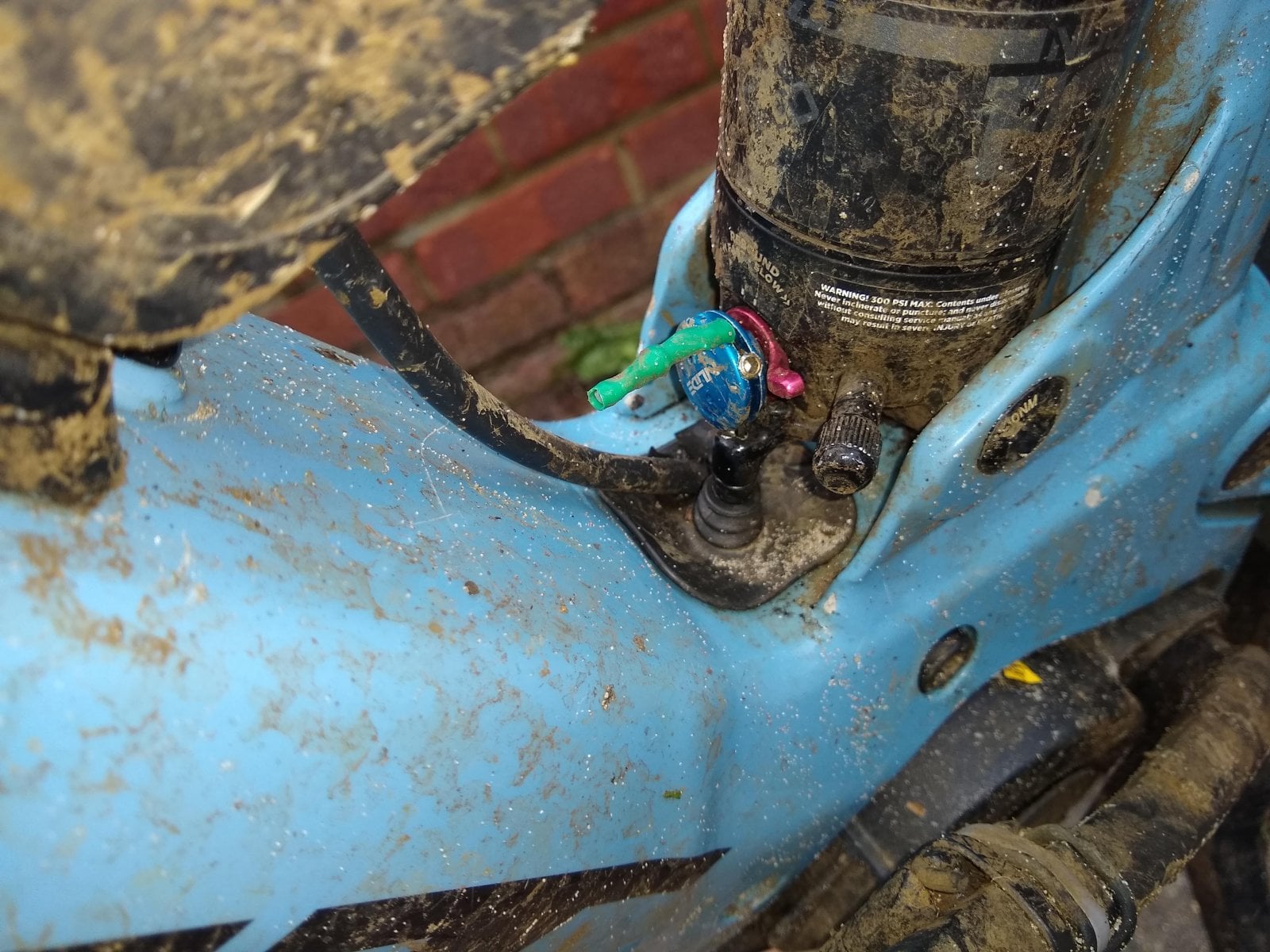

- cut a slit in the rubber cover underneath the shock that has the lockout cable. run the other leg of the Y through this hole to the bottom of the secondary battery, and refit the rubber cover. This is the most fiddly bit of the whole thing. then you have a Y cable joining the outputs of both batteries to the motor input.
- stow the slack on the Y cable up into the base of the seat tube. careful not to foul the dropper cable. this is the 2nd most fiddly bit.

here's some pictures
