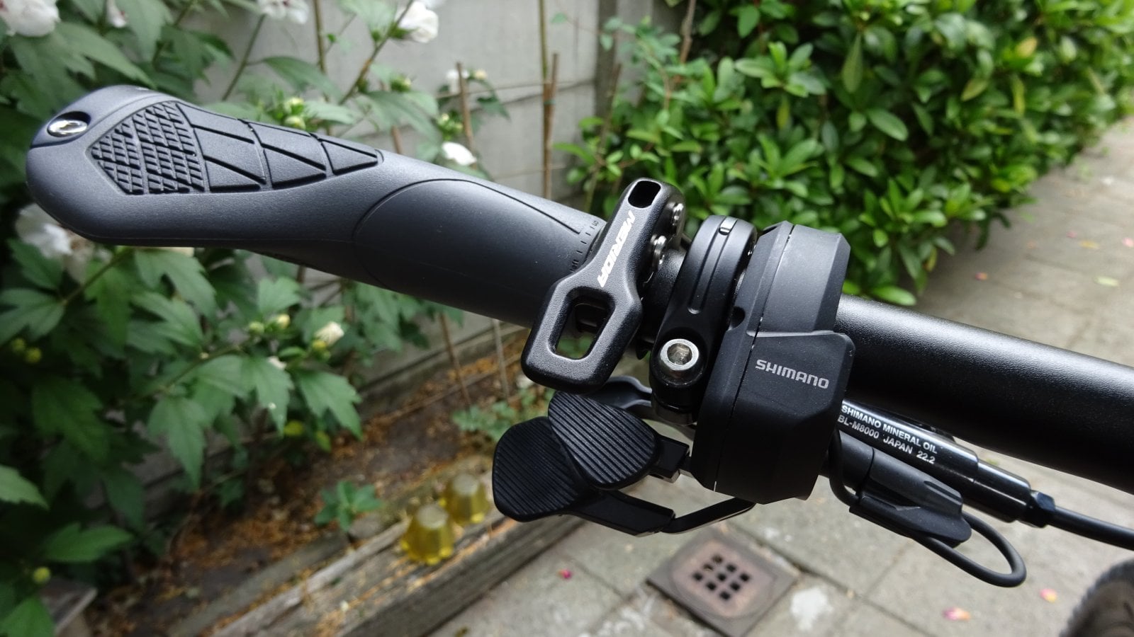

I just bought and installed the 7000 switch with the 400mm cable.
If you have a Merida (like I do) with routing of the electric wire through the handlebar this is too short :(
The cable goes to the left under the grip where the hole in the bar is, so you'll need the 700mm version if you want to keep the internal routing. Since the exit hole is in the middle of the bar it's no use to move the display to the left of the stem.
Apart from this issue it's plug and play.
I'm thinking if I'm going to buy the 700mm version or if I leave it as it is now...
I went from this:
To this:

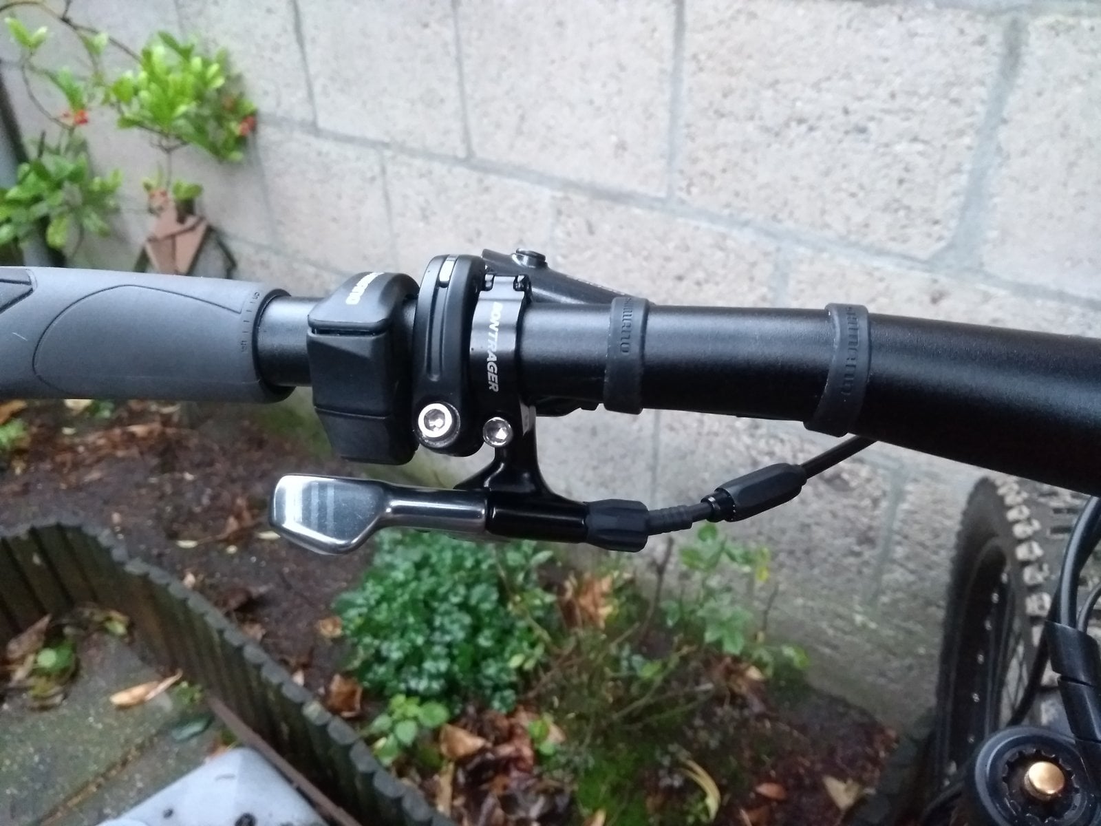

I also switched dropper post from 120mm Merida to 150mm OneUp. This needs a lever with cable clamp option (this one is a Bontrager) and I needed a bit more outer cable length, hence the extra adjuster. Saved me removing the motor to work on the internal dropper cable :)

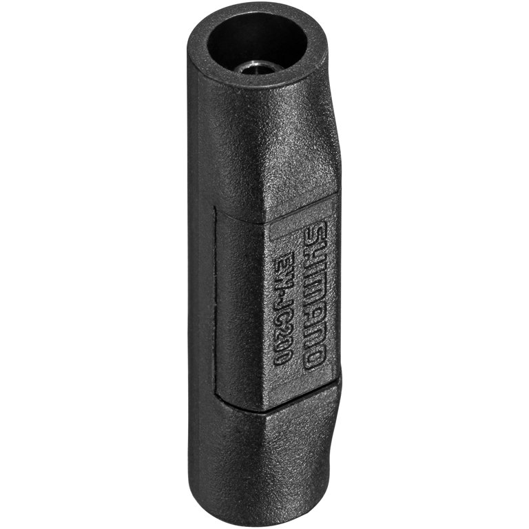

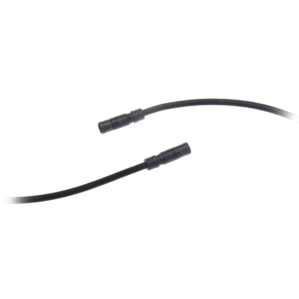

Another option to create a longer cable is to use a EW-JC200 Junction and a EW-SD50 Cable (different lengths) to extend your current one. You could probably hide the junction inside the handlebar?
https://www.bike24.com/1.php?content=8;product=224163;menu=1000,4,139;page=2
https://www.bike24.com/1.php?content=8;product=24697;menu=1000,4,139;page=3

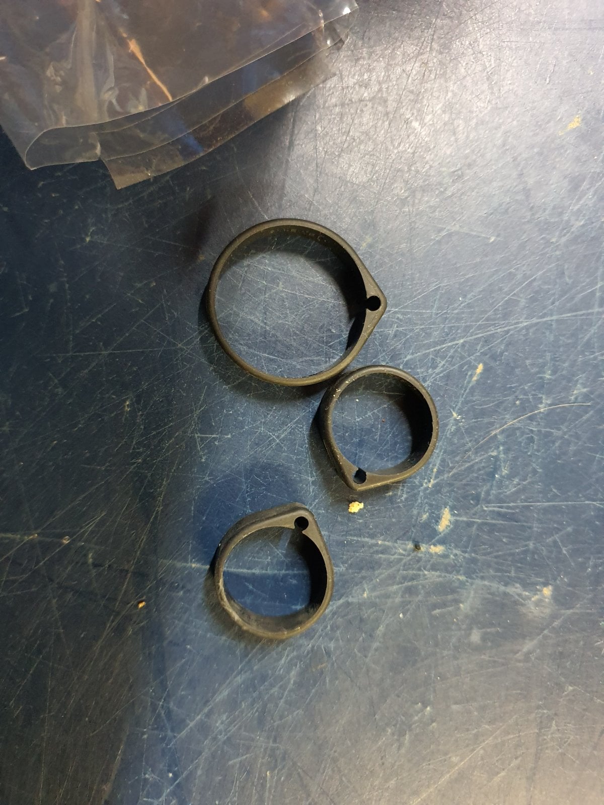

Finally installed mine today. Just waiting on my replacement dropper lever, then it's Good bye over bar lever. Didn't realise just how small the switch is.
Anyway did anyone have to use these? I tried to use one of the rubber rings but the unit wouldn't slide into my bars so I just put the switch straight on. Have I missed something here?

Oh shit wait a sec are they meant to hold the cable in place instead of zip ties? Just had a light bulb moment
