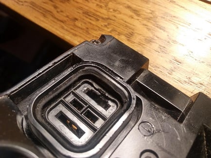

I got my Vitus Esommet VR back in January 2019. Bike I agree handles great but I have had a view issues and Wiggle has been particularly shit poor with customer service:
  • Chipped connection port on underside of battery from new which Wiggle said was normal (bullshit) pic attached. I wanted a new battery, Wiggle said no, Madison said it was a retailer issue...duh!!!
  • Had a bad rear derailleur (replaced under warranty)
  • Found out that the inside of frame had very sharp edges and both rear brake and derailleur cable housings got shredded (replaced by me)
  • Headset and some linkage bearings needed replaced after only 3 months (replaced by me)
Contacted Vitus several times about torque settings and some other things, also if I could be supplied with a new frame at my cost and were about as helpful and useful as paper socks and still waiting on a reply after months.

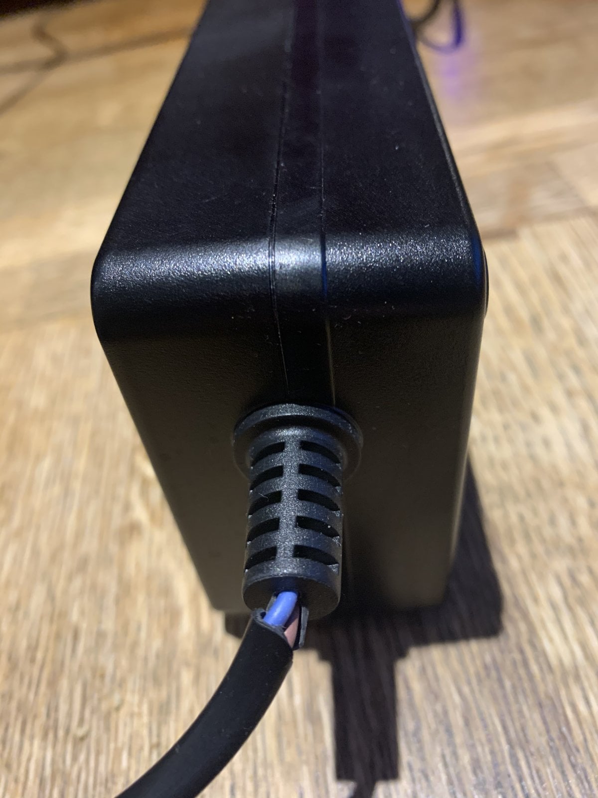

My first issue and unfortunately CRC have been useless. The cable on my charger looks to me like it’s had a material failure and the plastic coating has work hardened and split. It hasn’t been misused and my laptop cable which gets a whole bunch of wear shows no such sign of any wear.
CRC response - nothing to do with them as it’s been pulled out (which it hasn’t the wires underneath haven’t moved, the outer sheath has failed).
Will see where I get in next few days. Not very impressed.
If you were unable to get this replaced you could repair it with self-amalgamating tape.
If you are not aware of this stuff you stretch and wrap a piece tightly around the break and a couple of inches either side of it (like applying a bandage).
After a couple of days this welds itself together to form a fairly solid repair, which should last for years.
You can buy it at some electrical shops and Amazon.
