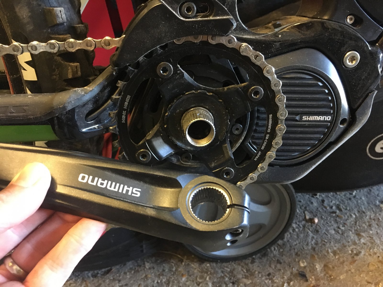

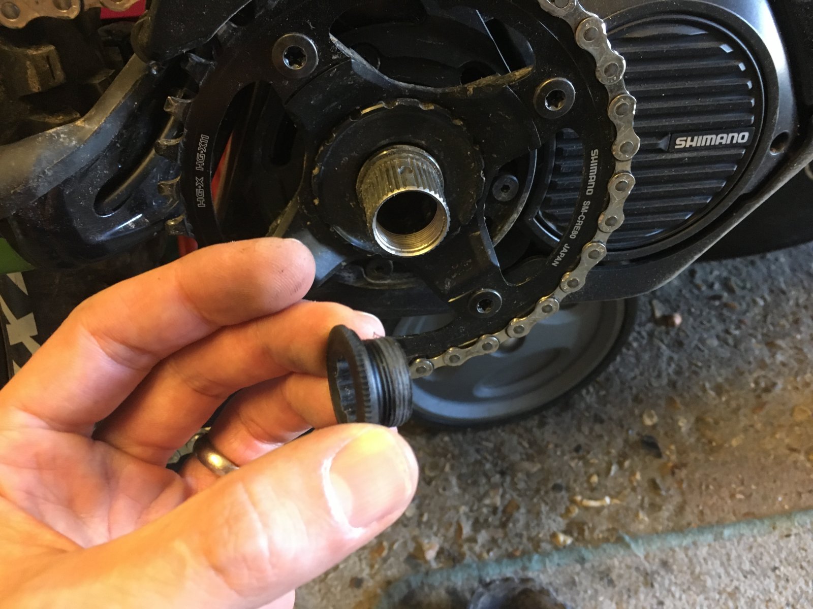

Good ride this morning until this happened..crank arm dropped off!!Allen key bolts are still tight but it’s somehow forced itself off the spline & stripped threads off the plastic end cap.. can anyone advise??

That happened to me once on a clockwork bike, but it was because the clamp bolts were not tight enough. None of the splines look damaged in the pic, so you were lucky!! Clean everything up, degrease the bolts and the threads they screw into as best you can. Then use threadlock on the ends of the bolts and fasten the bolts in stages alternating from one to the other to avoid distortion.. Use a torque wrench to tighten to the correct level.

Replace the stupid plastic shimano preload cap with an Alu version and it won't happen again.
The plastic caps allow the arms to "walk" off the splines. Even when the pinch bolts are correctly torqued.

That plastic shim has a tiny pin on it and it is designed to engage into the hole in the crank arm mounting shaft (you can see that hole in the picture above). It is to prevent the crank arm from falling off but sadly this doesn't always work. It is not designed to prevent over torquing of the crank arm pinch bolts, when torqued correctly this plastic safety shim is still slightly loose.
Shimano crank retainer/safety pin thingies | Singletrack Magazine
Crank arm pinch bolts should be torqued to 14Nm and torqued alternatively a bit at a time until the correct torque is achieved on both bolts.

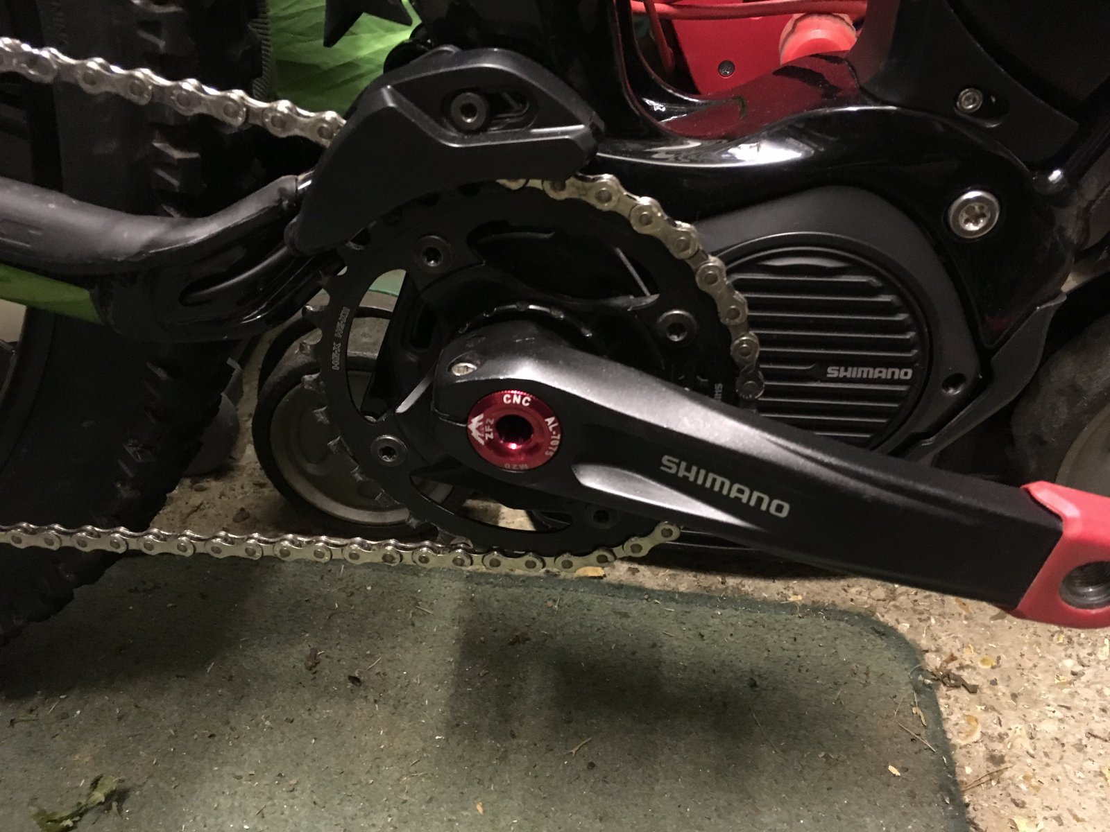

It's a poor design on shimano's part. The crank arm "walks" off the axle due to
  1. Not being butted up against anything pre-loading it (as per shimano's original design spec for the HTII interface.)
  2. Being quite a weak flexy crank arm
  3. The built in lateral movement of the motors main axle.
  4. Having a pathetic plastic bolt to stop it "walking"
The solution is to replace the plastic HTII bolt with an Alu one and (blue) threadlock it. But still keep an eye on those pinchbolts and the distance between the crank and motor. If one of those bolts loses even a little bit of tightness the interface becomes compromised and it can still happen even with the stronger bolt threadlocked in there.

As Gary has said, the Ally cap replacement is the fix I used + checking the pinch bolts are evenly torqued after every few rides. Ebay has them around £5 a pair ??
