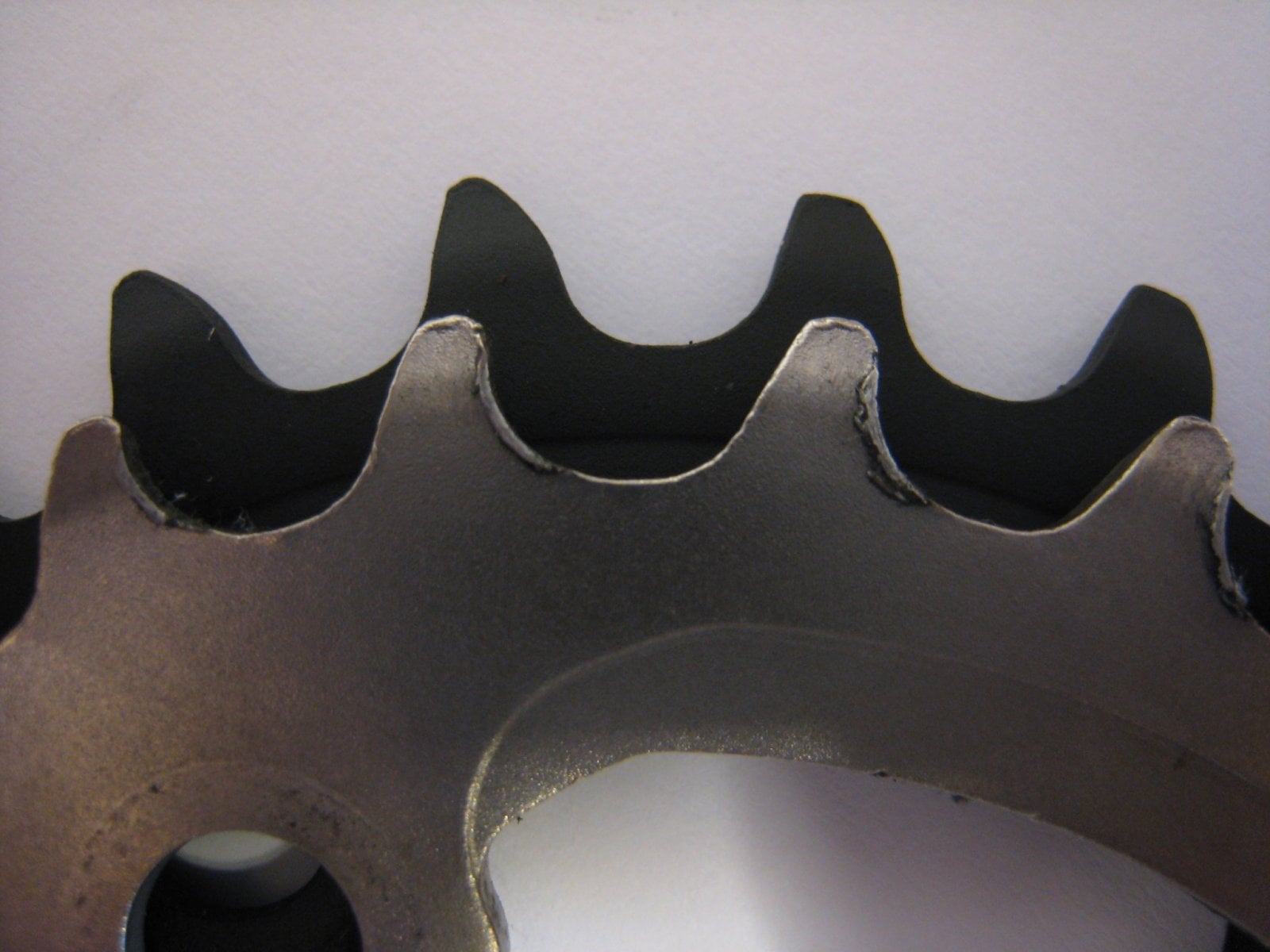

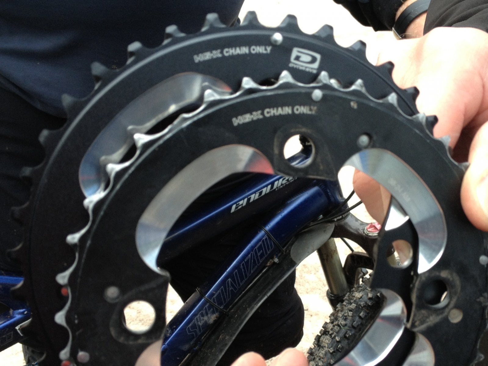

I have attached some pics of worn teeth compared to new ones so that you can see what to look for.

Thanks Steve. The front looks fine. I'll be sure to look after the drivetrain a bit better but I fear it's the abuse I give it on the trails that's causing it. I use the top 2 gears coming down my local trails 99% of the time and have assistance between 130% and 300%. I should probably shift down a couple gears or use less assistance more than I do but that costs time so I leave the motor to do the work and just go hell for leather but that's how I enjoy riding. It's not a huge hit to take every few hundred miles. Worth every penny?

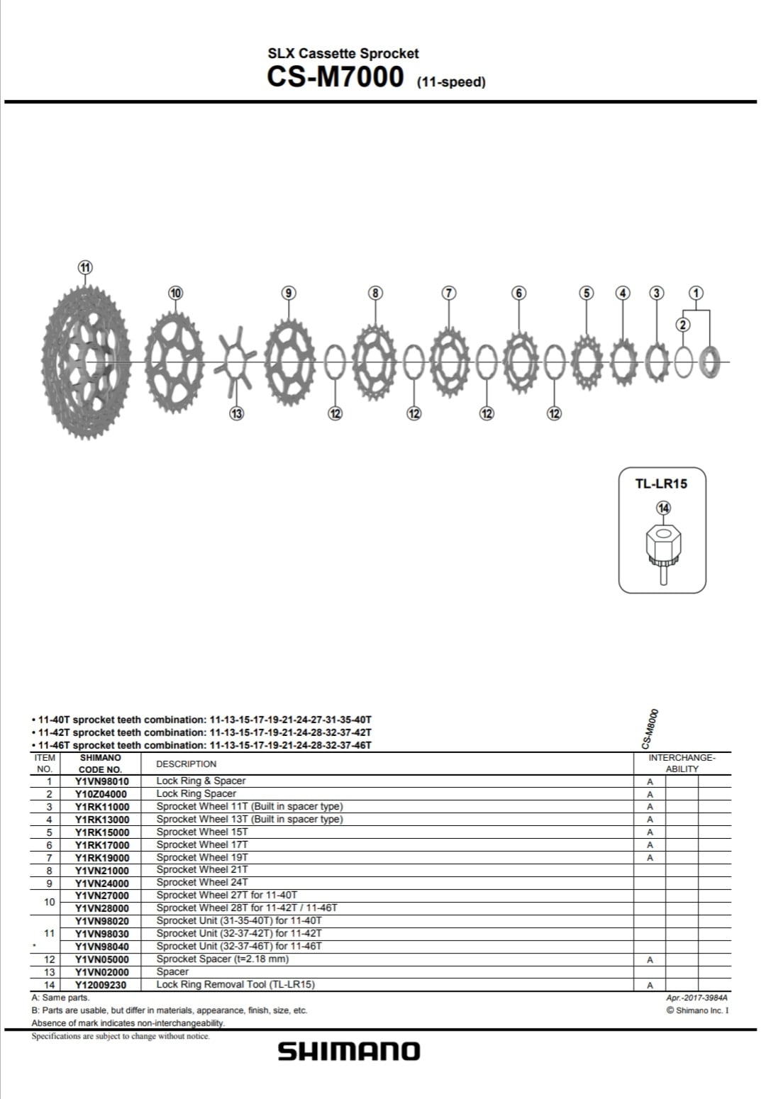

It may well be you dont need to replace the whole cassette, just the 2 small sprockets that it slips in.
Shimano Sprocket for XT CS-M8000 11-speed
With a new chain it should all work again and works out quite cheap. 10 speed chain should be changed at .75 wear, a 11 or 12 speed chain, around the 0.5 mark.
Interesting... Didn't realise you could buy individual sprockets. Thanks! I'll buy an 11 and 13 and fit them to the original cassette as a spare. I've already ordered a spare chain.

It appears the M7000 is interchangeable with the M8000 from 11t - 19t sprockets. I can't seem to find M700 sprockets so good to know.
Edit: It's the exact same sprockets used on the 11-19t on the SLX as the XT hence why they are interchangeable. It proves Gary's point about it not being worth spending the extra dough on the XT.
