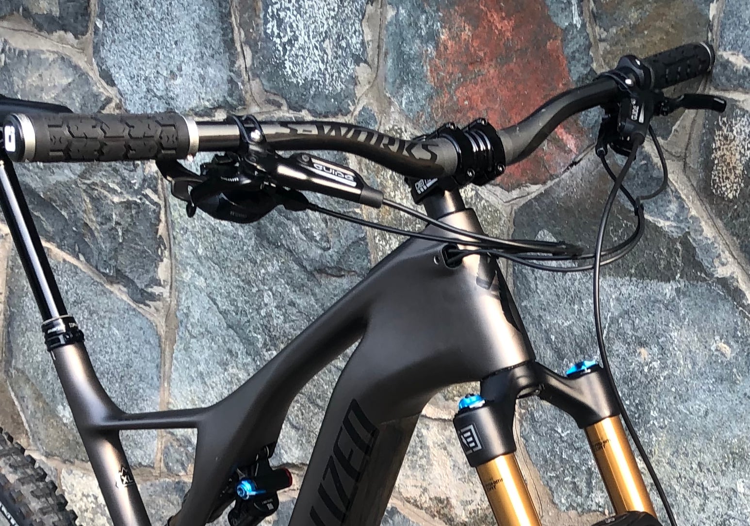

I bought an S-works carbon bar from Specialized. 31.8mm, 3.8 rise, 6 upsweep, 8 backsweep. Feels much better than stock, stealthier looks and costs the same as Renthals or similar aftermarket carbon bars.

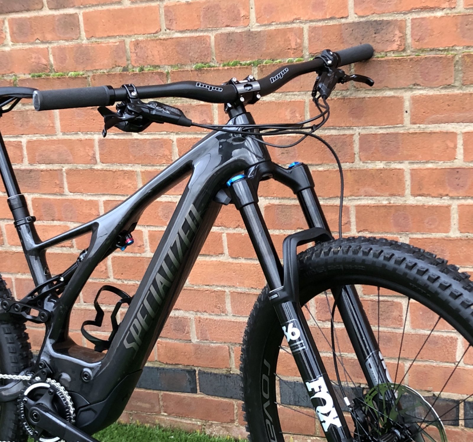

I always use carbon bars mainly renthals and enve but on my 2020 expert i wanted less rise than the std 27mm so thought I’d try hope carbon bars 20mm rise very impressed
Galion, is that really much different then stock?
Maybe I am wrong, but isnˋt the Levo stock handelbar only 10mm lower?
Really like the Sworks, but like to get a little more backsweep.
