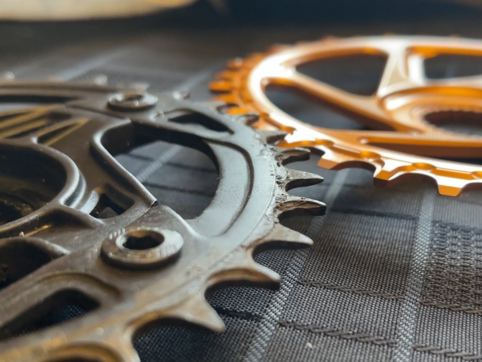

When I had removed the FSA spider (and ring) I placed it on a flat surface, against the Hope ring, to see the difference.
As can be seen the original stands a couple of mm higher.

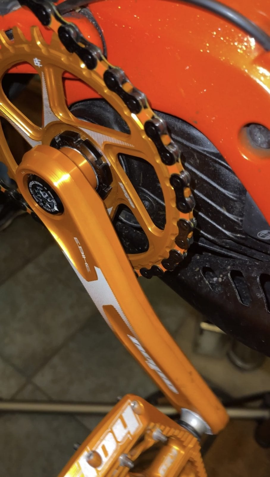

The aheadset spacer is highlighted behind the new chainring being placed.
The rubber o ring that came off with the old chainring was placed, then the lock ring was carefully threaded and tightened ANTI-CLOCKWISE.
New chain was fitted, gears checked for alignment along with new chainring and that was it.
Hope fitted to roughly the same custom Ai alignment. 👍🏻

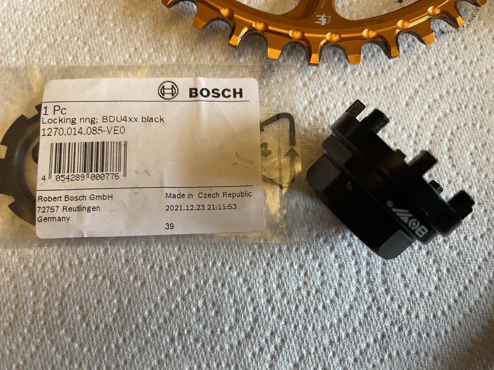

I purchase a new lock ring kit from these people:
Zaskar20
Aug 17, 2021
140
133

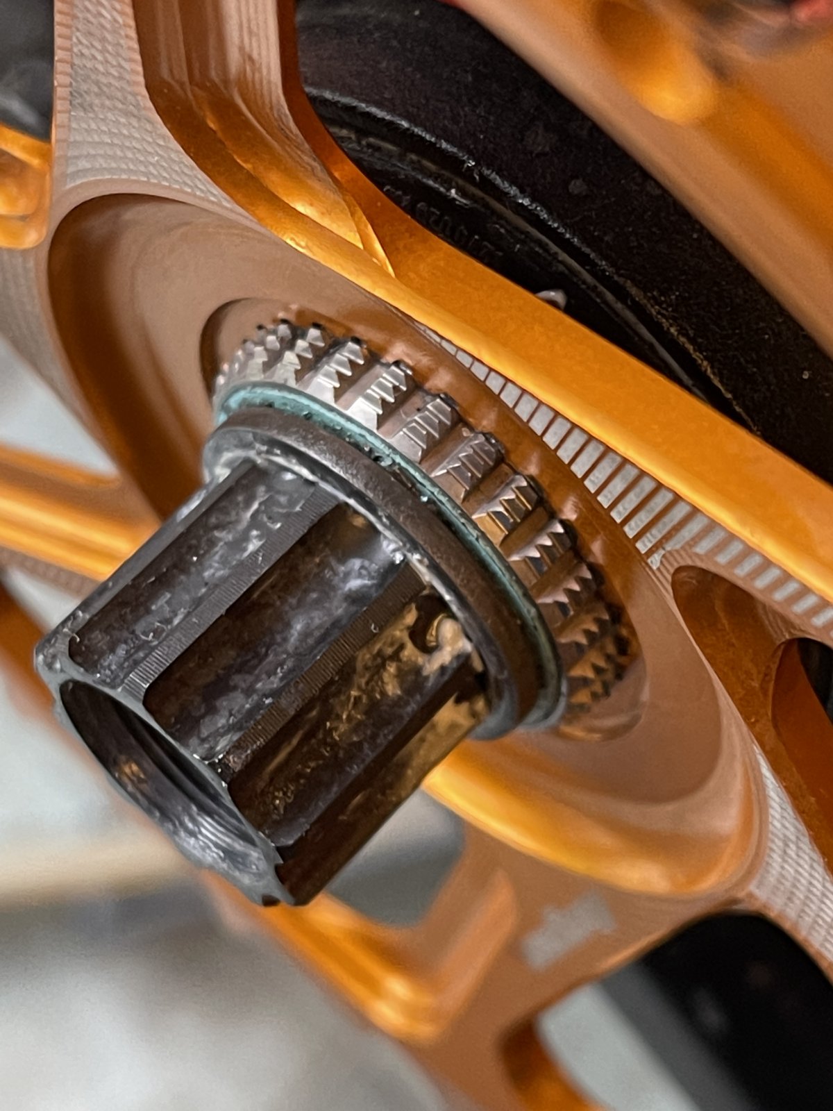

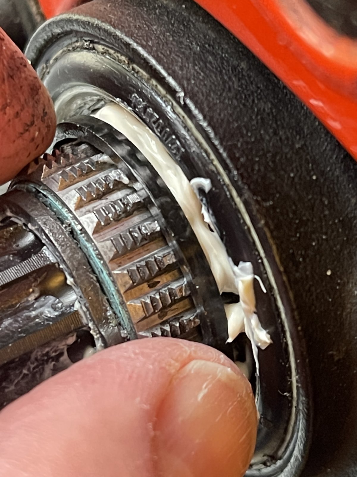

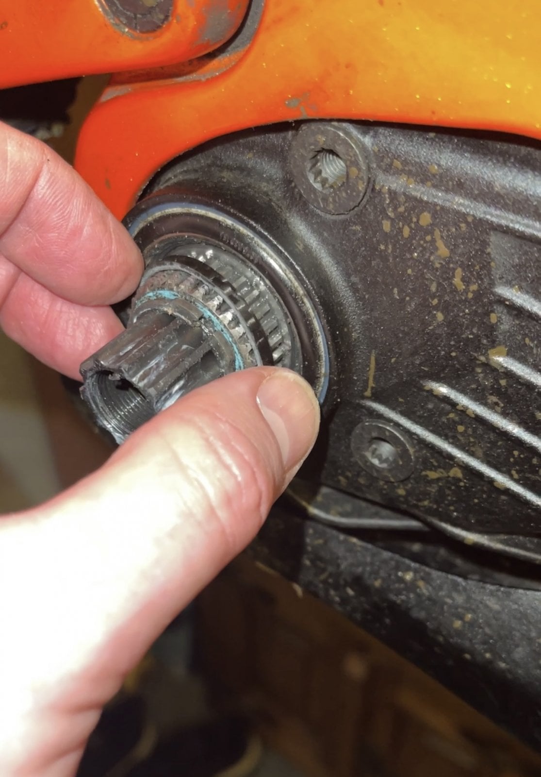

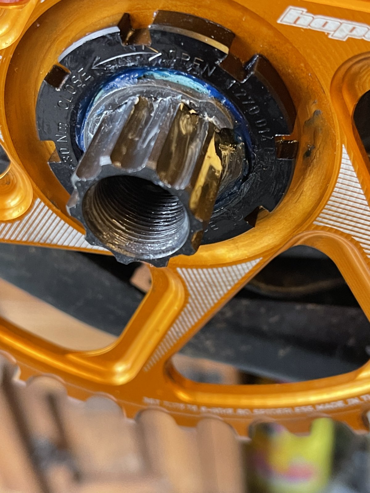

Pics as promised;
New lock ring with tool. The existing ring loosened during a ride. I tried to tighten but failed and crossed threads.
Spacer placed on with assembly grease behind.
Hope E chainring fitted with more assembly grease behind. The exposed threads were cleaned with disc brake cleaner before loctite blue thread lock was applied to both the drive threads and lock ring threads.
Tightened to 30Nm

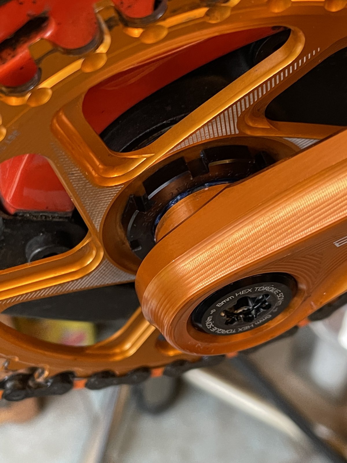

Clearance still ok 👍🏻
Crank placed back on and torqued.
Let’s see how long this lasts 🤞🏻

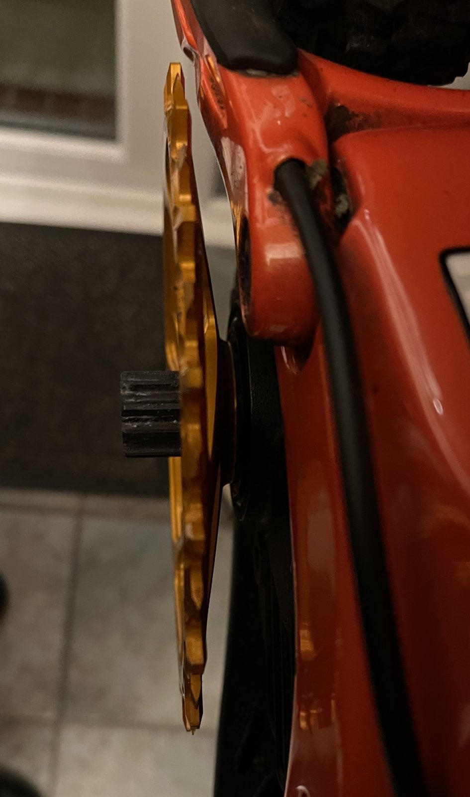

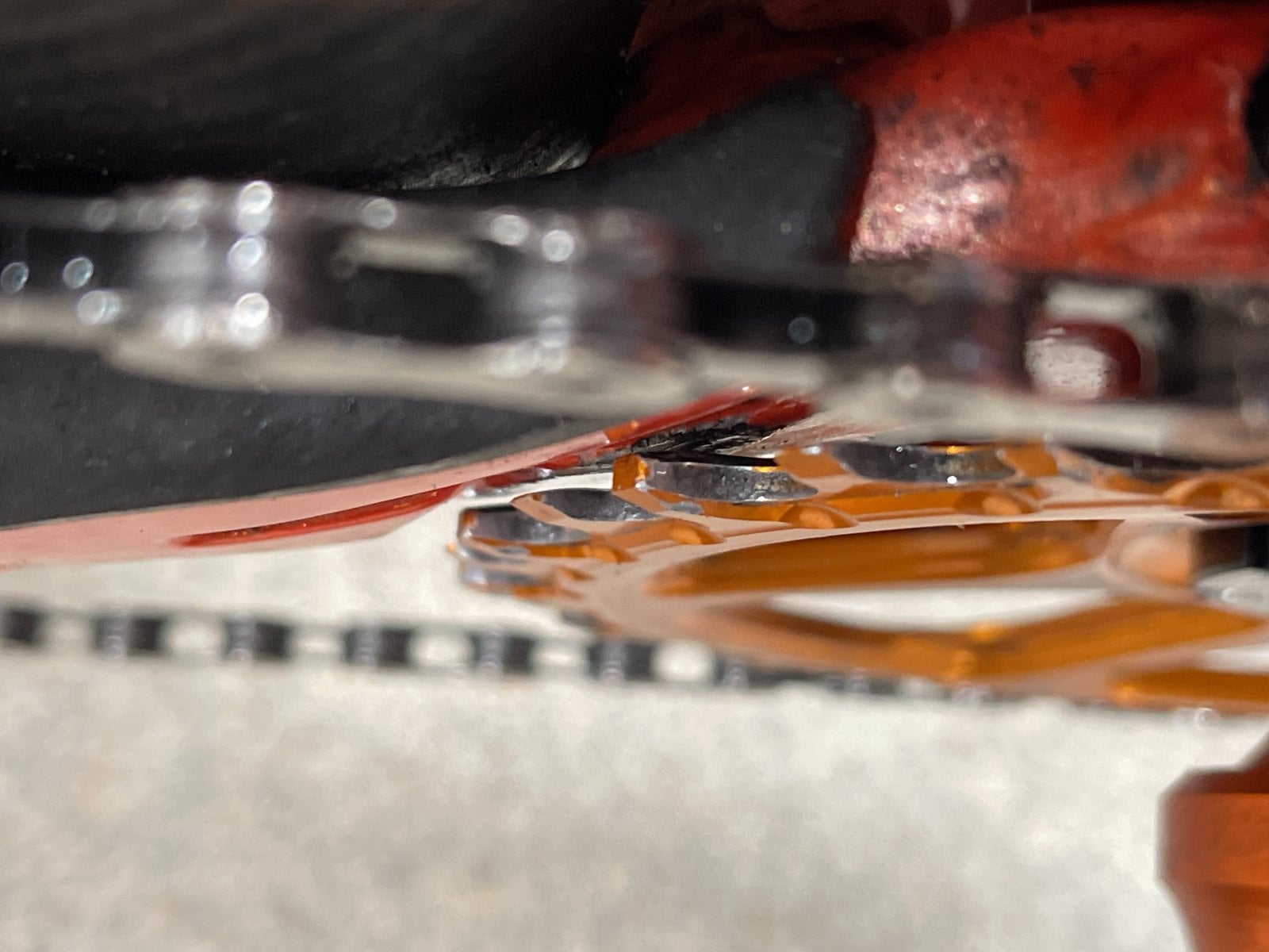

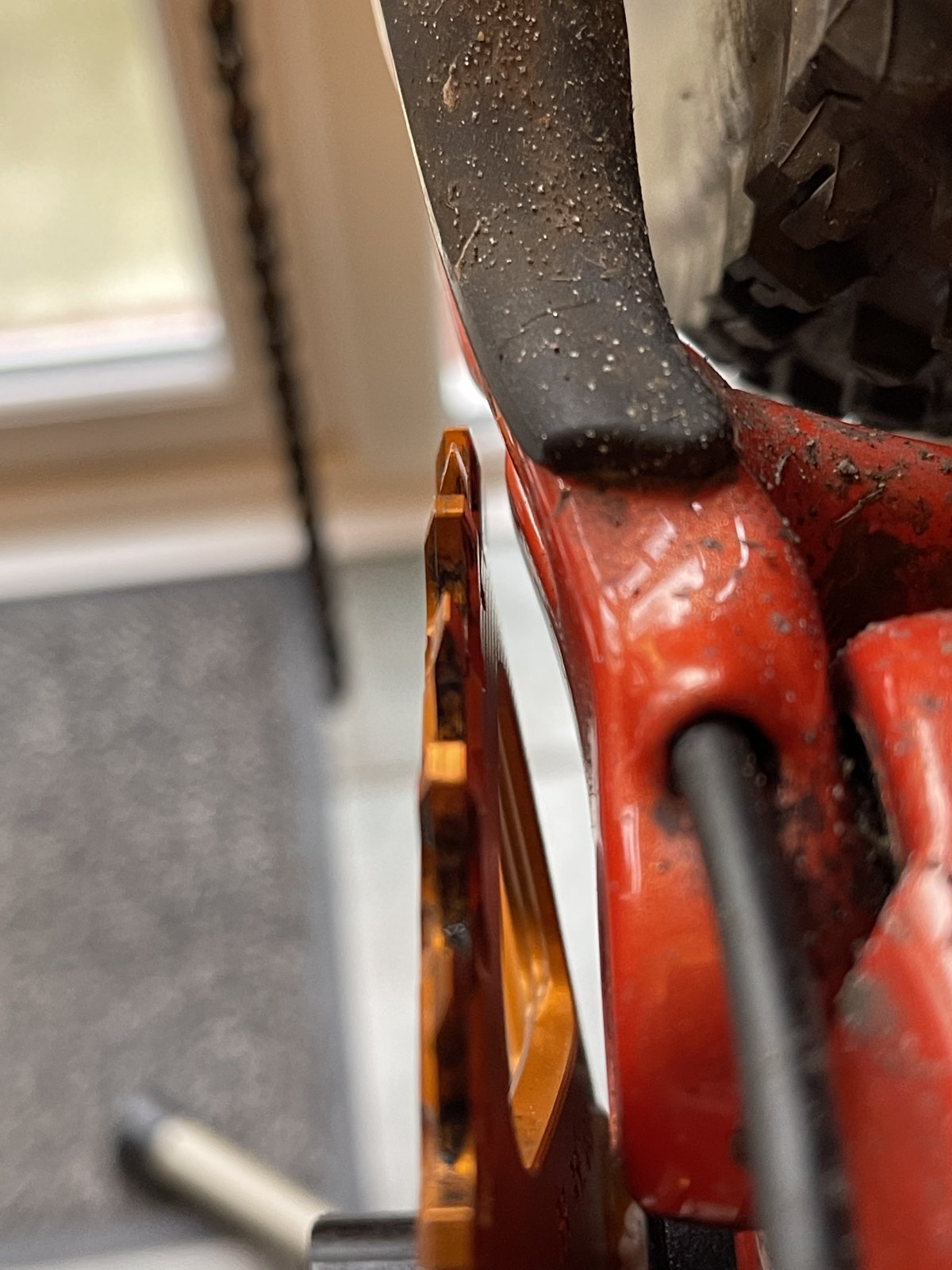

So, after the 2nd incident of the lockring coming loose I decided to ditch the spacer used in the original post. I came to the conclusion that the lockring must be coming loose because all of threads on it were not engaging the all the threads on the splined crank shaft.
I am now using the Hope chainring directly attached. No Ai offset.
Now, considering the derailleur has been set up with the front chainring with the offset, without the spacer (and offset) it still runs perfectly without adjustment.
The Hope 36T chainring just clears the chainstay (see pic)
I have tightened a new lockring with the recommended torque, now with the O-ring, but using the stronger red threadlock
