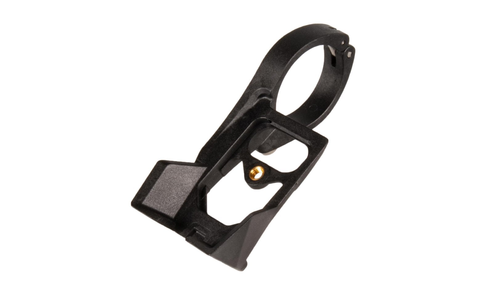

If you take the Kiox mount off of the frame there is a hole in the back side and matching threaded (M4?) hole in the back of the Kiox. This allow you to bolt the Kiox to the holder. My Rail spends a lot of time on the bike rack on the car in sketchy places so I am concerned about having the shinny trinket there for someone to try and pry it off, so always remove my Kiox when it is on the car.

There's a set screw that mounts the display unit itself to the mount. It goes underneath the mount and fixes the display unit in place. It's a 6mm M3 screw.

Kiox has both magnet and spot for a screw to secure it in. Although my bike didnt come with the extra screw. The screw hole is in the center of the magnet (have a look!)

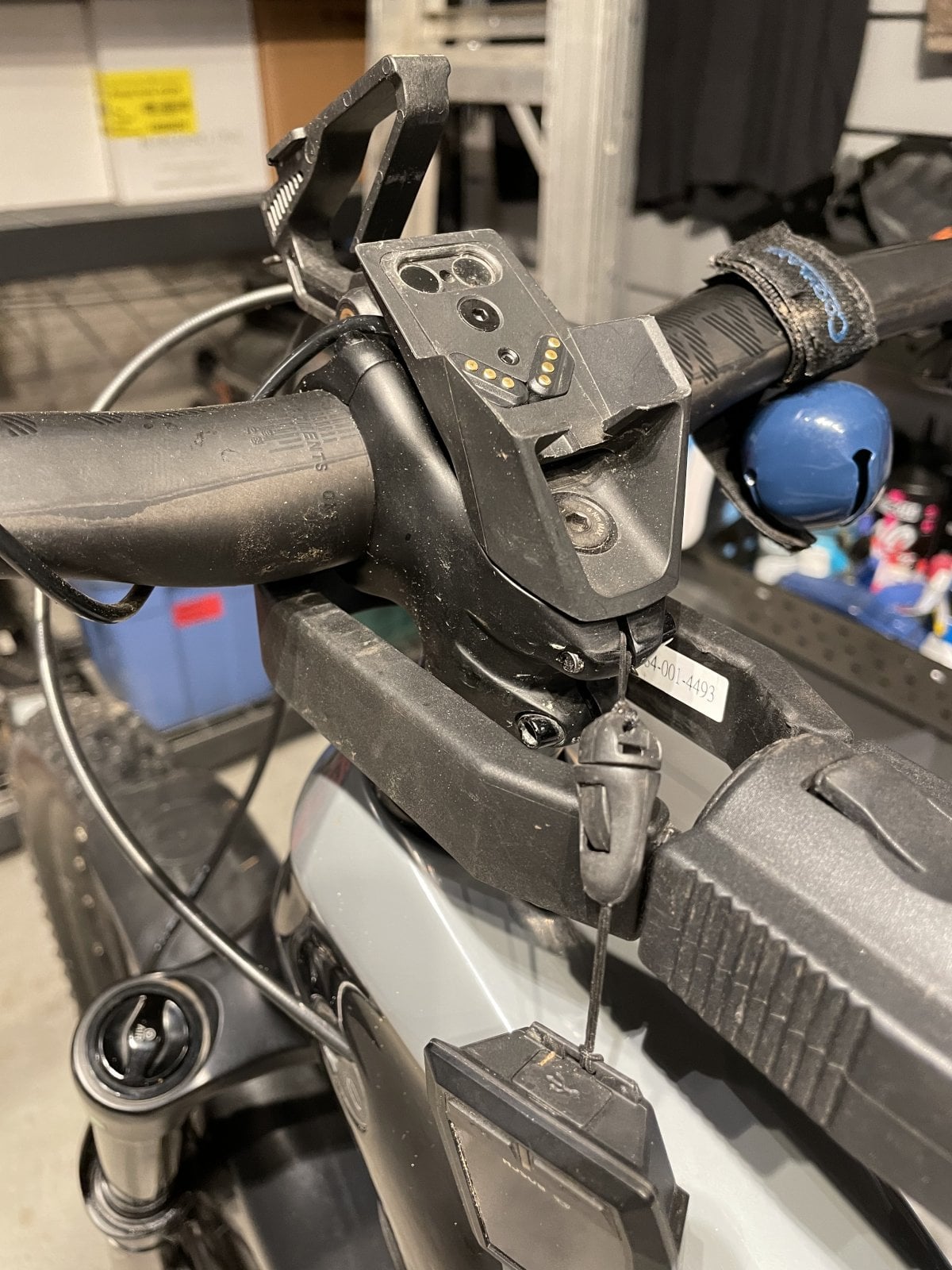

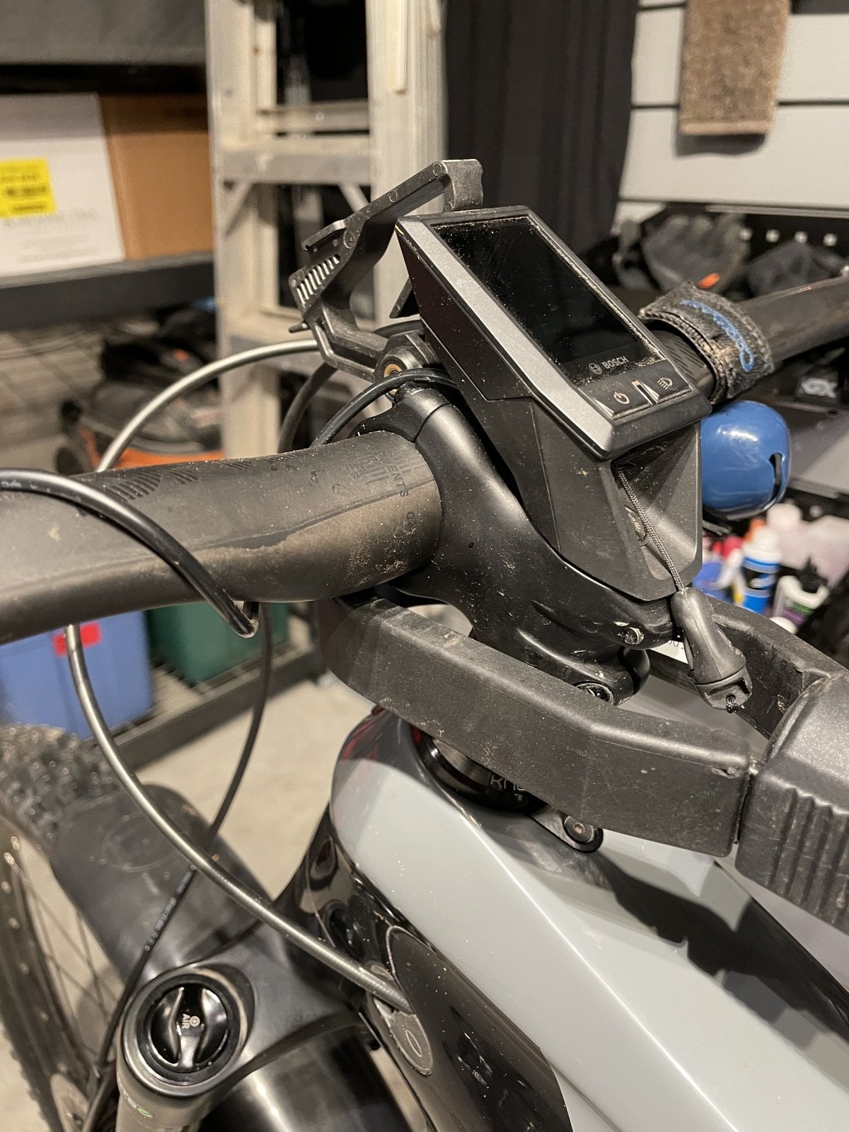

I use a lanyard with a quick release clip. Take it off when on the bike rack and if I have to leave it (not often).. Pre-lanyard I did loose it for over an hour in mud and leaves.

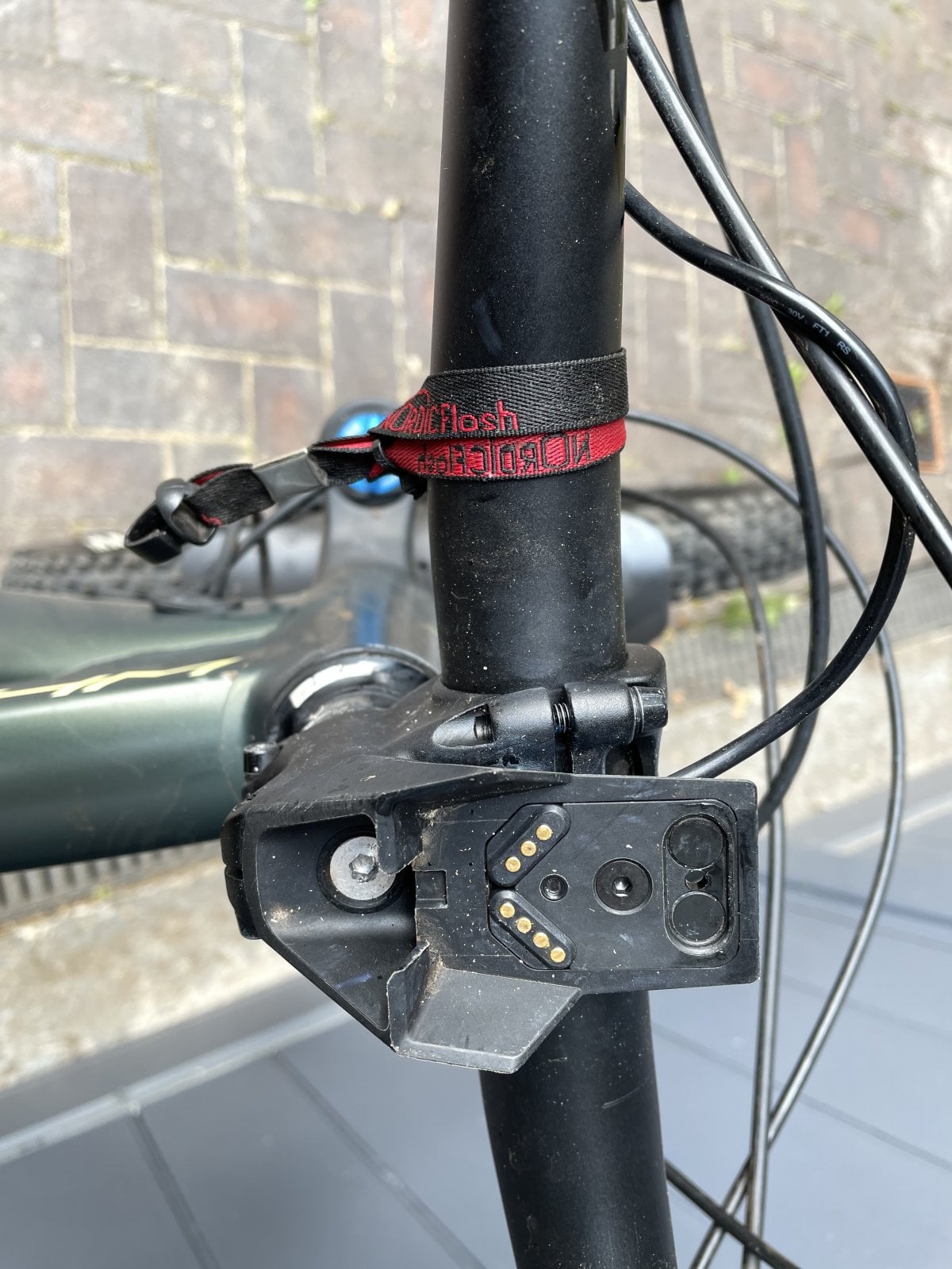

Yes. Ive had a lanyard and a quick release attached for a while now. Pre-lanyard my Kiox was knocked off twice(15min to find once). Never lost or misplaced since the lanyard and quick release was attached but now, when it disconnects, its easily found and replaced in seconds. I prefer the stem mounted version because the view is easier for me(vision issues). In the case of a crash it simply pops-off and hangs there.

how long is the lanyard?
i would be worried that having it attached would cause it to continually catch and bang on handlebars, frame etc.

It’s 21cm. Mine doesn’t seem to catch or bang.
The lanyard could be as long or short as you want…… but not too long or it will catch in the spokes.
The lanyard is attached/looped thru a single stem bolt, then a release device/clip, then atttached to the Kiox. The lanyard or string doesn’t have to be to long(2 1/2 inches ?) I posted some pics somewhere in here..can’t find them though.

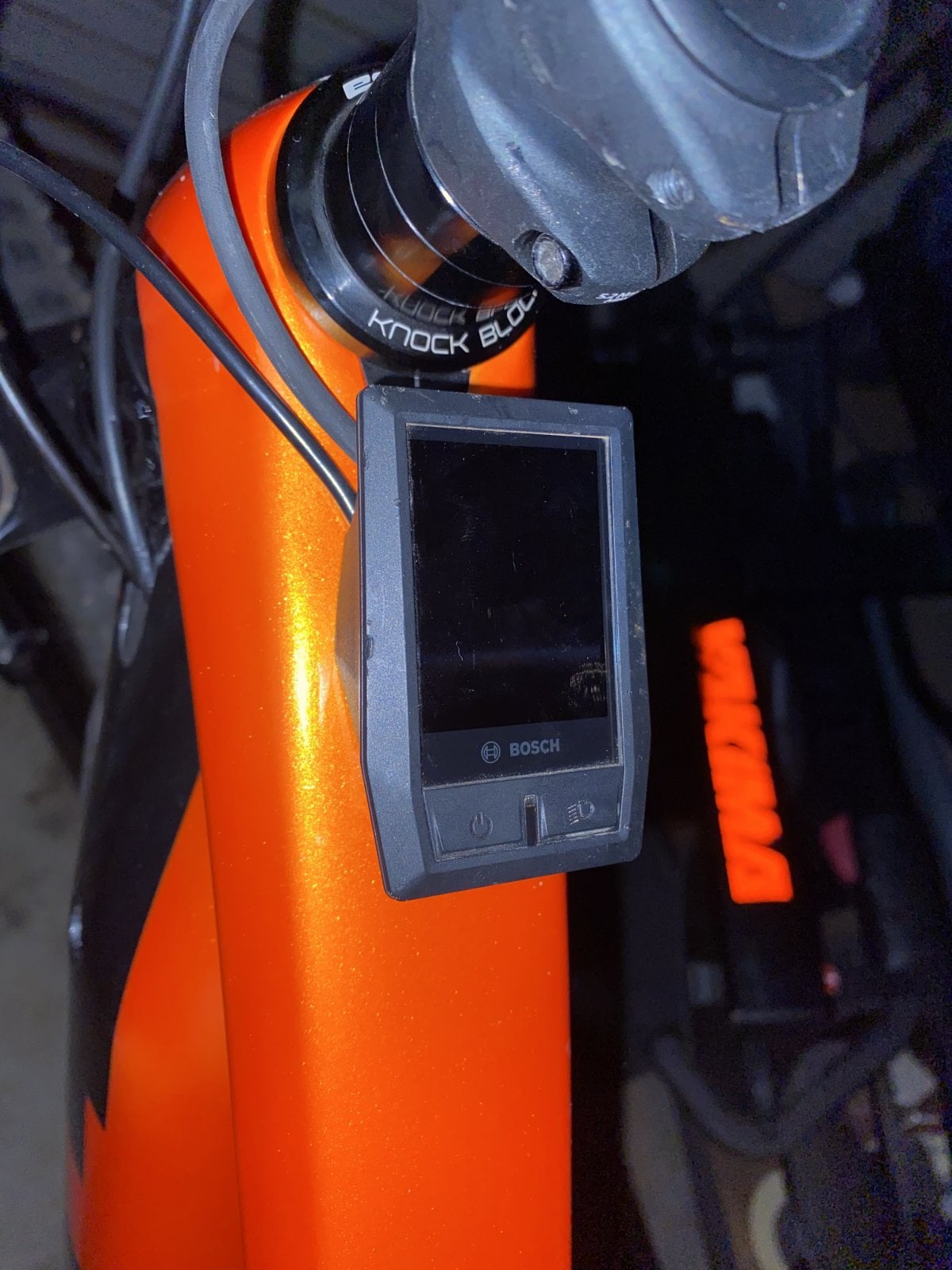

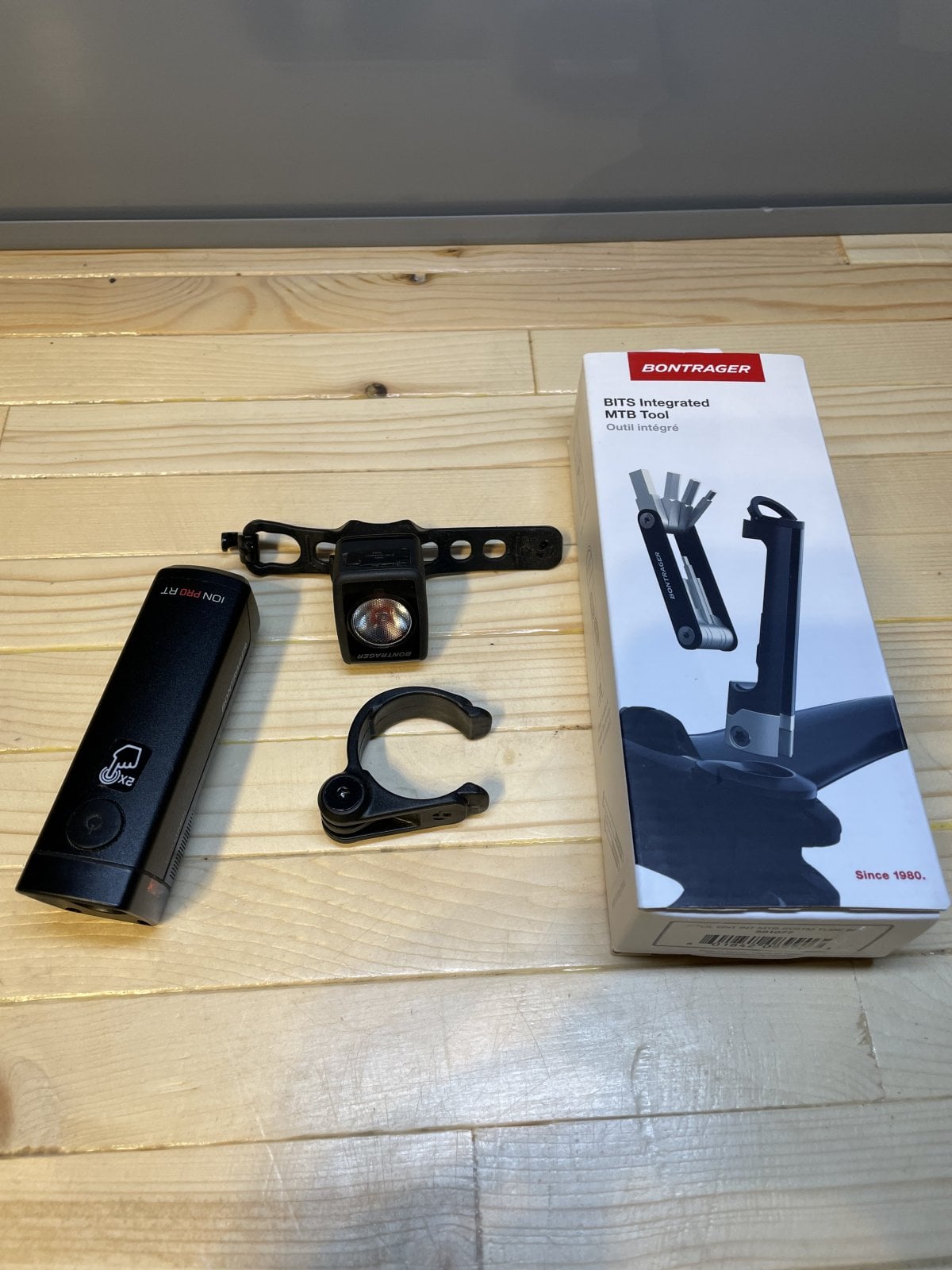

So last week I ordered the Kiox mount for the upper tube (knock block screw area). I guess I’m trying to cleanup the cockpit since I’m on the AXS-Derailer-Reverb-Train. I use the 45mm Blendr stem which allows a single or double Blendr holder to be attached for a Bontrager light or GoPro.
This will free up the stem tube for other things such as AirTag, tools or emergency Viagra supply. (The wife suggested only the AirTag btw).🤔
I find that during a ride, besides switching modes, I mostly use the Kiox for the digital clock. I look at the other stats once I get home. As long as I can glance at the Kiox, and see the purple colour, I know I’m in EMTB mode. Moving the Kiox to the knock-block location might allow for a better angle of the Bontrager light and cleanup the cockpit a bit.
I don’t know how many grams a Viagra supplement weights? 😉
