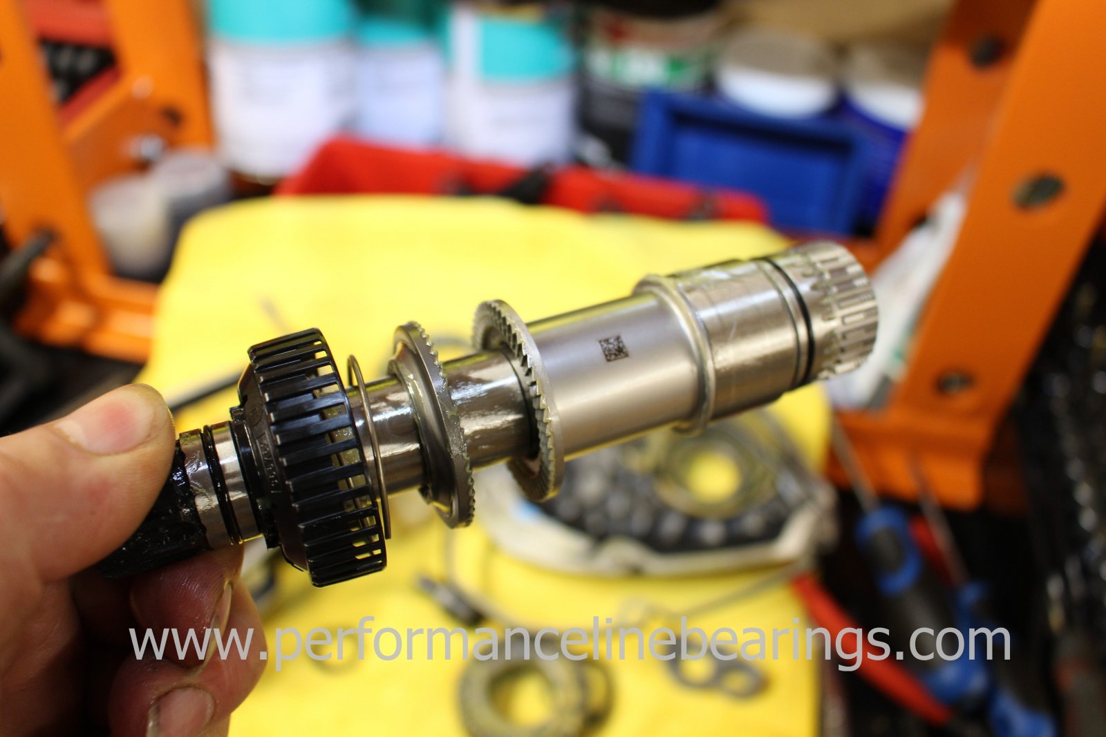

It's not really the drive gears, it's the freewheel ratchet. Had they made it very slightly courser, it probably wouldn't do it. (the bit in my photo below)
