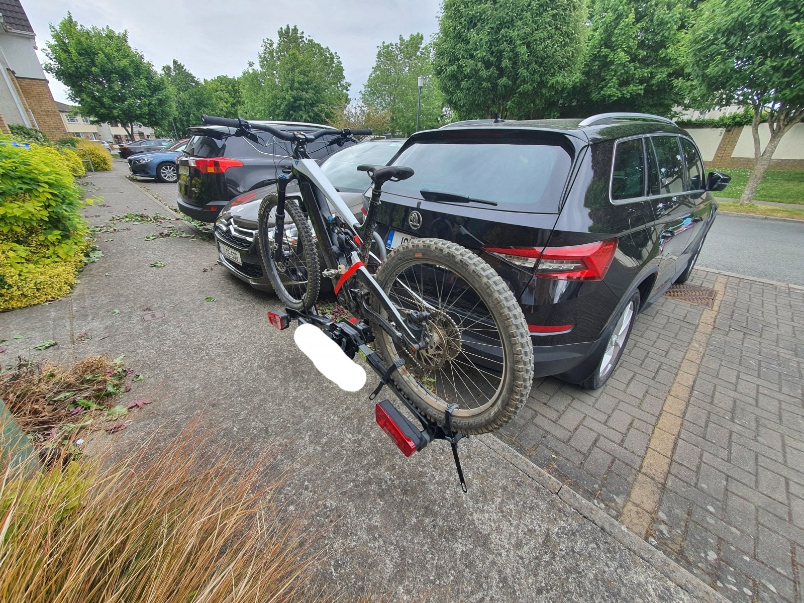

Hello people i was sick of lifting the decoy in and out of the car and could not bring the dog with me. I bought a bike rack which was delivered today.

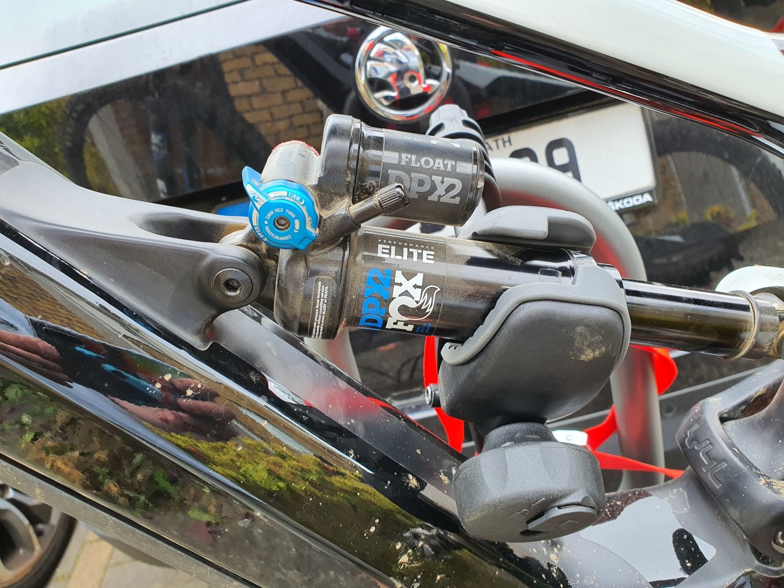

I have a question I am used to having alloy bike and this is my first carbon bike. I am paranoid about damaging the carbon.
Instead of clamping the bike on the top tube do you recon it be ok to clamp around the air can?
The way I am looking at it the clamp is not that tight and if the worst happens I can replace the air can? Does any one else hold their bike in the rack like this.?
I got buzz rack e scorpion ( single bike).

I wouldn't clamp the shock that way. From what I can see, you'll be putting a lot of lateral force not the shock as the car vibrates, which could lead to shock seal or mounting hardware failure.
Hitch mounted racks are best.

Hello thanks for the reply I looked at getting one of the fake top tape adapters but with zero stack you would have to put it around handle bar and the tension be off center. The weight of the bike is not on the shock just just to keep it vertical. Maybe a better photo will show what I mean
9,190
Just clamp it on the top tube and use a rag/chamois to protect it - I uses to have a neoprene velcro sleeve I used when I had a rack like that, bit like this:

I just bought the same rack!
I put on my carbon Trek Rail and clamp on the top tube, I can't see any issues, just don't do it up to an inch of its life.

Also I noticed you have your bike on the wrong way round, the front wheel should be on the side with two straps to stop the wheel waggling in the airstream ?

I’d clamp it on the top tube with a rag in between the clamp and the top tube. Doesn’t need to be too tight as long as you aren’t in race car mode on the way to the trails.

I'd be concerned about that connection on the top tube. One large bump in the road... especially with a 50lb bike.

I too have a CF frame. I wrap a piece of closed cell foam "6 x 4" under the jaws and tighten up until it is firm on the top tube. I can lock the clamp knob so it doesn't go loose. Then I wrap some Gorilla strap in a figure of eight pattern around the clamp and top tube. If I didn't have a Gorilla strap I would use a normal strap and buckle. Even if the clamp was to come loose the strap would stop it falling.
The weight of the bike is taken on the wheels. The clamp is just to stop the bike from pivoting down to the ground while the car is moving!!!

The bike is tied down by the wheels so the clamp is really only to stop it falling backwards or forwards. I would love to get a pickup with only a drivers seat that would solve all my problems ?, I will order one of those neoprene pads and try that. I will clamp it to the shock tube until it arrives. Should have bough an alloy bike ?, I do like the decoy to be fair it's my first ebike and loving it.

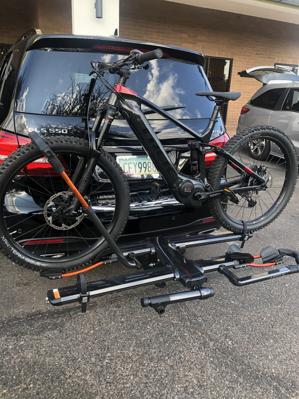

Kuat V2. Holds two ebikes. Integrated locks (3). One for rack and one for each bike. Has an integrated bike repair stand/clamp for trail repairs. Gets the rear wheel elevated.
Put your rack’s front clamp up against the fork arch. That way if the back strap fails for any reason the rear end of the bike won’t be able to elevate up off the rack.
Jeffsy29
May 6, 2020
191
85
Rockville MD
@rb. Lol...not YT related, but my friend and I argued about this positioning many times. He too prefers to place the hook ~180 degrees from the arm pivot (nearly crossing the axle). He's worried it's going to mess up the fork or cable and isn't convinced it holds better than his method.
I place mine between the "V" of the tire and fork body. I never read the manual...it just make sense if you think about it.
I simply gave up trying to explain it to him....it's not my bike or rack and I don't drive behind him!
