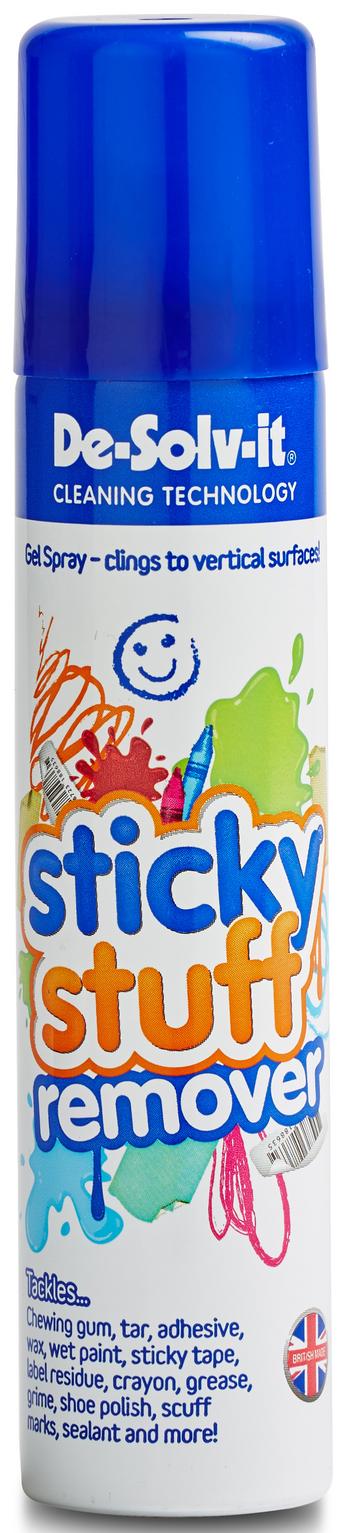

I recently had a pain of a time removing Gorilla glue adhesive from my bike rims. For removal, all the usual suspects were used (iso-propyl alcohol, meths, white spirit, acetone, proprietary "sticky stuff remover", even Sellotape!), all to no avail. Then I used petrol with a rag. At first it didn't seem to work, but then suddenly it just wiped off. :)
They key is patience. I wonder how many of the other things I tried would have worked if I had left them to soak for just a little bit longer?

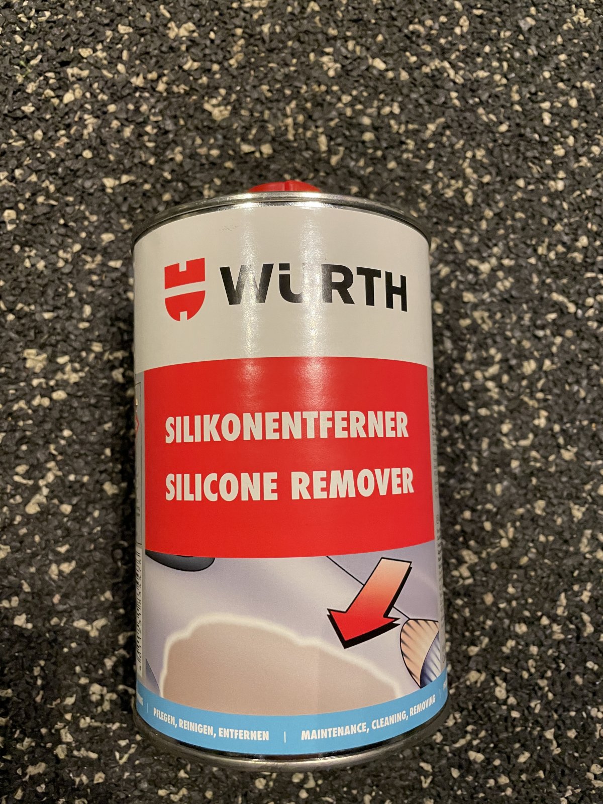

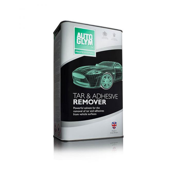

I use Wurth silicone remover for anything sticky. It’s an absolute god send! Similar to Autoglyn Tar and Glue remover... except the Wurth stuff is available in the chemical cupboard at work ?
Spray some on, leave it for a minute, wipe off. Job done.
View attachment 49076 e
I'll be heading to the hardware store tomorrow...I doubt I'll find whatever that is but I'm sure they'll have something similar.
thanks again everyone.
