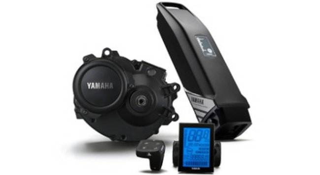

There is just too little data for the 5 motors with the least votes, so I'm ignoring them. But you might disagree, feel free to interpret the data as you wish. I declare Yamaha and Bafang the winners. Sure, some of the Bafang motors could be used in DIY builds which makes it more difficult getting a new one under warranty. But factory brands such as Forestal and Elife (Norwegian) are represented here. Yamaha and Bafang offer spare parts so their motors can more easily be repaired. This means the error rate could be higher than indicated here. The motors might have been repaired rather than swapped.
