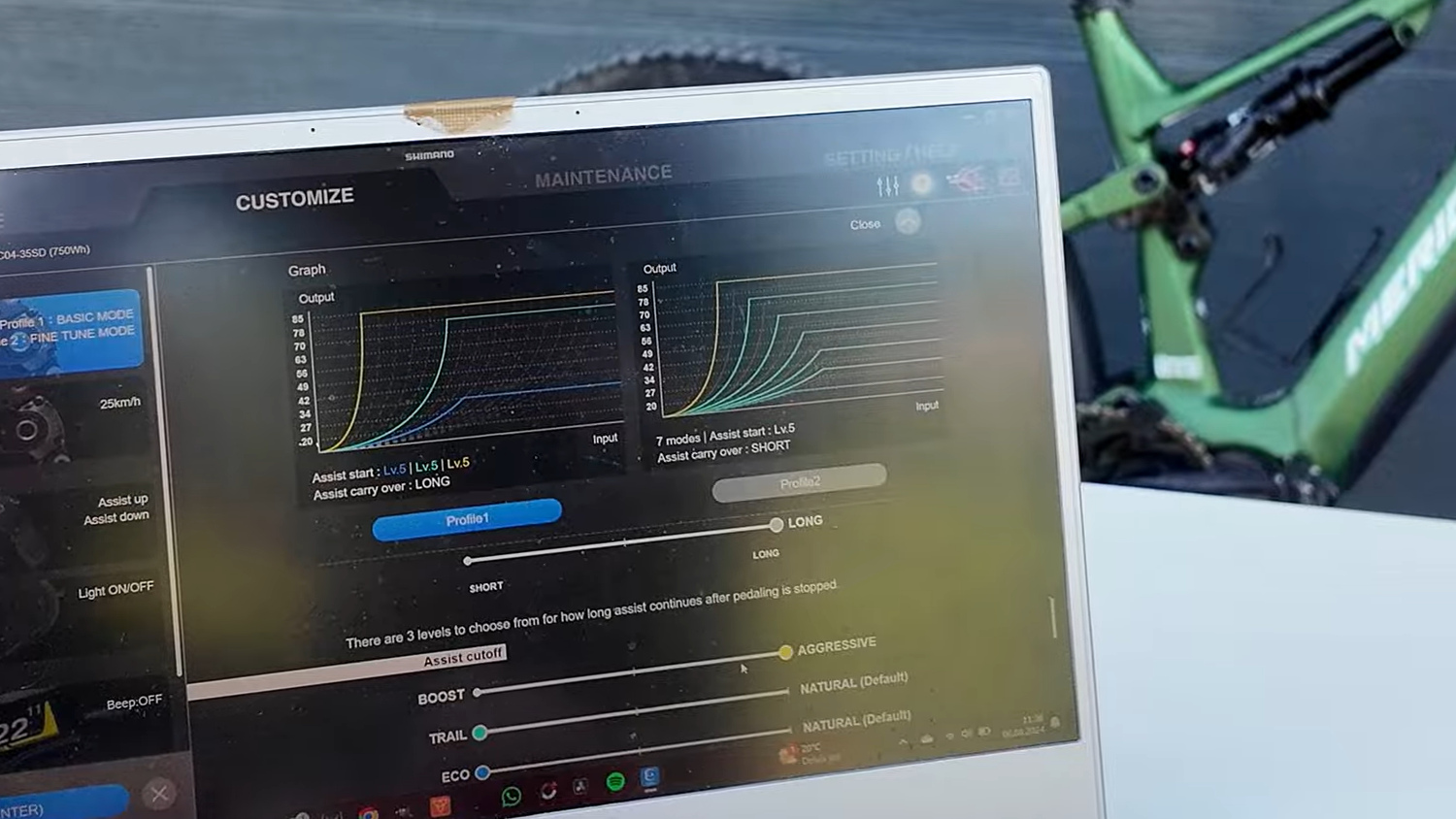

I think this is the most interesting part of the 4.3.0 firmware, it’s the motor overrun settings. We now get 3 levels of “carry-over” to choose from: short, middle and long. This is a “global” setting that will affect all assistance modes. Unfortunately, only the EP801 gets this functionality.
The assist carry over is just one slider that affects all assistance modes.

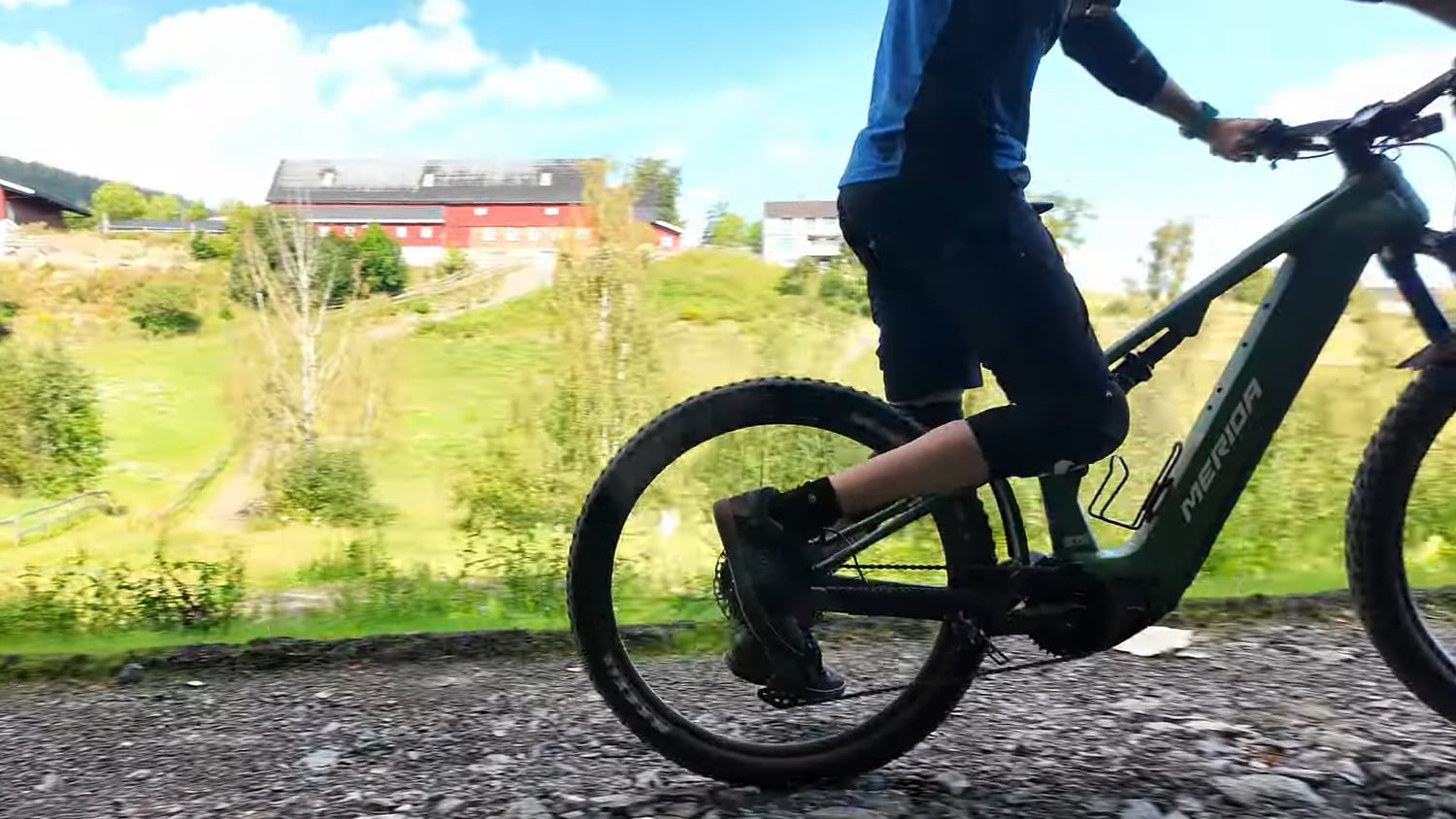

In the “long” setting, the motor gives us a nice shove. It seems the overrun duration is as long as it legally can be. Push the pedals less than a quarter of a turn, then backpedal and repeat and the motor keeps pushing you forwards with lots of power. Even though the motor keeps the power up, it doesn’t feel very aggressive and difficult to control.
I push the pedals hard and remove my feet entirely as the bike is propelled forward.

Both the EP801 and EP600 get the “assist cutoff” function. This determines how fast the motor tapers down the motor power as you approach the cutoff speed. It does not change the maximum speed of the motor. It can be set individually for the Boost, Trail and Eco modes and we get to choose between Natural, Middle and Aggressive.
The Assist cutoff is set individually for each assistance level.

As of now these settings can’t be changed in the E-Tube Ride app. But Shimano says the next version of the app supports the new settings. They expect it will be out sometime in the fall of -24, it will be the next version after the current 5.3.2.

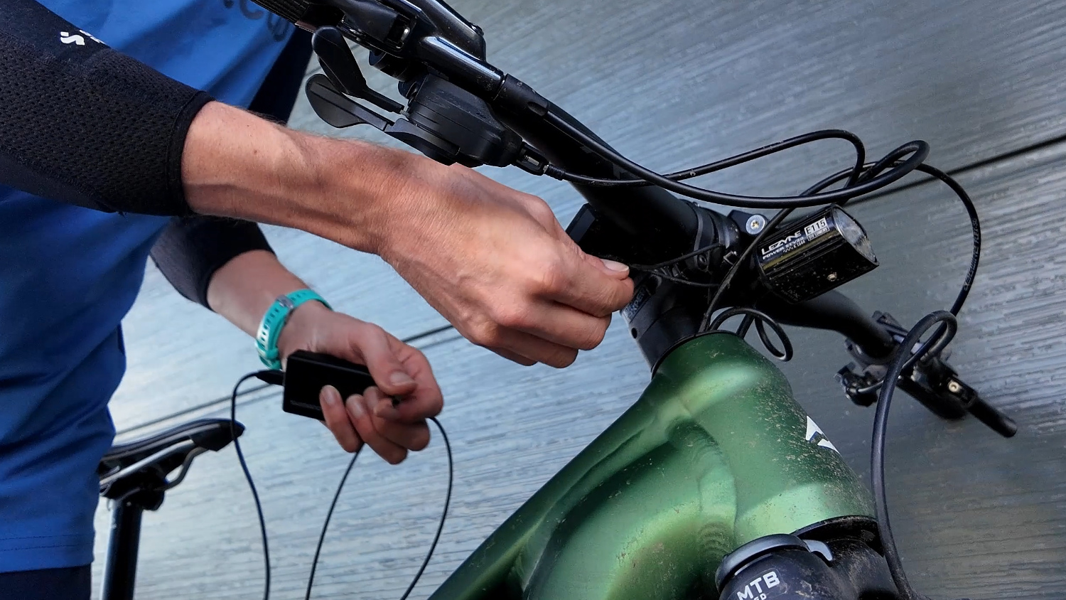

This means you either need the Shimano PCE02 PC connection hardware, or you need to visit a dealer/shop. I guess it can be inconvenient testing all the settings if you need to visit your LBS.
Connecting the bike to a computer using the Shimano SM PCE02
