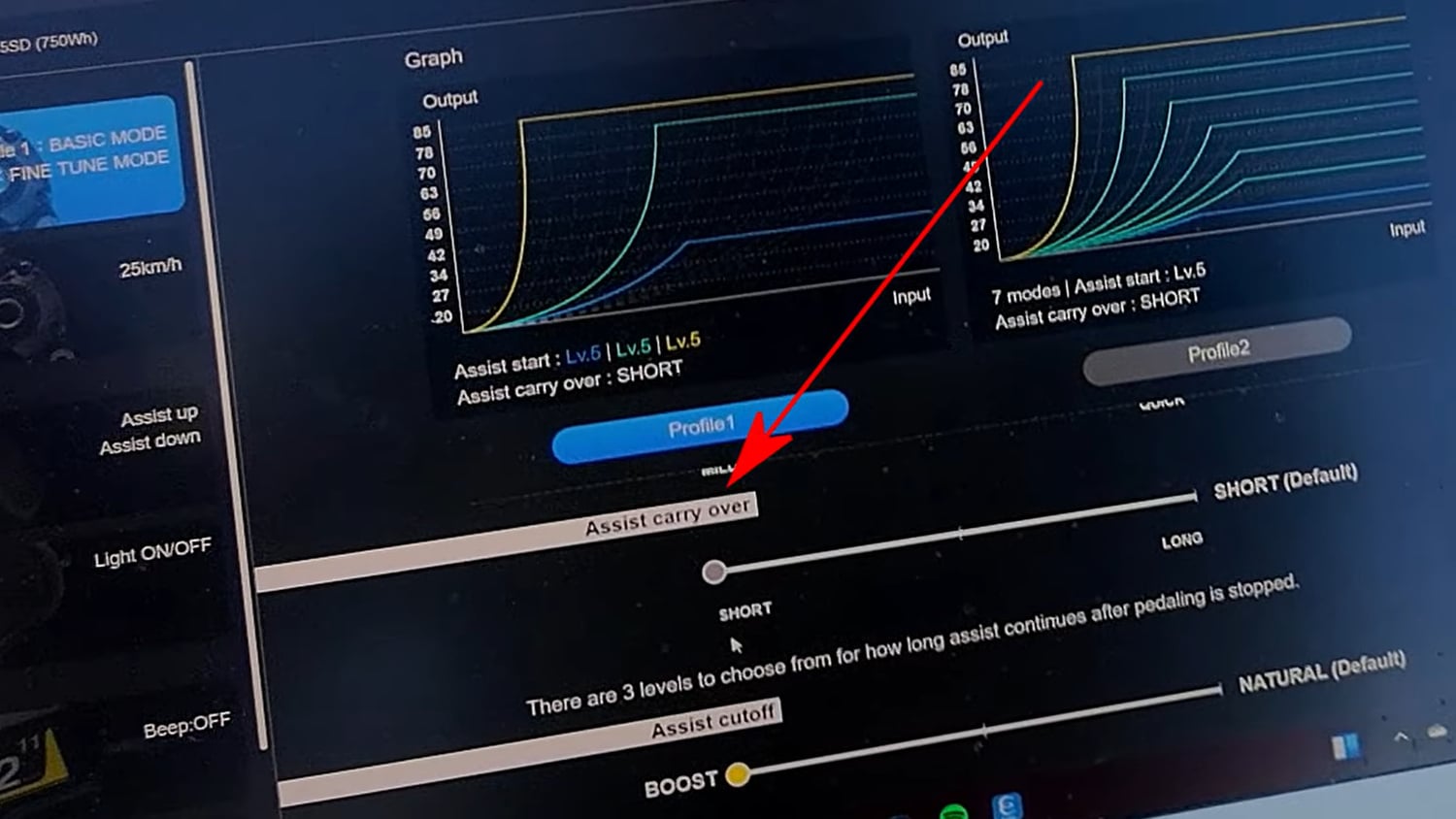

But what about the Shimano EP801? This motor can be found on bikes running 12-speed Shimano Deore, Sram SX and such. With the 4.3.0 motor update, the Shimano EP801 can have lots of motor overrun. This is done by setting the “Assist Carryover” to “Long”. The result is overrun comparable to the Bosch CX Race.
Riding with maximum overrun and assistance​

The Assist Carryover setting.

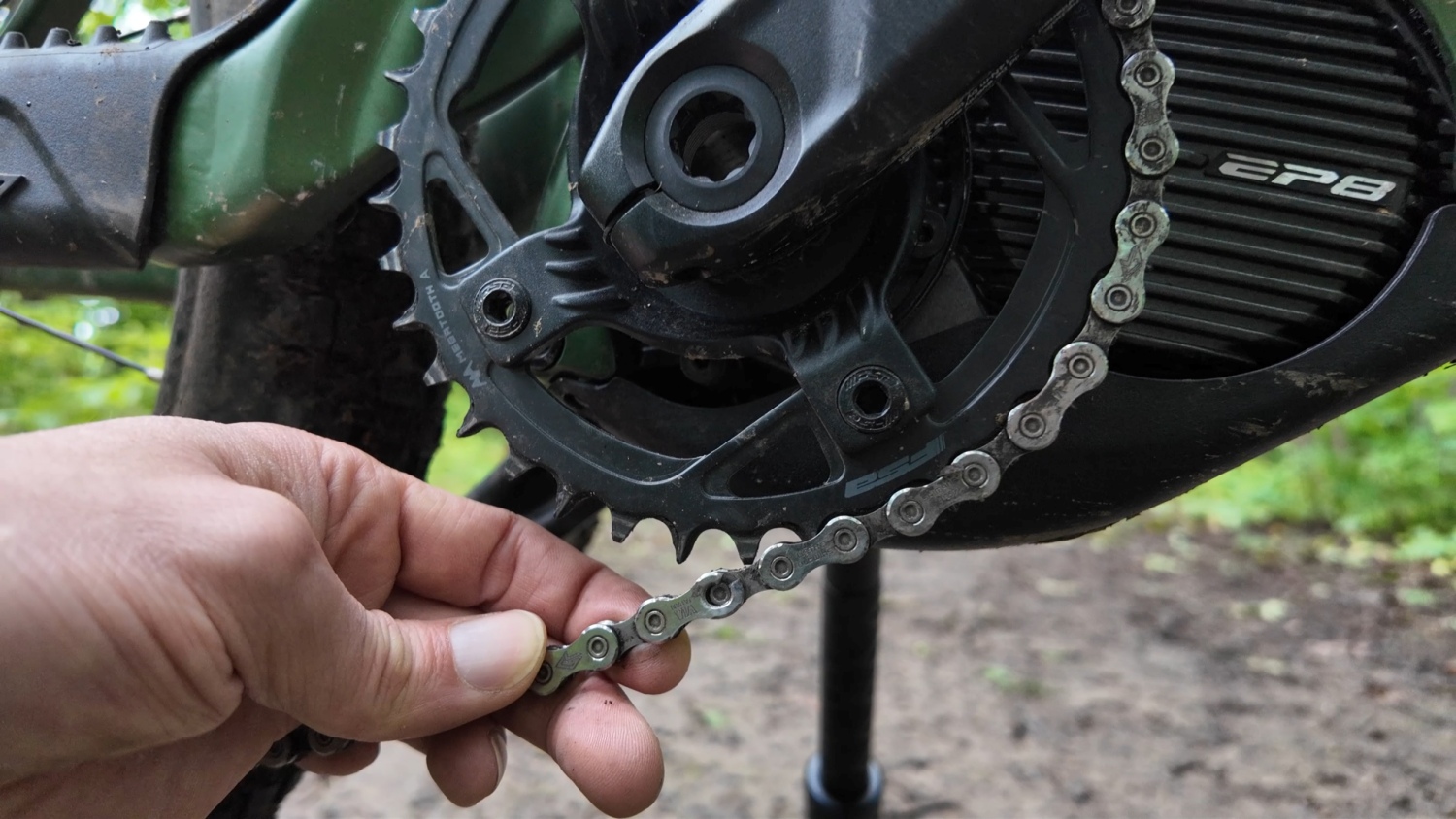

We have been testing the new EP801 motor settings on a brand-new Merida eOne-Sixty 675 with the Deore Linkglide drivetrain. And I’ve been very happy with the shifting. I’ve managed to suppress my mechanical sympathy and just shifting whenever. This 10-speed drivetrain seems a great fit for riding Boost mode with maximum overrun. But …
Okay, I’m riding a demo bike, and I’ve got no idea how it’s been treated before I got it. Perhaps the chainring had been smashed into rocks? Regardless. I managed to snap the chain! I tore an outer plate off the pin.
We'd expect the 10 speed Shimano Deore Linkglide would handle the Shimano overrun. There is a possibility the chain on the demo bike had suffered previous damages.
After having fixed the chain, we kept riding and shifting under load. The drivetrain worked fine and still does. But it was a reminder; how hard are these motors pushing the drivetrain? How will the cheaper 12-speed drivetrains cope? Or how about the older 10 and 11-speed systems that aren’t designed to shift under load?
I really like the long Assist Carryover, but will it be too much for an older drivetrain? The "middle" setting could be kinder and there should be little problems when riding the default "low" setting. ANd as mentioned, stepping down the assistance from Boost mode will help.

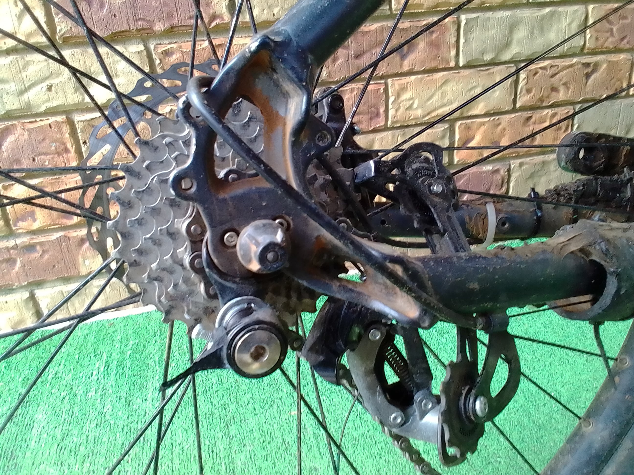

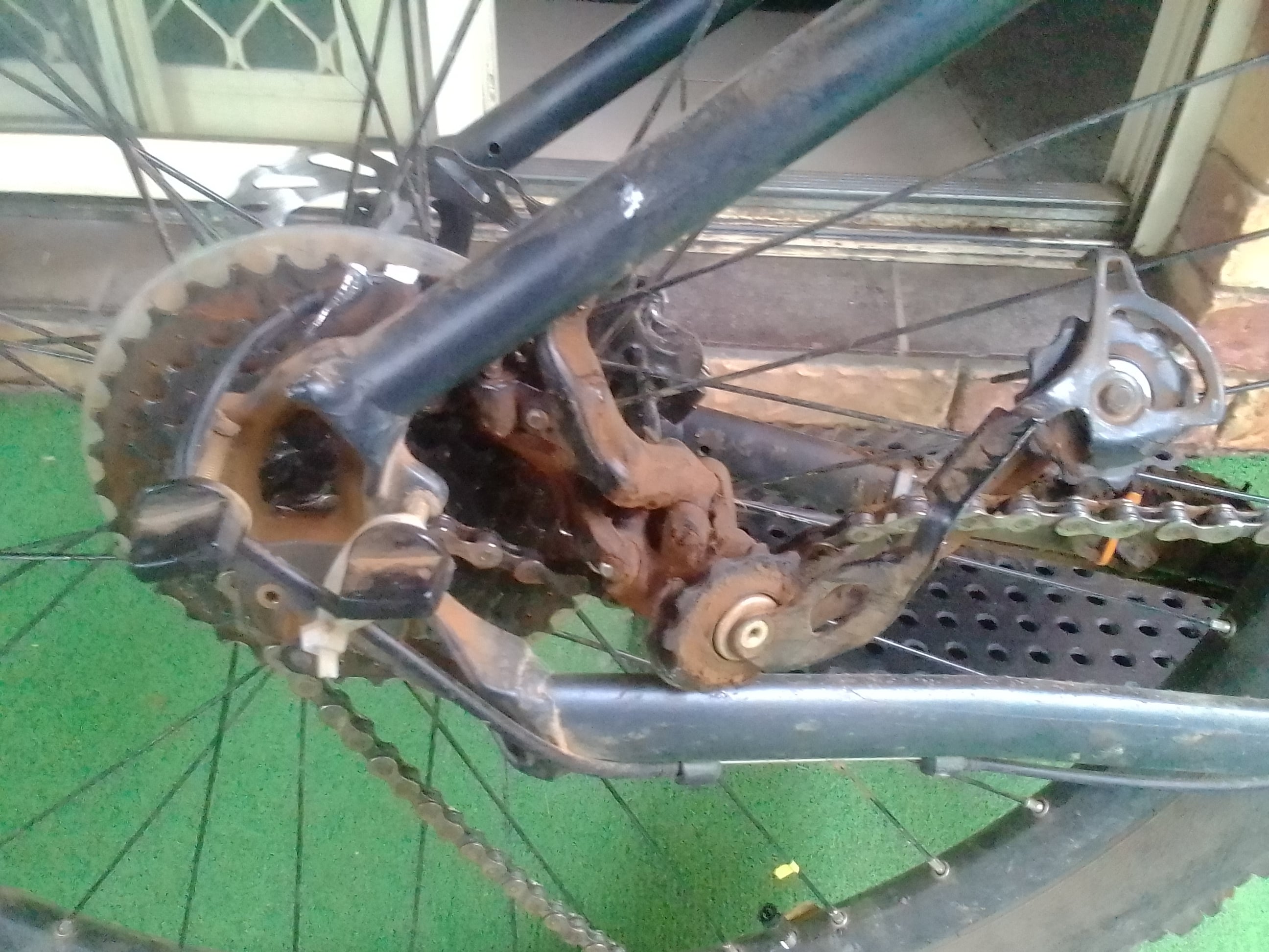

I snap off the derailuer's if applying power in a high gear, sometimes chains], [110nm torque] , i just avoid the top gear and ride low to middle gears, thats enought to beat $15000 bikes:D
