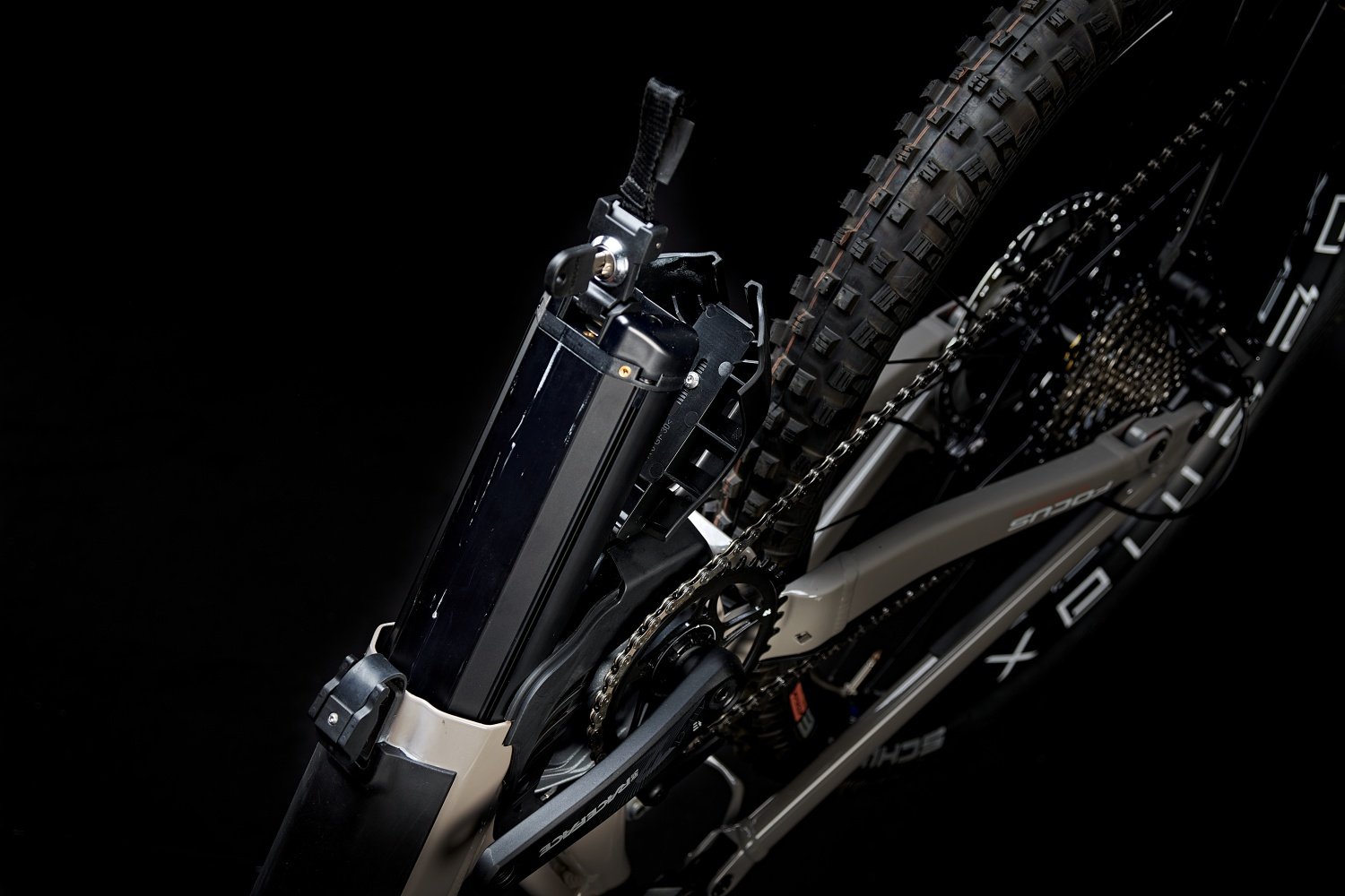

All bikes have detachable batteries, that’s not a given for bikes running the 750 Wh battery. There are a few challenges implementing this big battery, such as weight and space. Focus decided to tilt the front of the motor upwards, making room for the battery in front of the motor. I like this solution, it allows for a detachable battery through a small opening at the bottom of the frame. This opening requires less reinforcement to maintain frame rigidity, thus reducing frame weight.
FOCUS-JAM2-SAM2-Iven-Olly-Spain
FOCUS-JAM2-SAM2-Staffie-Marjam-Karenza-Spain
The battery is removable through a hole in the bottom of the downtube
Some would argue there is a downside to tilting the motor upwards though. It makes the bottom bracket area quite chunky. If you’re paying a five digits figure for a new bike, you of course want it to be sleek, skinny, shiny and whatnot.
The upwards tilted motor plus the battery makes the bottom bracket area look chunky.
