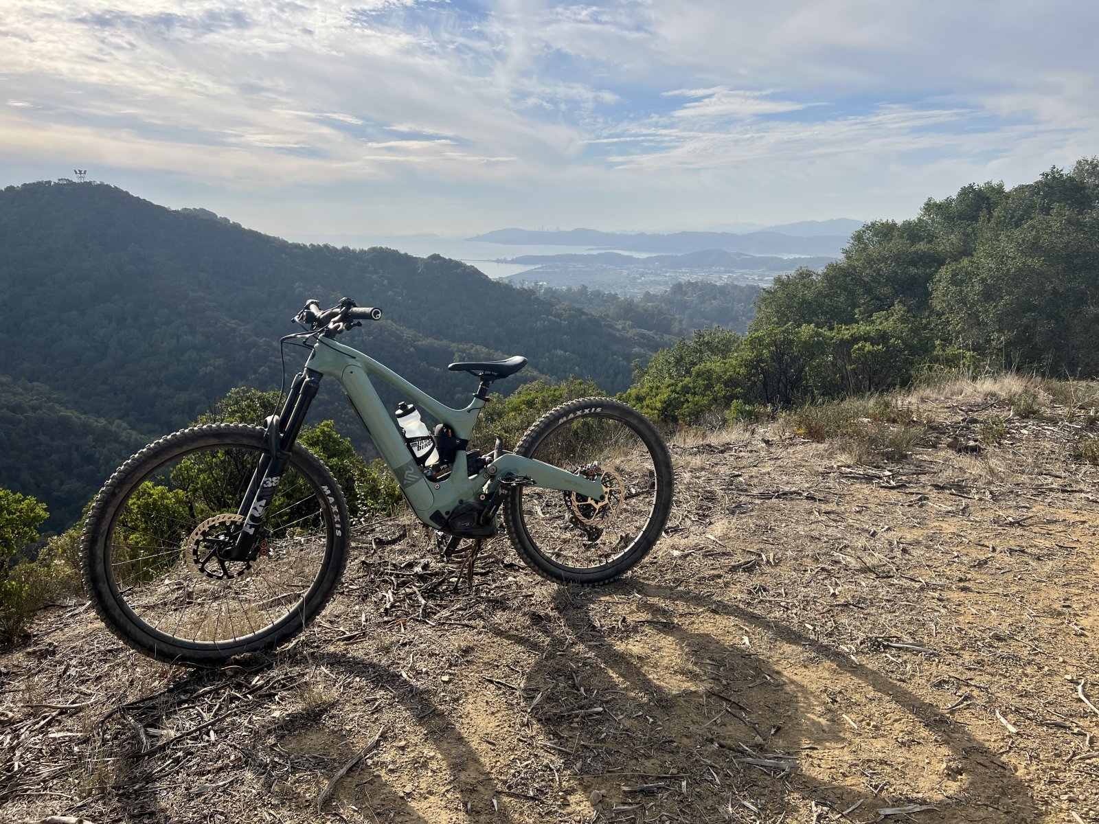

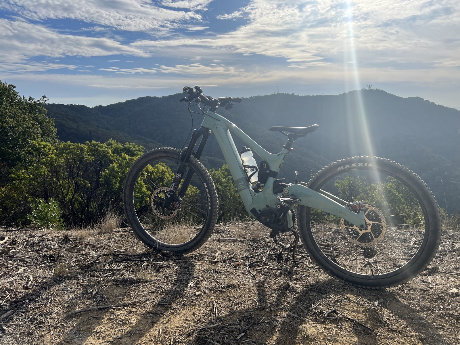

Thought I would share as I picked my OSO up last week and have just shy of 100 miles on it. I am coming off of a very modified 2020 Levo that was slacked to 64.2 and had 160/180 travel, Saint brakes, and 220 rotors F&B. It is a very capable bike.
First off, the Ibis is super stiff, super playful and fast as can be. Ibis nailed the tune in this thing. I went down a size to a medium because of the reach numbers as well as wanting mixed wheels. It climbs as well as any trail bike and the short chainstay and mixed wheel allows it to crush switchbacks and turns in quickly at all speeds. Not the longest wheelbase but it seems stable at high speed....so far.
It's not perfect at all. They totally missed it with the controls, a super busy cockpit (I eliminated the Kiosk), max 2.5 tires, FOX 38 Performance (really for that $$), and the Maxxis Dissector rear tire (just my opinion). I added AXS shifting, Magura MT7 HC3 brakes, Ergon saddle and grips. I have Schwalbe tires (big Betty/majic Mary) on the way as well as a Diety Highside bars w/50mm rise and a Renthal stem. The cockpit stuff is all just a personal feel and fits the places I ride well.
I'll add more as I get more laps in but in closing, I love it!
