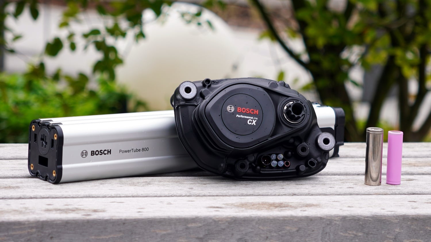

Let me start by apologizing to Bosch for calling the new Performance CX motor the “gen5”. They insist the new motor is called the “BDU38”. I‘m not sure that’s going to stick as it’s referred to as the “gen5” by several brands releasing a new bike these days.
The batteries too have been updated. Thanks to improved battery cells, we get a new PowerTube 600 battery that is more than 600 g lighter than the old PowerTube 625. And the new PowerTube 800 is about 500 g less than the old 750 battery.
There are 3 batteries for the new Bosch CX motor, all using the 5.6 Ah cells. The battery packs all share the same battery connector. This means you’ll be able to use either battery in combination with both the SX and CX gen5 motors. Provided there is room in the frame of course.
It’s nice being able to combine the parts as one wish. Some manufacturers will let you buy a Bosch CX powered bike with the 400 Wh battery. Combine that with the PowerMore 250 range extender and you’ll have a light and strong bike with extra range when needed. Or you could combine the PowerMore with the big battery for 1kWh+ capacity.
Bosch decided the new PowerTube batteries needed to be grey, or silver. And that’s a wise decision. Having the raw metal finish means they won’t pain the battery. That makes the battery cheaper, easier to manufacture and it’s a bit better for the environment. I can’t think of any upsides to painting a battery that is hidden inside the frame.

Motor and battery highlights
So, the new Bosch Performance CX looks similar to the previous one, which Bosch says isn’t actually named gen4 but “BDU37”. The new motor has a maximum torque of 85 Nm and peak power is still 600 W. But the noise level is improved, and the weight has changed. There are a few numbers floating around, but I believe 2.85 kg is correct. That’s about 100 g less than the previous Performance CX.The batteries too have been updated. Thanks to improved battery cells, we get a new PowerTube 600 battery that is more than 600 g lighter than the old PowerTube 625. And the new PowerTube 800 is about 500 g less than the old 750 battery.
Next generation motors and batteries
The smaller and milder Bosch Performance SX was launched just over a year ago. It had only two motor mounting points, one less than on the CX gen4. And it was a sign of what was to come. The new Performance CX has the exact same mounting points. That’s bad news for backwards compatibility. But Bosch says the new way of mounting the motor should bring advantages as it’s easy designing a frame around it. And I guess this explains much of the weight reduction.There are 3 batteries for the new Bosch CX motor, all using the 5.6 Ah cells. The battery packs all share the same battery connector. This means you’ll be able to use either battery in combination with both the SX and CX gen5 motors. Provided there is room in the frame of course.
