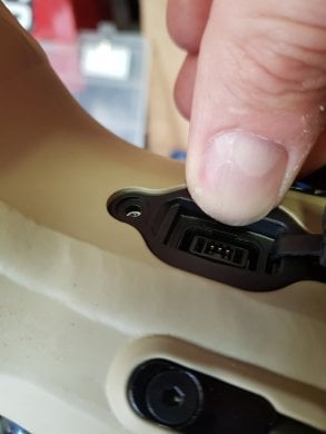

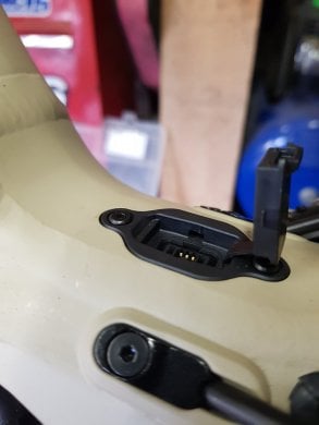

Update.
I fixed my bike.
The charging port was sat to far down in the frame and wasnt letting the charger to seat all the way in.
Very minimal.
I raised it about 1mm using 2 o rings.
Sorted.
Brand new bike though....
