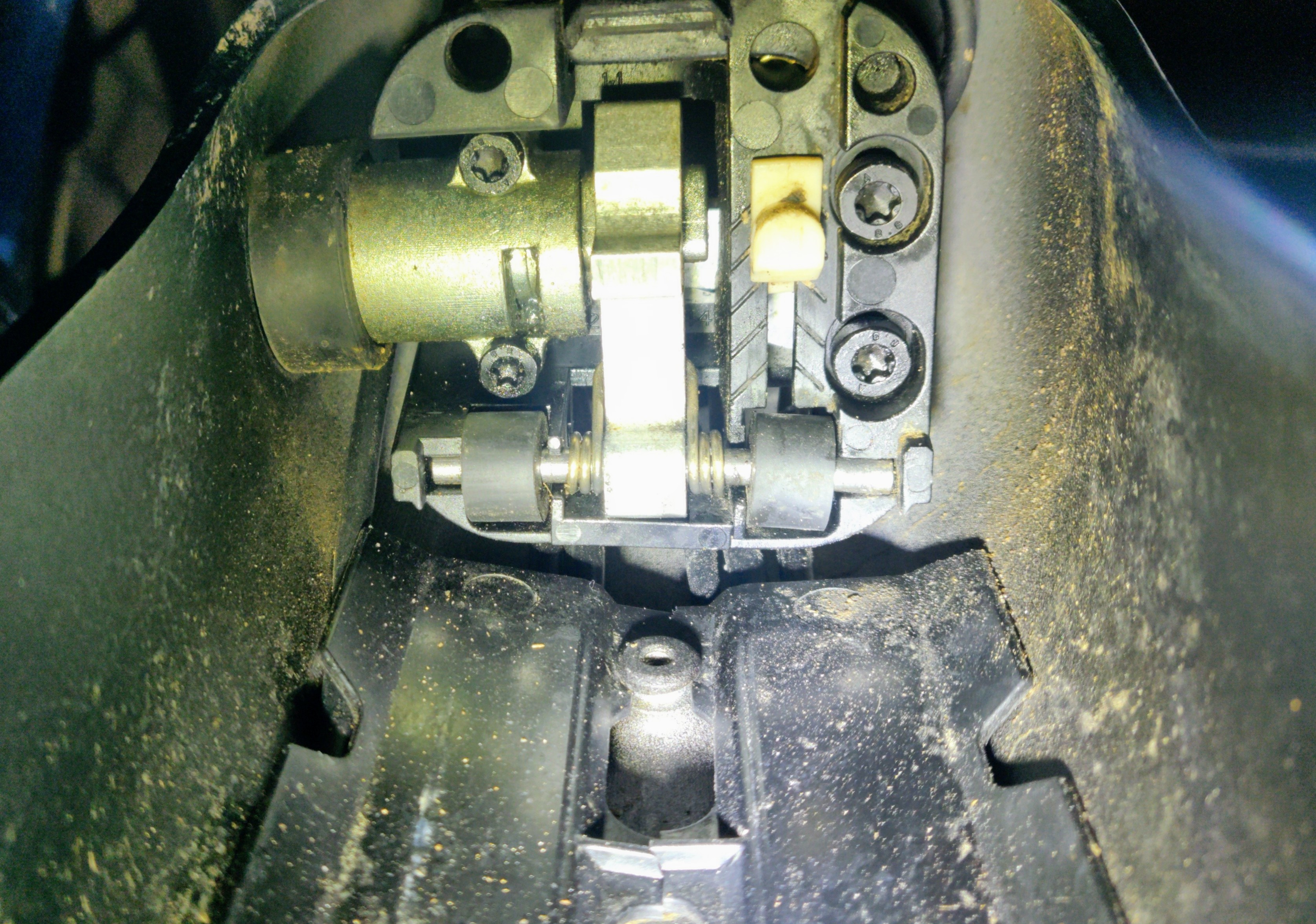

I have a Scott Ransom eRide 920 2021 bought in December, this weekend I went to an enduro training camp and have been doing lots of jumps and lots of technical stuff that I haven't done before.
Sunday I noticed the battery began to rattle, since I have bought the bike I noticed that the lock hub wasn't centered with the hole in the frame, I tried to fix it on the trail and it improved but not by much.
Is there a guide available on how to mount the battery lock & support (the part with the connector) properly so they don't rattle and stay in place?

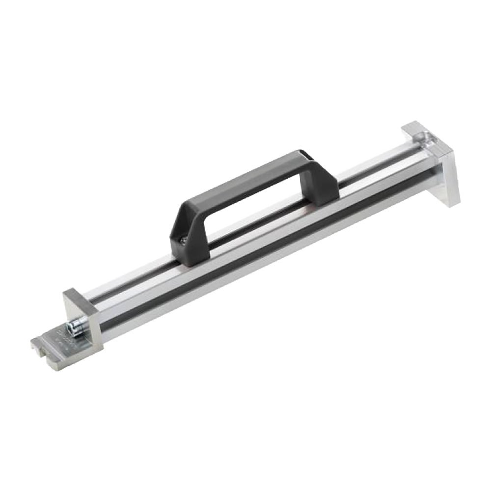

Thank you for the info, but I have no Scott (or other ebike) dealers within reasonable driving distance and that tool is over 100euros which seems a bit much for what it offers.
Is there another way I can do this myself? Or maybe a DIY version of that tool?
Possibly knock something up with a piece of wood I expect - at least to get a quick reference.
Cut it the length of the battery then you can make allowances for the fittings.

Well, the rattle seemed to be headset which got f*cked on a minor crash. That really annoyed me, I bought a new headset but, since I packed the old one with grease it's not making so much noise and I'll probably replace it over the winter.
Regarding the battery issue, I have tried various ways to set it up properly, the best I've come so far is with the battery itself.
You loosen the bolts that keep the locking mechanism in place and push everything down, then place the battery on the bottom support (like you usually do when putting it the bike) and begin to slide it in slowly, at this point you have to turn the key so the battery can slide into place.
The battery will push the support up as you slide it in, after it is beyond the lock (that requires you to turn the key) you push it a little further (2-3mms) then stop, you do NOT want to push the little clip that keeps battery in the "intermediary" position all the way in since your battery will fall the next time you unlock, instead of hanging on that little clip (don't ask me how I found this out). Now tighten the screws a bit and remove the battery.
It's possible that at this time the battery is too tight and it might not fit smoothly, you need to mark this position (with tape/marker/etc) and just move the lock a bit (1-2mm) up.
There's a bit of trial and error but you should get it on in like 10 minutes, always pay attention so that the battery doesn't fall off the frame when you unlock it with the key and it stays in that intermediary position hanging by the clip.
Once you're happy on how it sits tighten the screws, if the battery cover doesn't sit right with the frame now, you can partially unscrew the six cover screws (with the battery mounted on the bike) and slide the cover so it's flush with the frame then re-tighten them.
