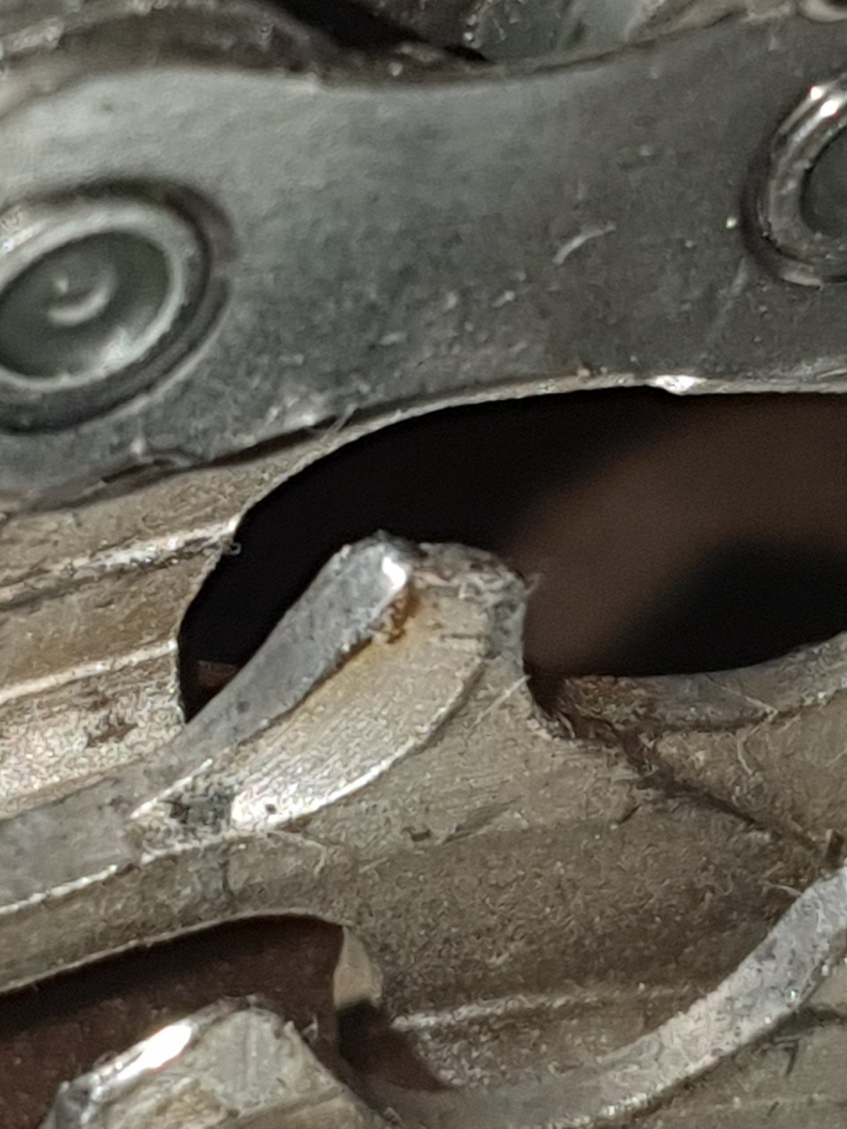

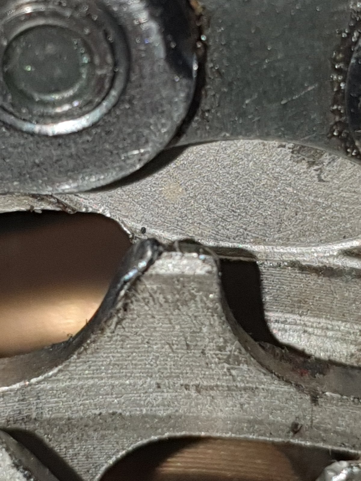

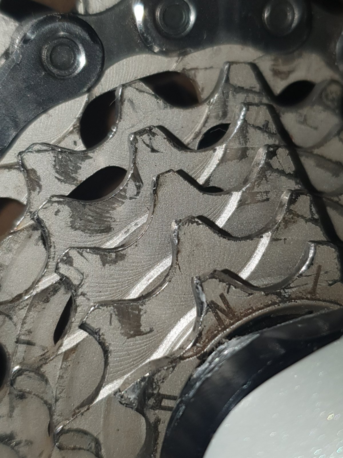

So im having some trouble with my Bafang Ultra powered e22 drivetrain. The problem is the chain skipping over the teeth on the cassette under load. The top half of the gear range all do it to some extent now. With some gears almost un-rideable with motor assistance. The cassette teeth now have visible damage/wear. The teeth are rolling over on the load side. I've put less than 50km on the bike from new, and have already trashed this cassette after about 40km.
The combo is :
Chainring - Praxxis Steel E-Ring 36t. (Brand new)
Chain - Shimano XT 12 speed. (Brand new)
Cassette - e13 Helix 12 speed. (Used, approx 500Km)
Rear mech - Sram GX Eagle. (Used, high Km)
Shifter - Sram GX Eagle. (Used, high Km)
I used the 12sp drivetrain when i built the bike, because I already had most of the components in my spares box. The e13 Helix cassette is aluminium for the 2 lowest gears, and steel for the 10 highest gears. I figured the steel part of the e13 cassette would be tough and long lasting. Boy was I wrong. It must be made from very low grade steel, as it has worn so heavily in such a short time.
Now I have the dilemma of what to do moving forward. I can purchase the individual parts of the e13 Helix cassette seperately. So I can replace the worn steel section. But this won't stop it from happening again in another 40km.
I am concerned that perhaps the derailer is worn out, and not keeping enough chain tension on the drivetrain.
I think the best solution is to get a new complete drivetrain groupset. But I dont know what to get. I want something that will take the power from the motor. I don't need as many gears as it has now. With the motor assistance, I find I probably only need half as many, and I wouldn't need such a large range either. And something that won't break the bank would be nice aswell.
13,860
20,549
There could be a combination of factors which may not of helped.
Derailleur adjustment with the b screw could bed limiting wrap around, so inviting more early wear on the cassette.
Using a pre worn cassette with the new chain. It may already have been semi worn depending how/where you ride, how you clean/lube, how you change gears. A new chain on a word cassette will just wear the cassette even faster (depending how worn the cassette is).
Riding style. A lot of people who are new to emtb think they can change gear under power. Yes, you can yo a degree, but it takes time to learn how much and how long to back off before you change gear and how to reapply the power once you change. For most this just becomes second nature, for some they still slam through the gears under full load and just destroy their cassettes.
Yes, the 12 speed Shimano cassette does say you can shift under load. But there's still a degree of sympathy needed and that's on a bike without a motor.
None of that's saying it's what you do. The cassette maybe second hand. There could be many other factors or a combination of some of the above.
A general consensus is that something like a 10 speed setup is more than adequate for most emtb use, which is cheaper and stronger. Though a Shimano 12 speed if looked after and ridden correctly can still give you thousands of Kms of life.

I did have the B screw come loose on my second ride. Once I noticed, I correctly adjusted it using the plastic Sram guide tool. I'm wondering if the damage happened at that point. And now that it is damaged, it's just skips constantly.
I did learn pretty quickly not to shift under load with the bike. The shifts are brutal. Like flatshifting a sequential race box. Except, the bike drivetrain isn't as tough.
The e13 cassette is my own, I pulled it off my other bike when i built the e22 up. It had maybe 500kms on it, if that.
