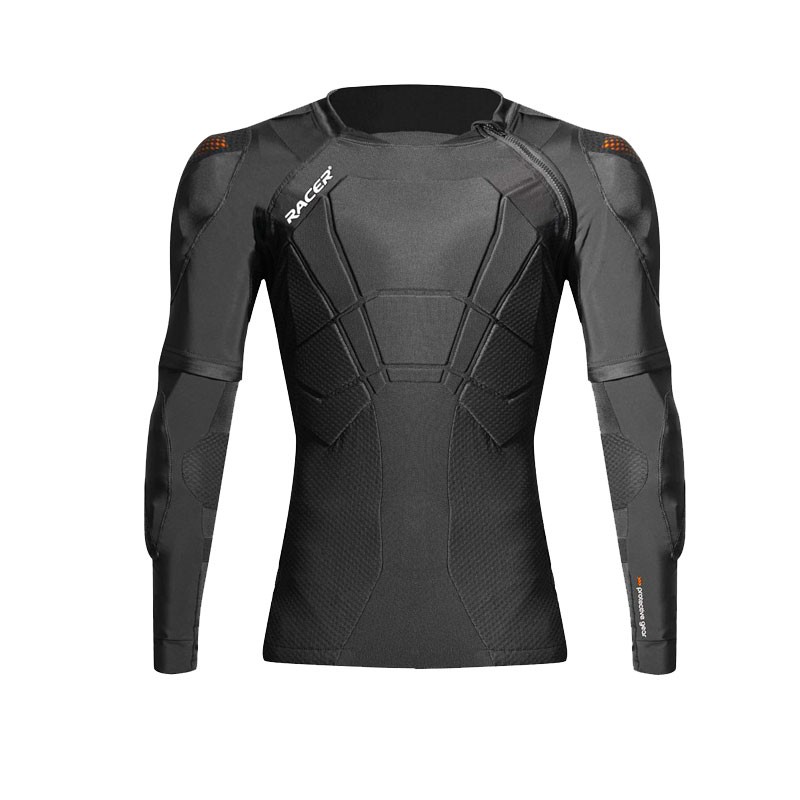

Racers (Racer Gloves) second version of their "Motion Top" with lots of improvements.
There are dozens of different "body armours" out there. They all pick their own line through the different compromises you have to make between protection area, protection level, weight and heat management.
Racer seem to have gone down the route of trying to offer good protection, in specific zones, whilst putting it together in a package that's light enough and cool enough to wear every ride and not have to make the decision to wear it or not.
On the whole, they've succeeded !

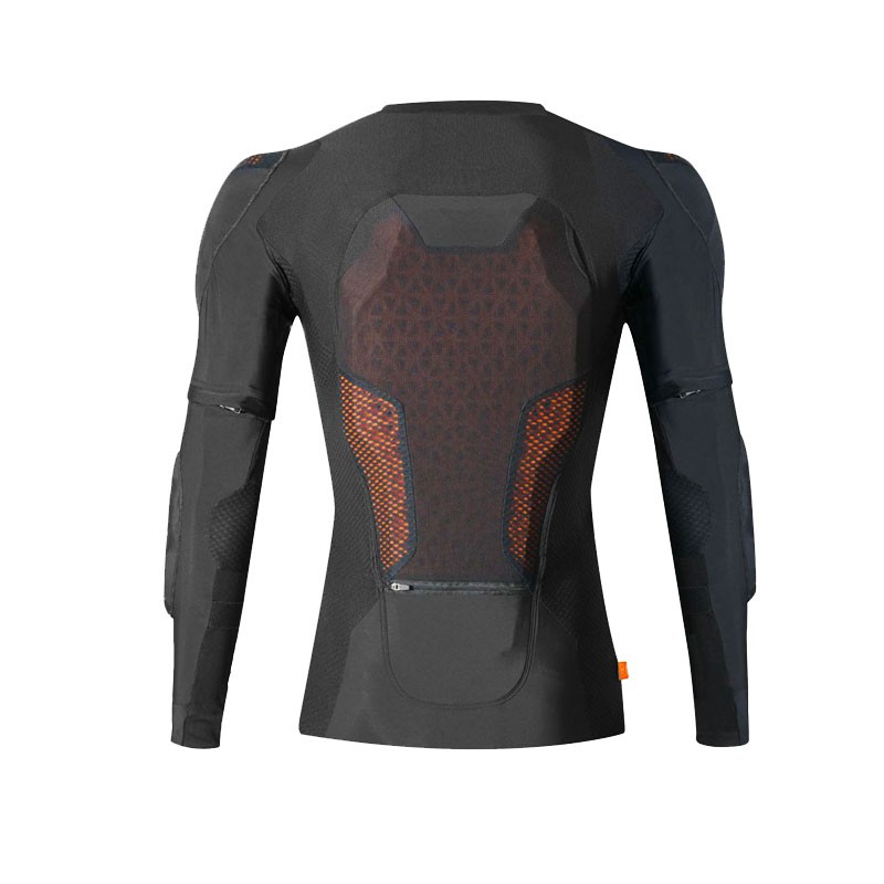

The Motion Top 2 has a D3O BP4 L1 back protector - this is the latest D3O back protector and is considerably lighter and is designed to offer more air flow than previous versions. As it's lighter and cooler, they've not had to do the usual thing and make it overly short to make it usable - so you get full length back coverage.

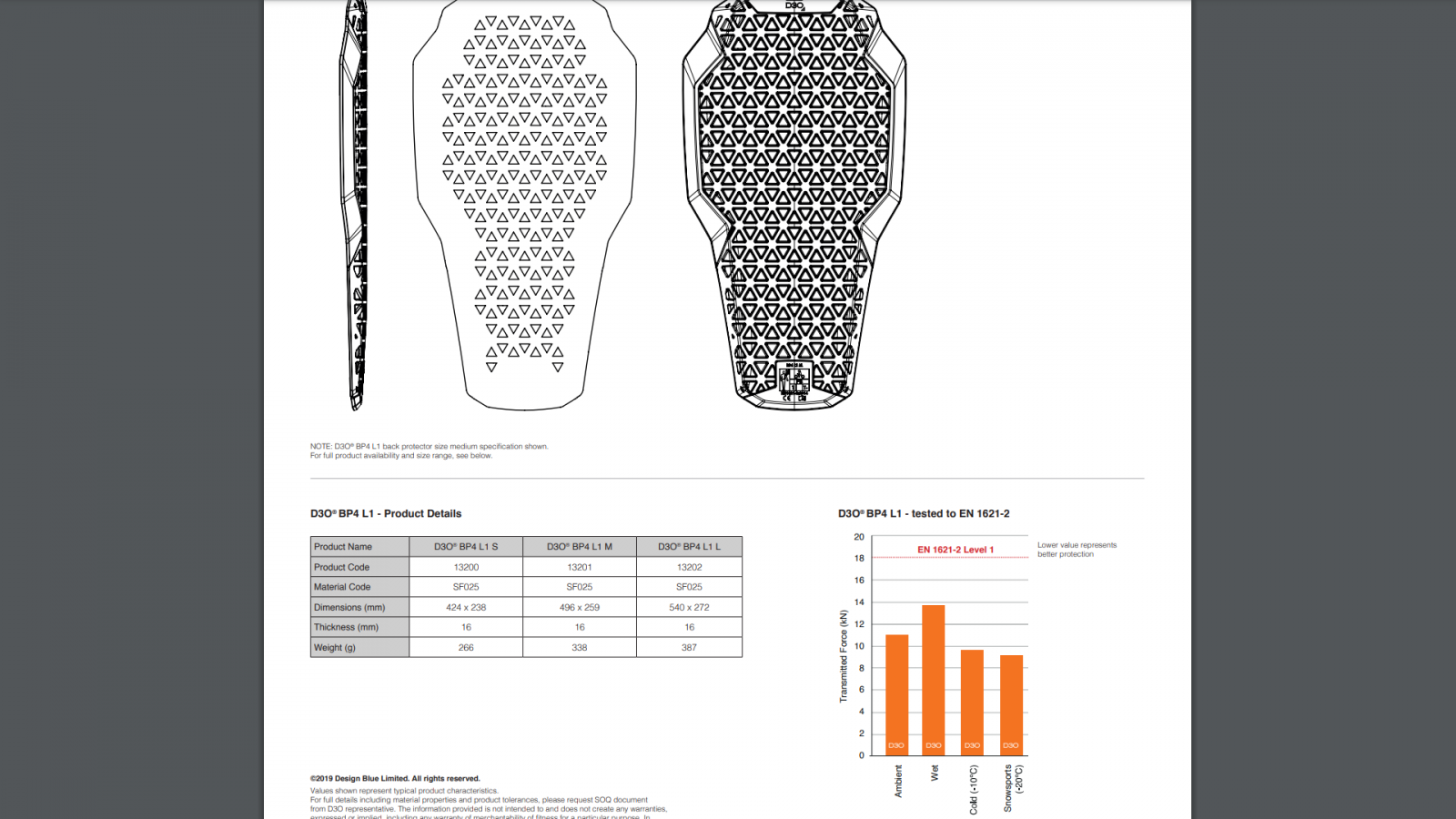

The other good thing with the BP2 is the dimensions (except for thickness) are the same for the Level 1 and Level 2 protectors, so you could swap out to a Level 2 protector if you wanted to.

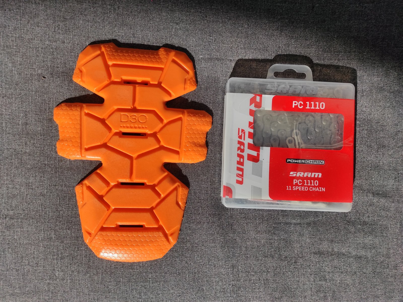

The elbows use unformed D3O pieces. If there's one thing I don't like - it's these. For me, they feel too thin and too small. If you're used to anything more protective on the elbows, these don't really feel like they offer sufficient area coverage or protection. That said, I did smash my elbow repeatedly against the sharp edge of a worktop and it didn't hurt ..

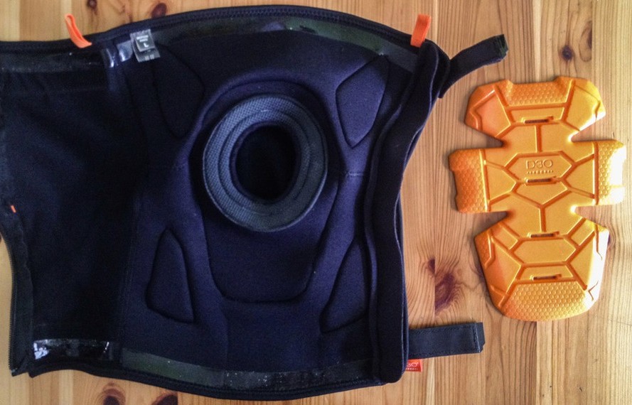

The pad is the same pad they use in their motion knee pad.
The knee pad receives similar feed back with people not feeling like it offers sufficient protection.

The jacket zips on, with the zip running up the left side. The zip is decent quality.
It's very form fitting all over.

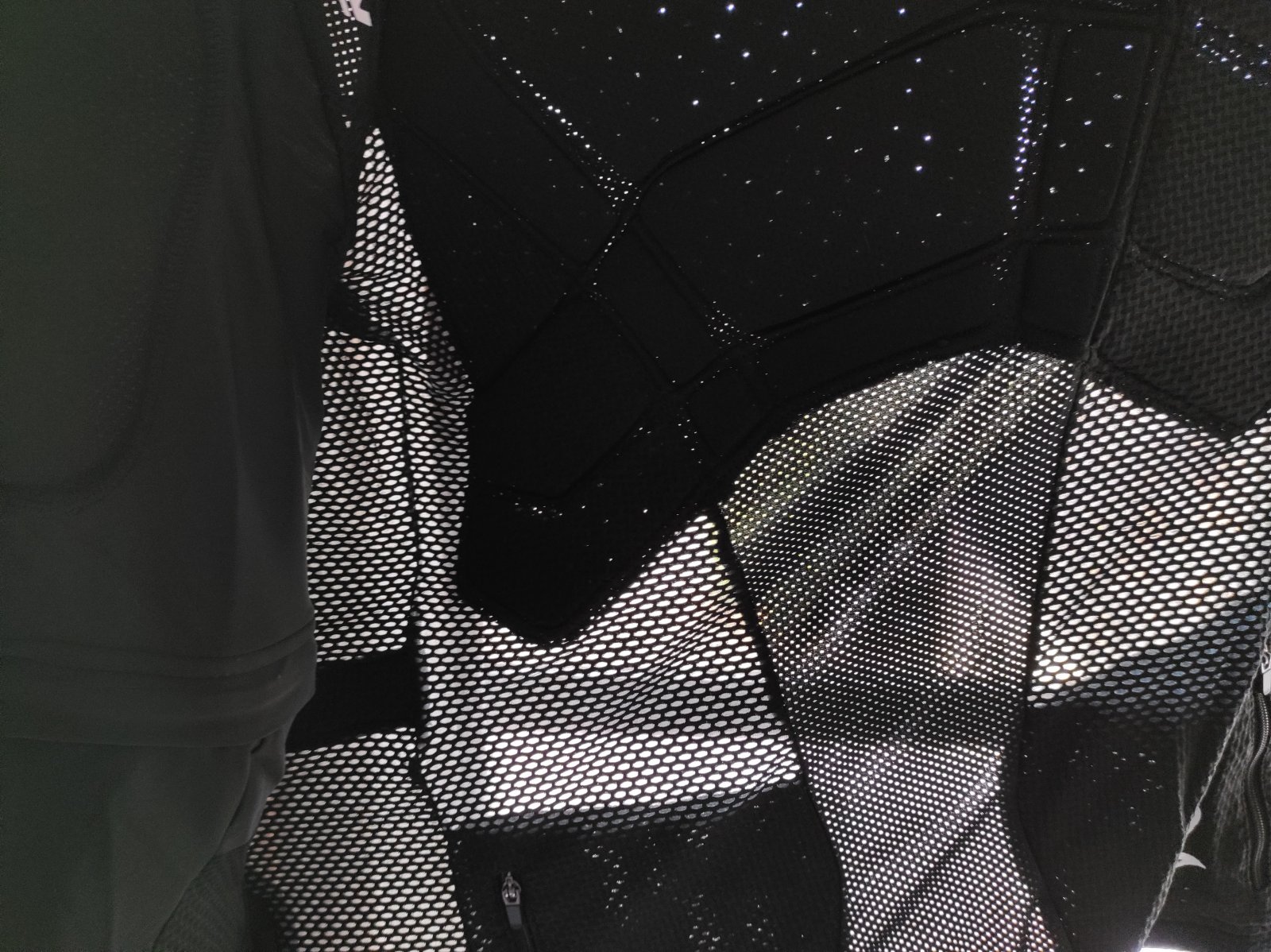

The main body being two different types of mesh, which breaths well but isn't see through - so you don't look like predator if you ride only wearing this top without a shirt.

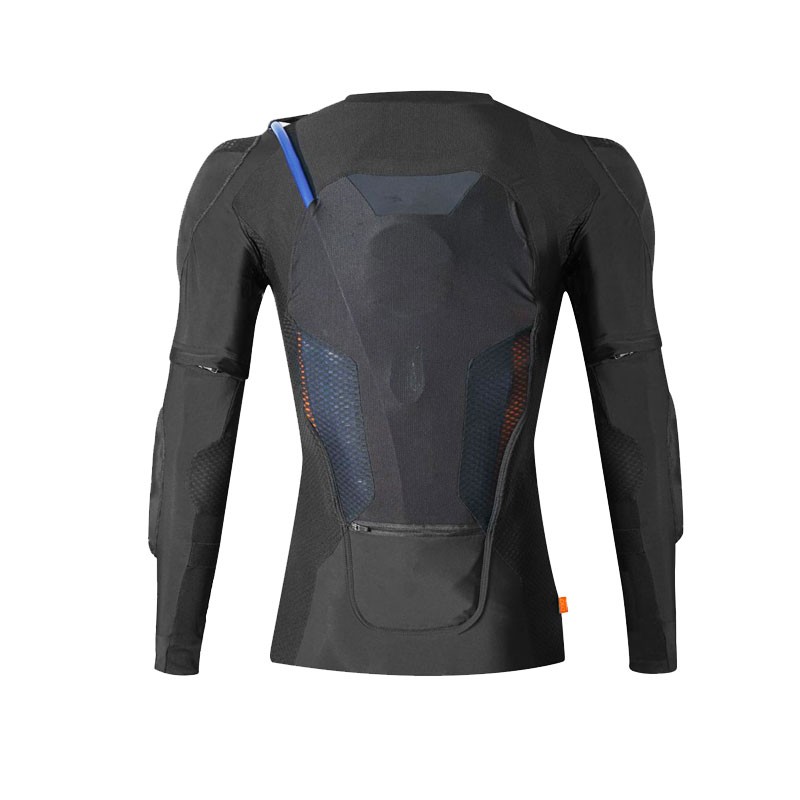

If you remove the back protector, you can also insert a hydration pack (not provided) and then put the back protector back in. The space will take upto 3 litres, but if you put more than about a litre in you start to notice the weight moving the jacket around. I'm around 70kg's and in a Medium. It might be if you're bigger, things stay in place more.

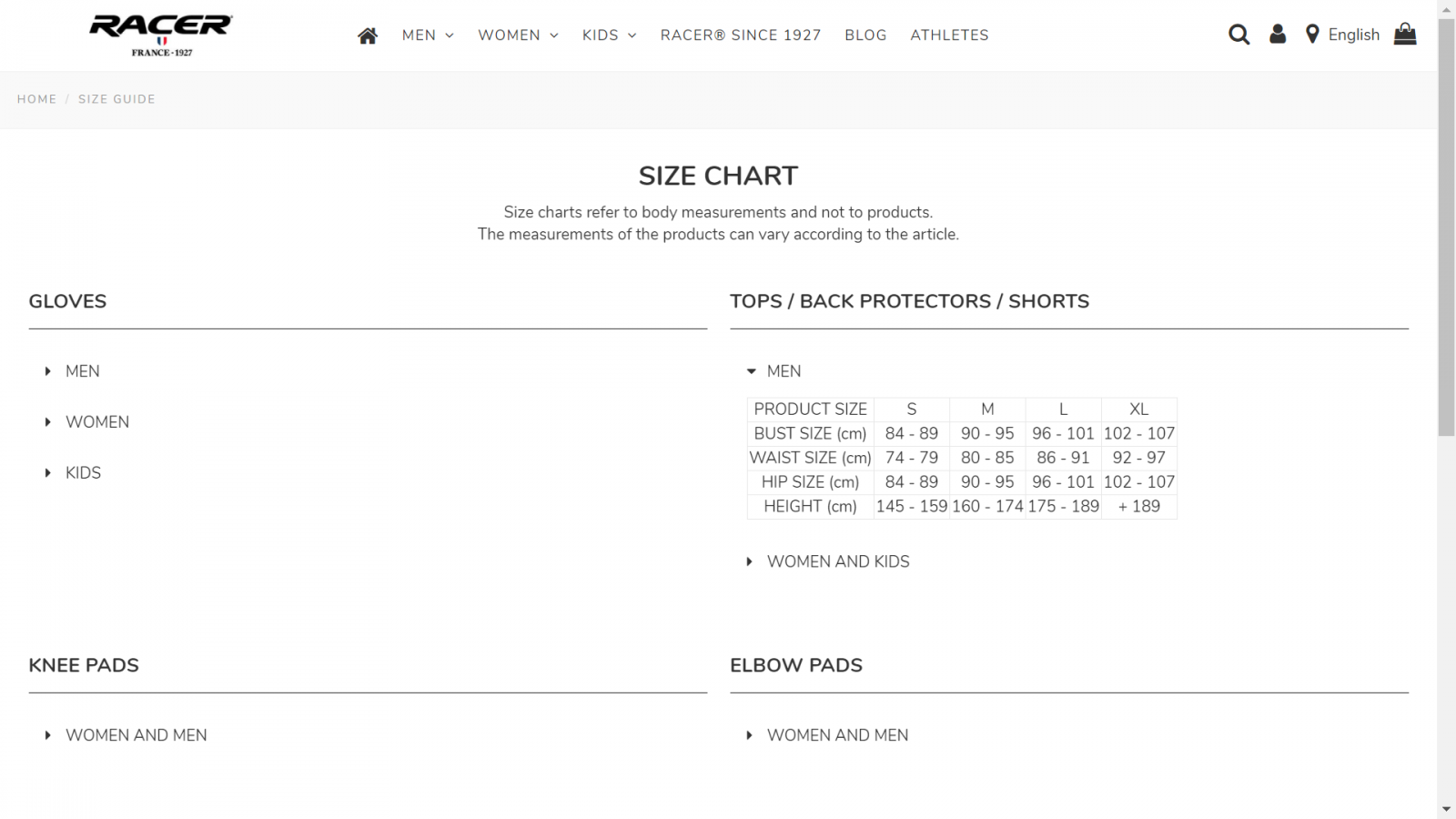

the racer motion, my chest is 100cm but it says large is 97cm, will that be okay for me to get a large?
£179....
Looks like you should be good in a large..
Looks the same in French, sometimes places seem to mess sizes up on their translations ..
