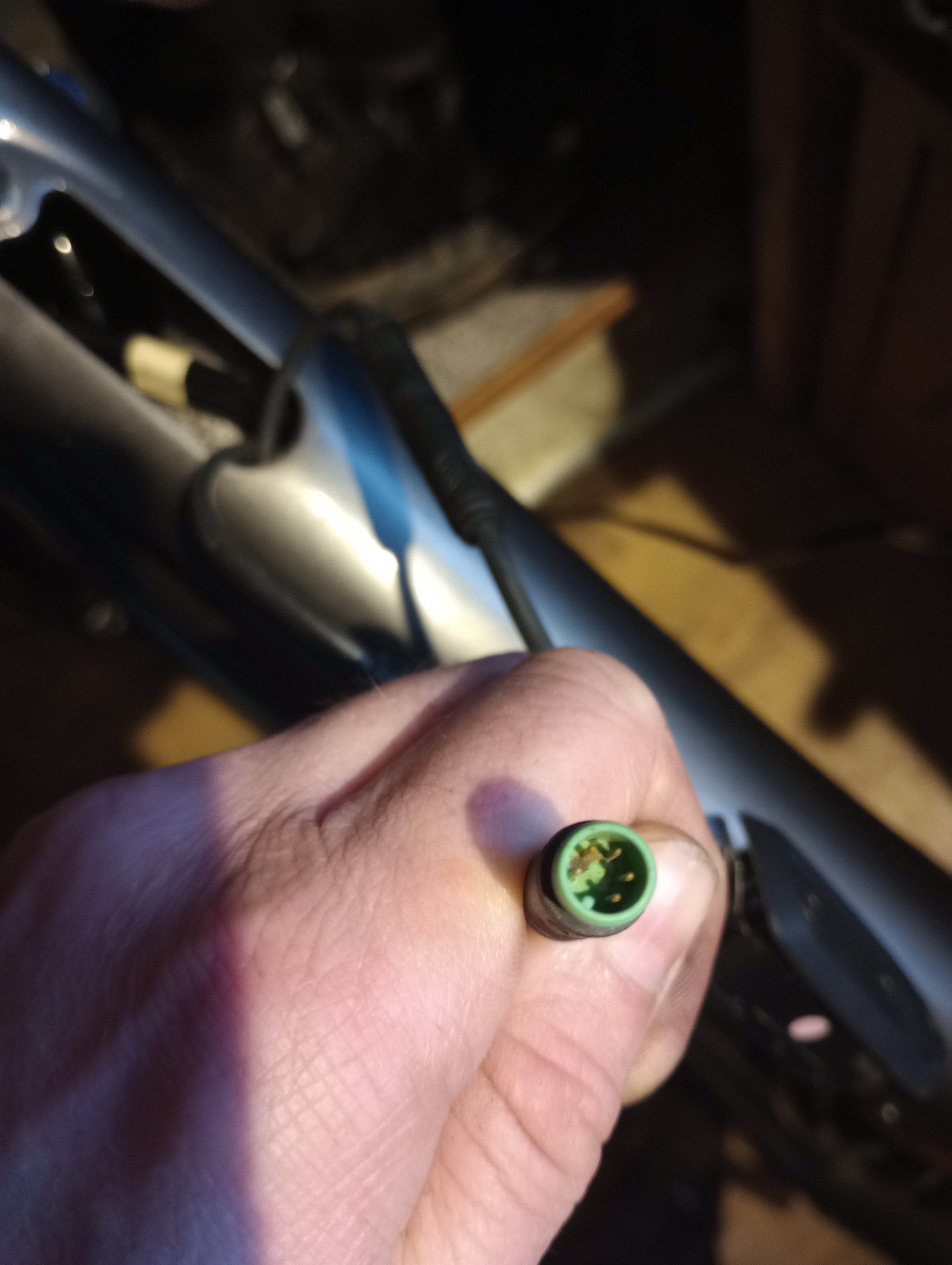

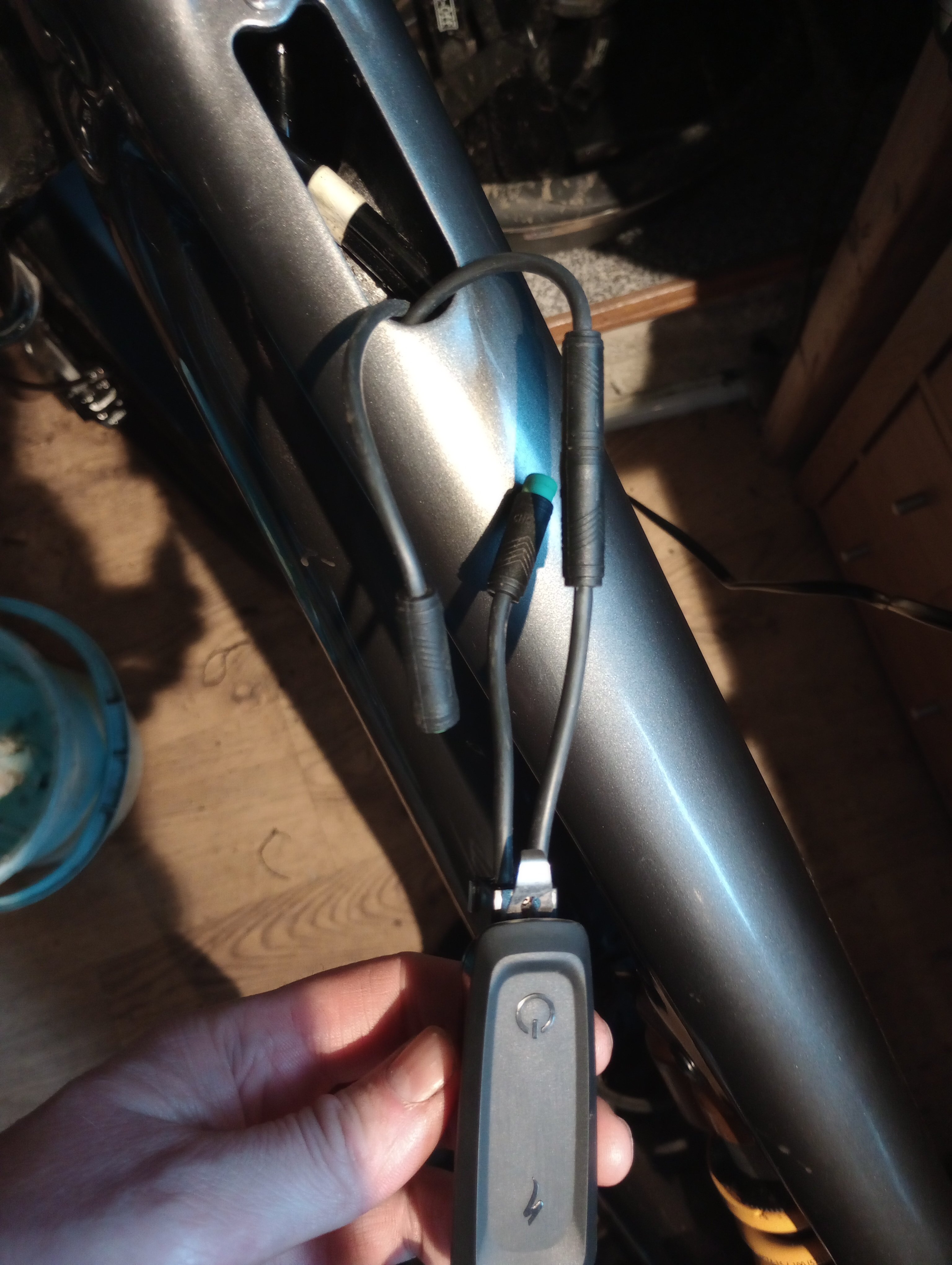

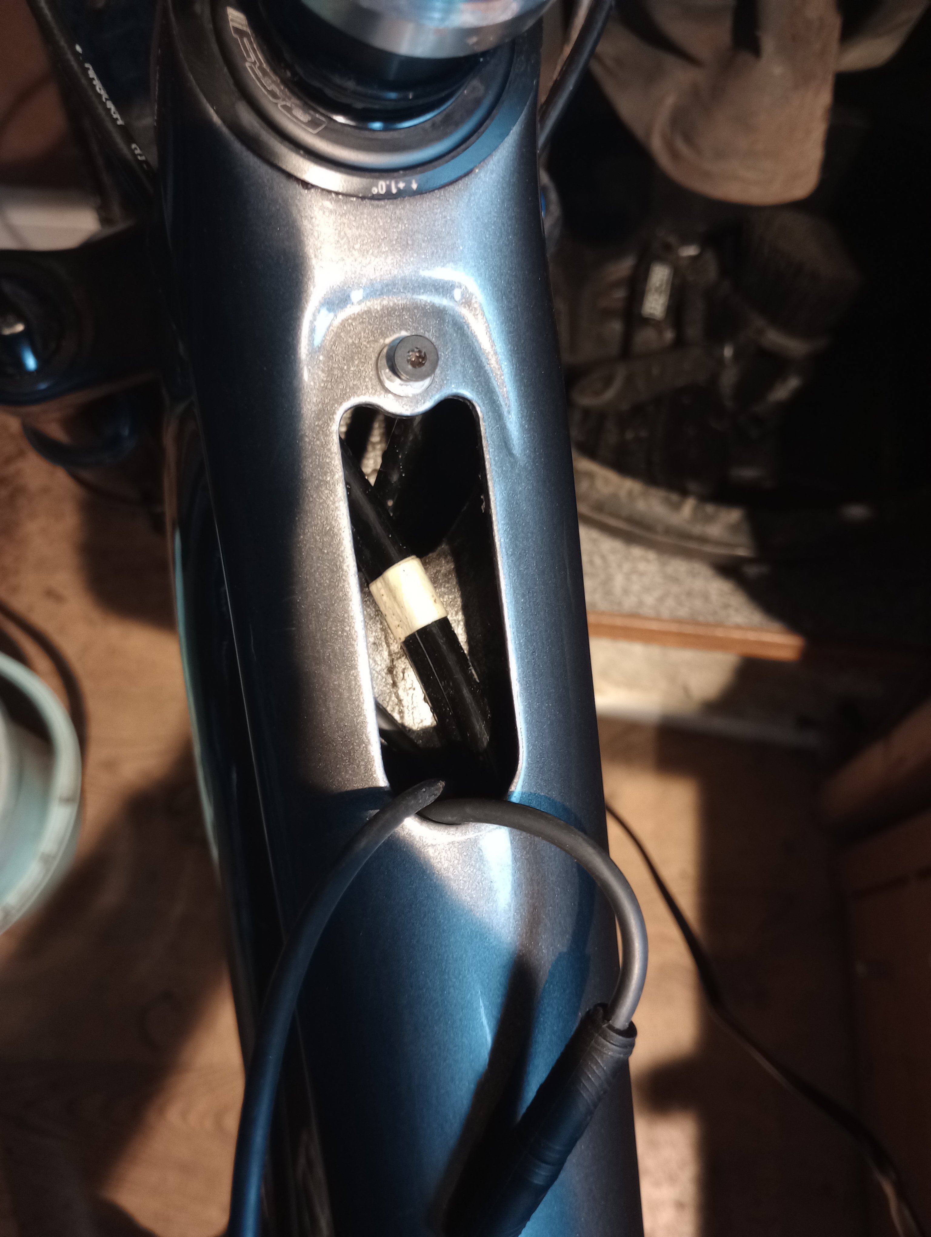

This is the cable I'm referring to, I do find that water gets into the downtime from somewhere, maybe from the cable holes. The guy in the shop said it's a good idea to open this up every so often to let air get it and dry it out. One of the electrical connectors is slightly discoloured, I've added a few images below.
IMG_20240405_184501925.jpg IMG_20240405_184712569.jpg IMG_20240405_184727812.jpg IMG_20240405_184547798.jpg

your test does suggest a faulty battery but there is still a chance the power cable is responsible. On the gen 2 levo the 4 connections are + and - and 2 signal wires ( part of the CAN). I dont know exactly how the CAN operates but it is the CAN that enables amps to flow from the battery to the motor when the right conditions are met ( bike on/ torque sensed/speed sensed.....regulated by mode selection) so it may be the case that a faulty cable ( intermittent short or HR disconnection) is leaving the battery in the wrong state when the fault occurs......and that leads to you getting a different test response.
The think a bout specifically a high resistance disconnection ( HR Dis) is that the damaged wire will often transmit current until the system is switched off for a while. Anyway just a theory............ a new cable will prove it right or wrong.

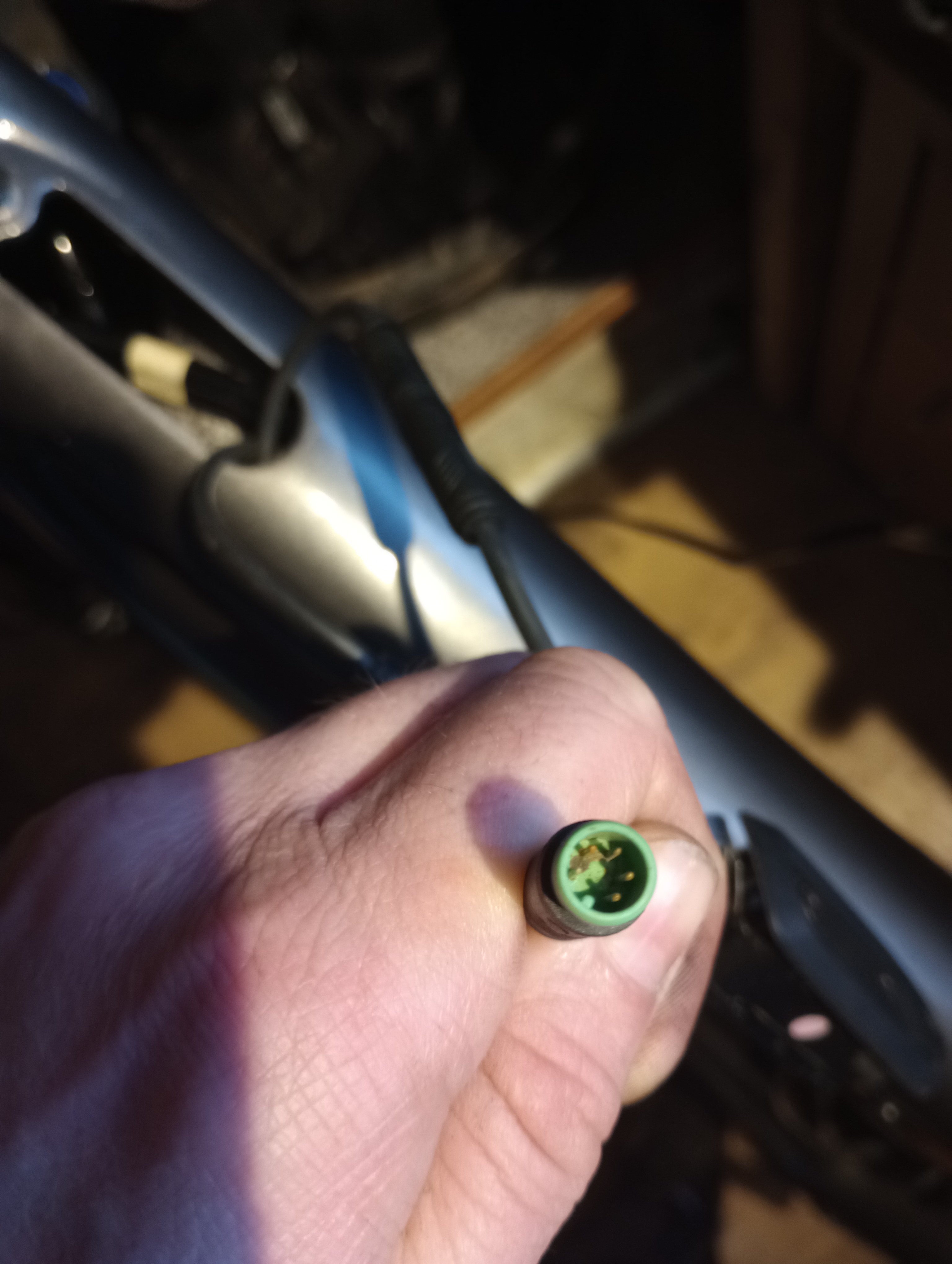

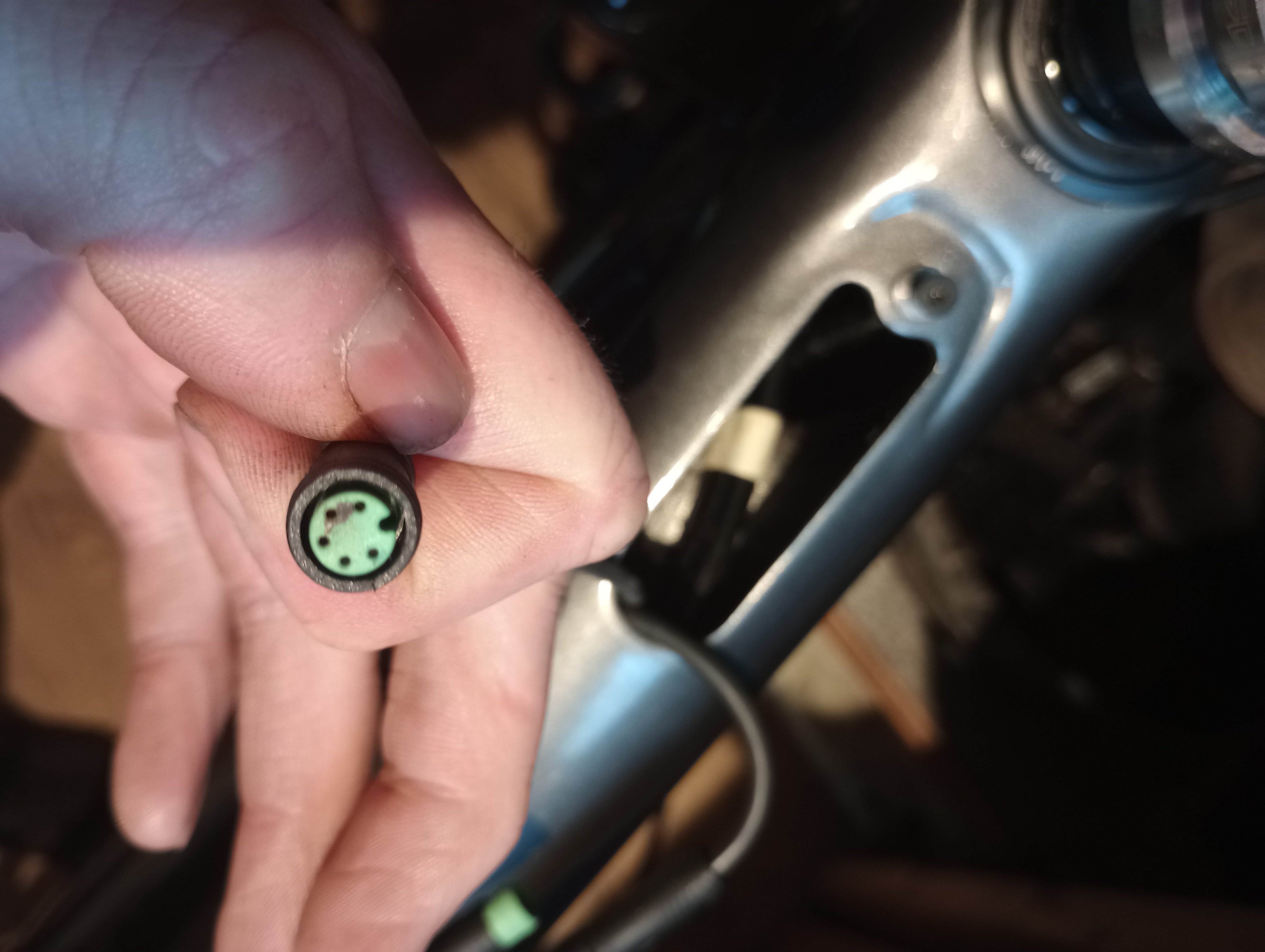

View attachment 137606 View attachment 137607 View attachment 137608 View attachment 137609
On my 2019 Levo I wrapped the TCU with tape ( the TCU comprises a top and bottom half with no seal between them), used liquid gasket to create a seal between it and the frame, and wrapped the tail lead connectors in self amalgamating tape. Again, never had any electrical problems with that bike.

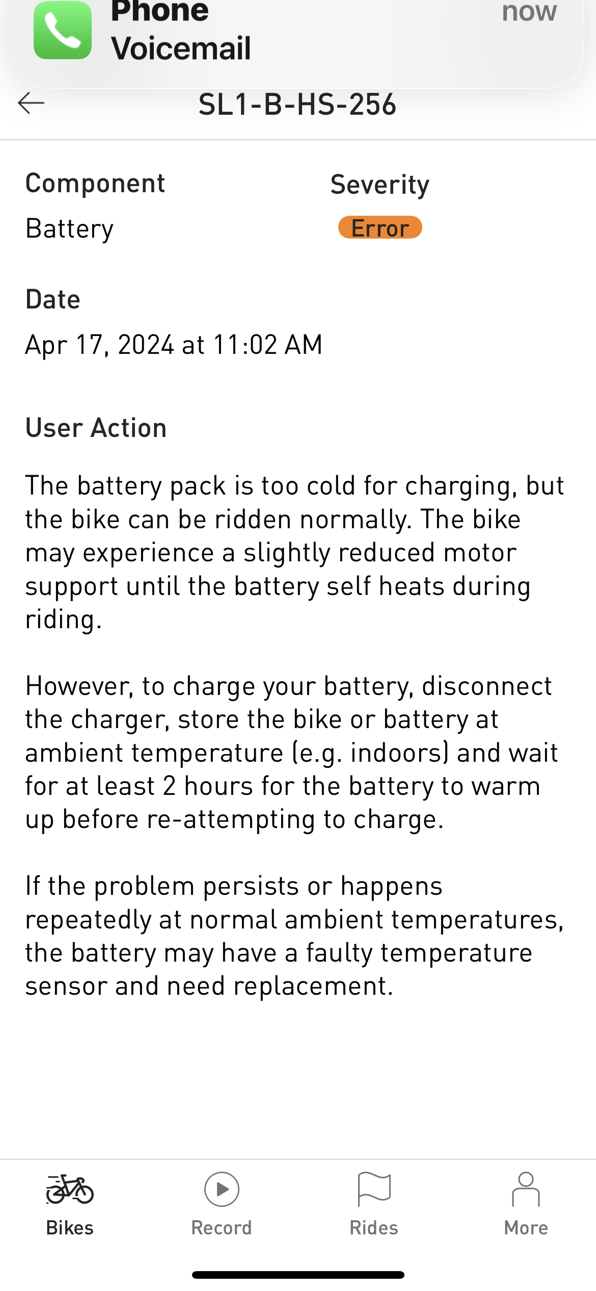

Got this code today finally. Has been months since it showed this code. Would not charge today and is blinking at the display when it turns on and again lost power while riding a couple days ago. They have ordered a speed sensor for it. But now hopefully they will get a battery on the way.
