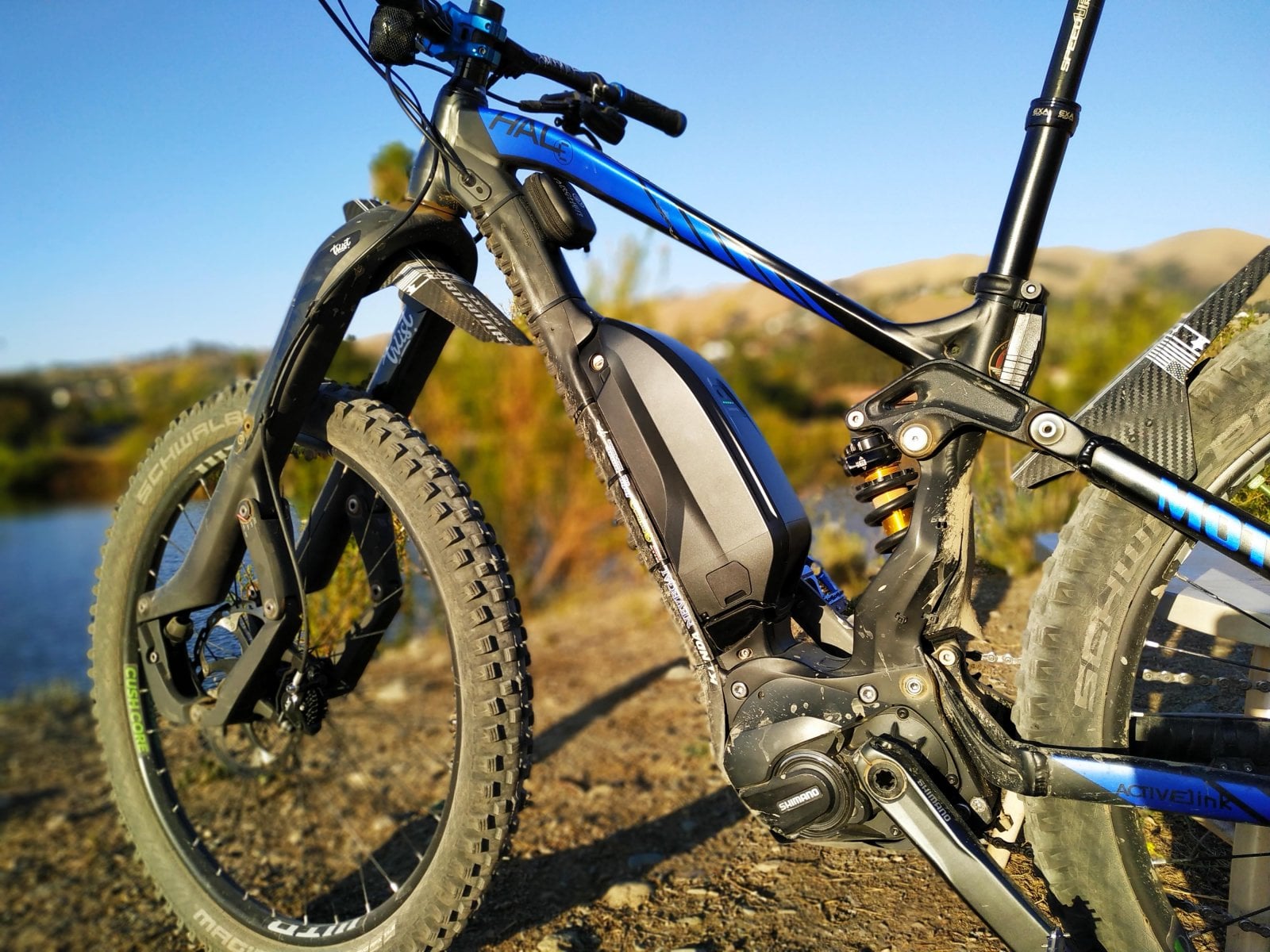

Hi, all. I've been working on my "ultimate build" over the past year or so. Yes, it's dirty, but that's what a mountain bike is supposed to be. The latest addition to the bike was a Trust Shout fork. With a DW-Link rear end, I thought the DW designed Trust fork would be a perfect complement. And was it ever. This bike is totally planted to the ground (until you don't want it to be). I handbuilt an I9 Hydra/Whiskey Carbon wheelset (it's my therapy), swapped out post/saddle (droppers are just a distraction for me), swapped grips (not a fan of the Padloc), and swapped out the E8000 mode switch for an E7000. It's definitely the most fun bike I've ever ridden. Even raced it in a eMTB race. Planning to do a couple enduros next season.
