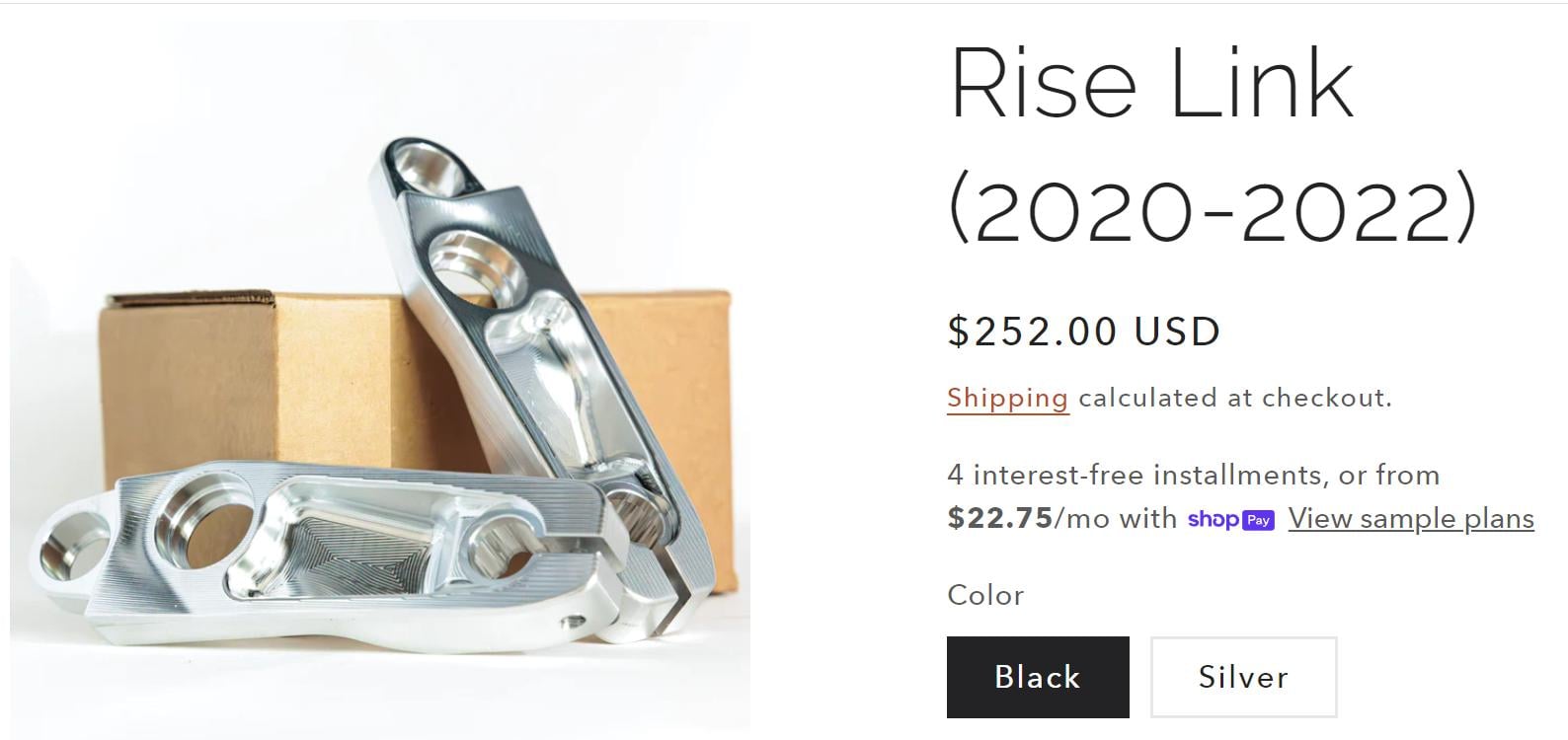

Here's something you may want to look at. The weak link in Orbea's rear triangle design is the pinch bolt clamp on the linkage arms. Under hard turning, the linkage arms tend to flex a bit and open up. There's a company called Cascade Components that has developed a new linkage arm for the Orbea Rise. The linkage arm increases rear travel from 140mm to 150mm. You can use your stock rear shock (210mm x 55mm) with Cascade's design.
The cool thing about Cascade's linkage arm design is that they have developed a secondary linkage arm clamping system that prevents the linkage arms from opening up and shifting on the upper axle. Hopefully no more locking compound, setting pre-load or dealing with creaking from a slipped axle. My thought is the clamp may also help stiffen the linkage arm assembly.
The picture does not show bearings. New Max bearings come with the linkage.

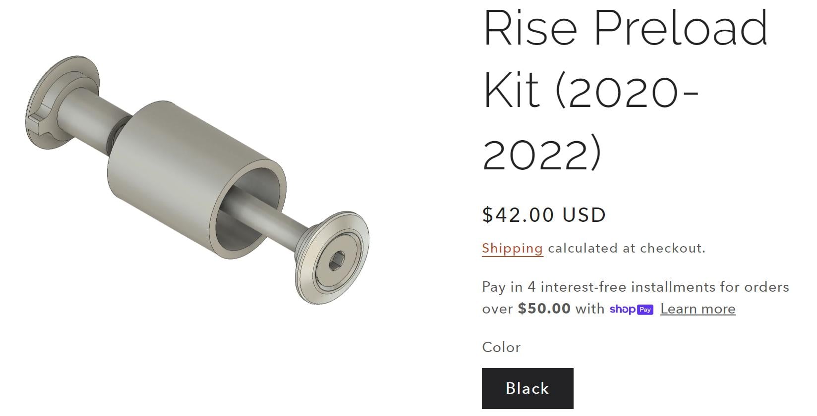

I really like this preload kit made by Cascade. It's made to work with the linkage arms shown above. Makes you wonder if a person could adapt it to work with the stock Rise linkage arms.
