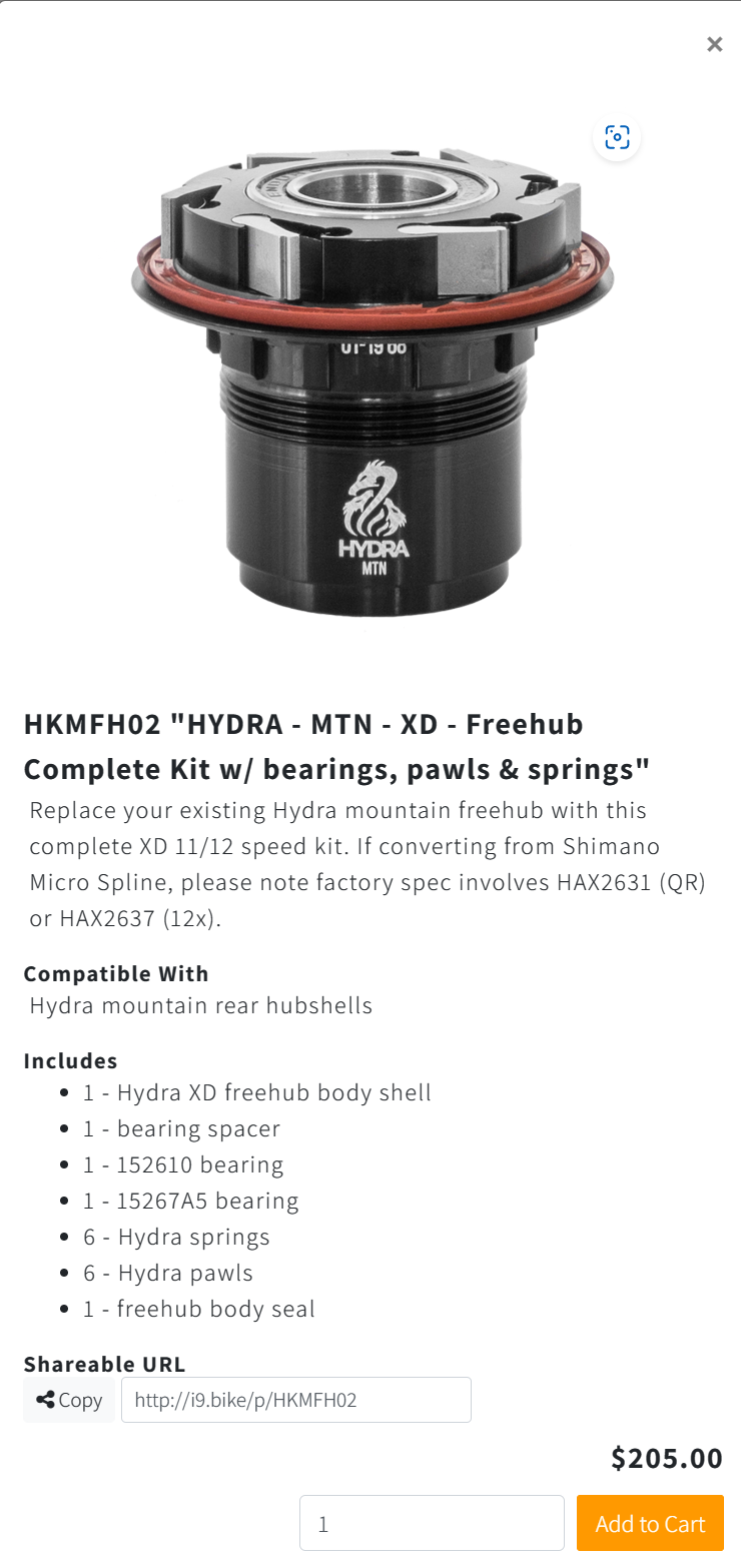

I'm giving this a shot. Have an XO transmission on the way. Just going to try it with the current E13 32T chainring and crankset.
I have i9 355 Carbon wheels with Hydra hubs and a microspline freebody, so I ordered this XD driver (and end cap) from i9:

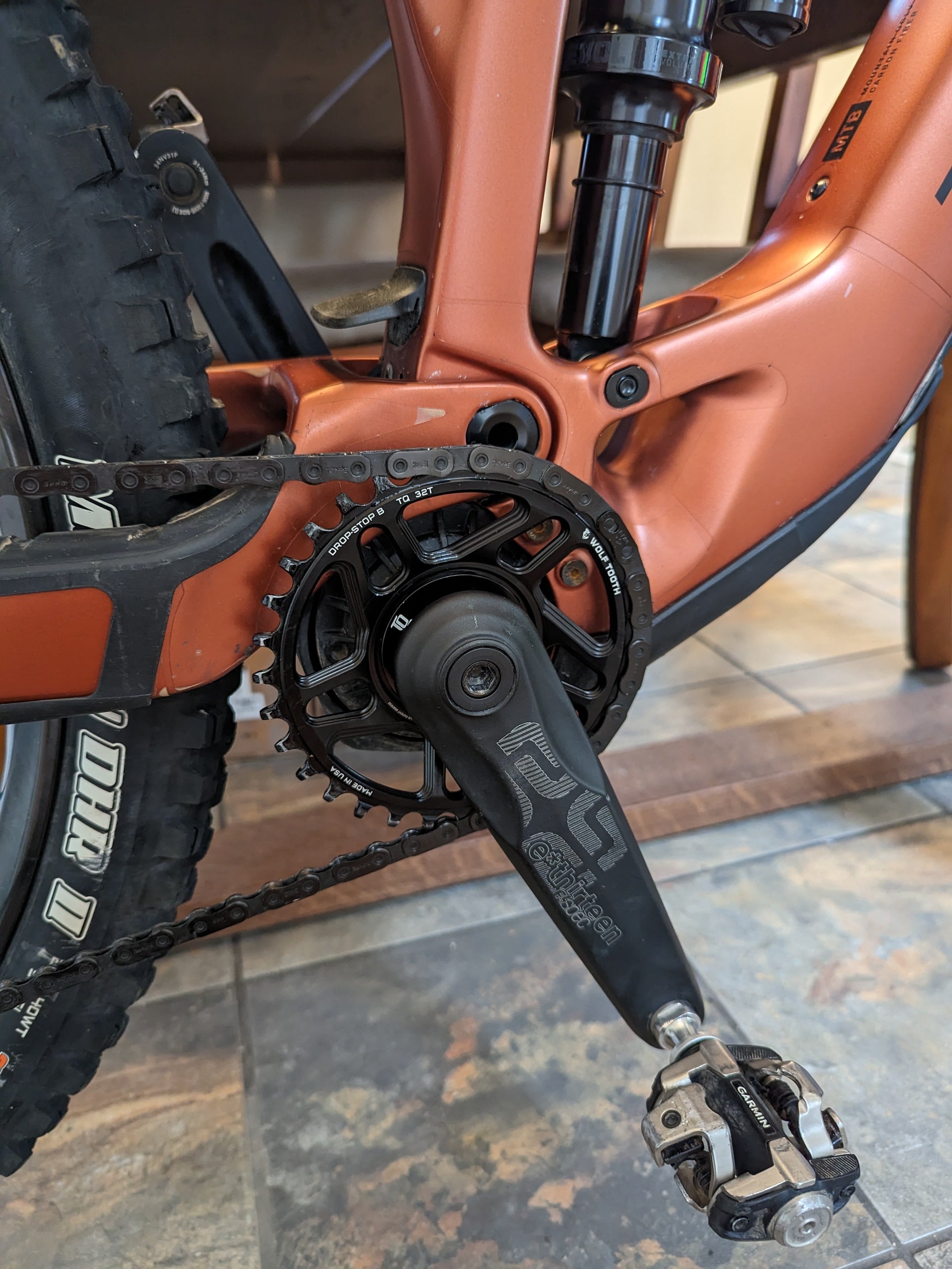

Wolftooth has TQ direct mount chainrings specific to T-Type chains. I am installed it on my Fuel and have got the XO Transmission. I can attest that the chain ring works great.
Here's the link for either a 32t or 30t. Note that your want the Drop Stop "B" for T-Type.

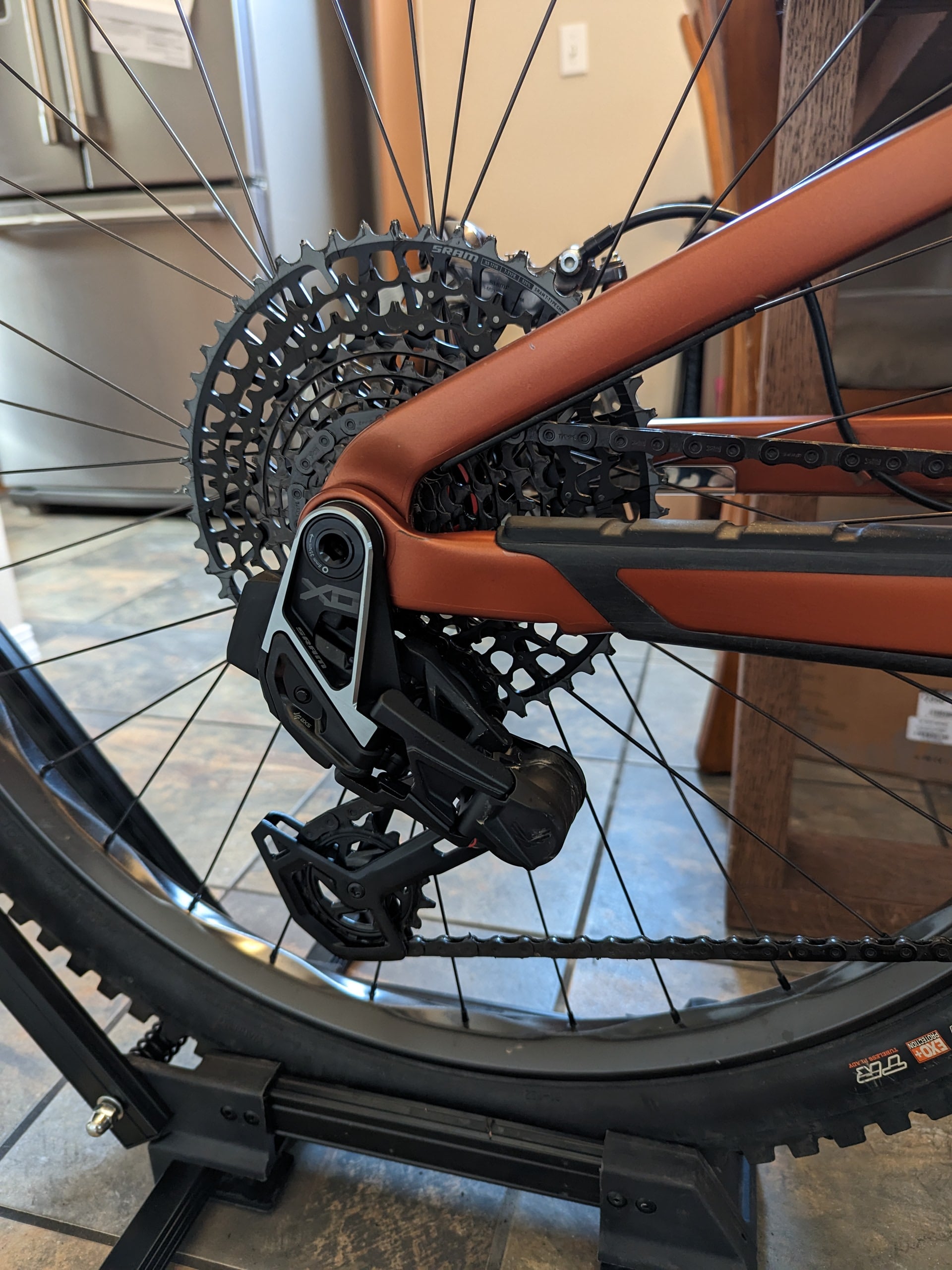

Yeah, you remove everything to do with the UDH including the washer this is all replaced by a bush frame insert (part No5 in the linked PDF), don't worry, the bearing wont fall out and there is no spacer to fall out ether.

Just an update I've installed the new T type XX transmission on to my Fuel EX-E 9.9 and it all works perfectly, really easy installation.
I have left the stock front chainring on which came with the bike (32T sram ring on spider) as I couldn't figure out how to get the retention ring off (I know now) and it works perfectly so it doesn't look like you need a T-type specific front ring for the system to work.

I run the wolf tooth t type specific chain ring and it works perfectly.
