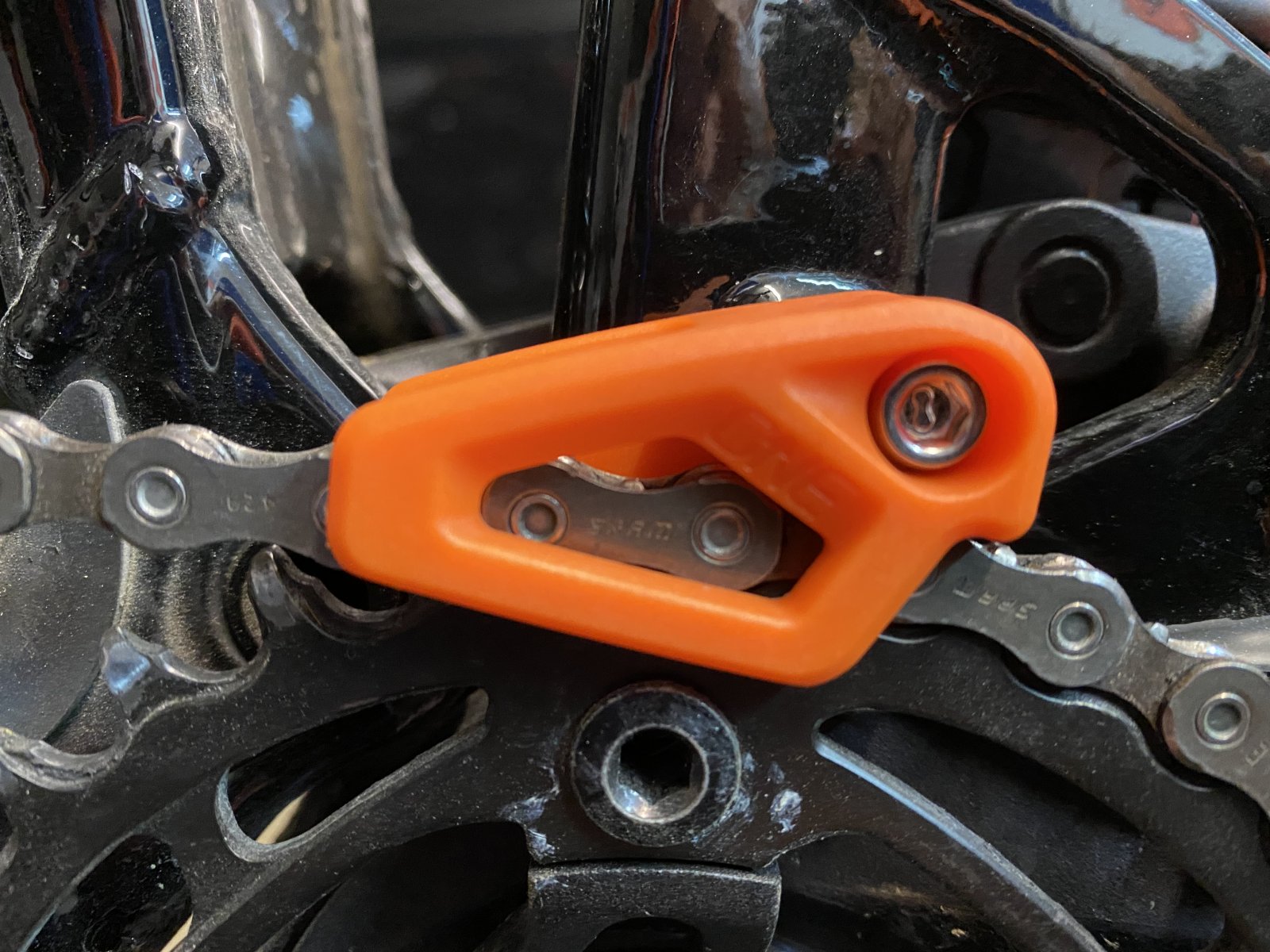

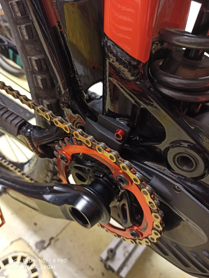

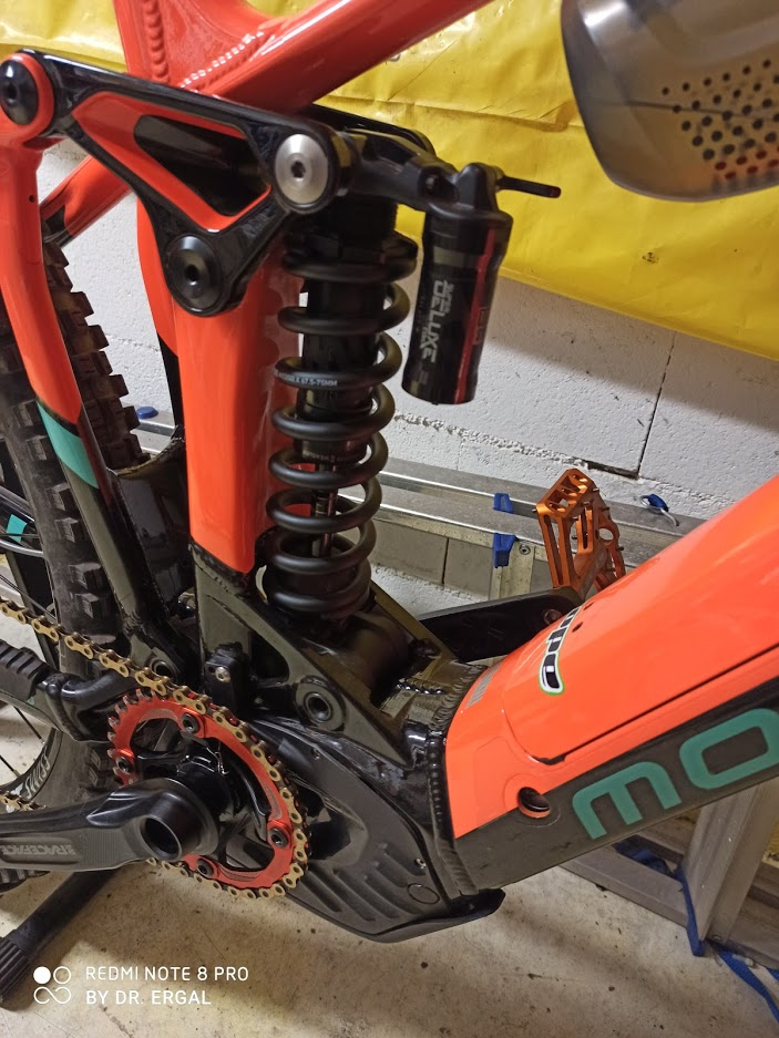

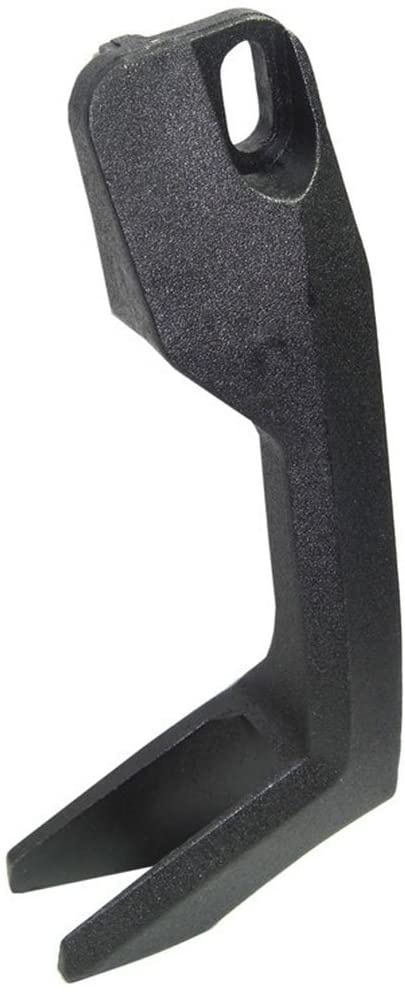

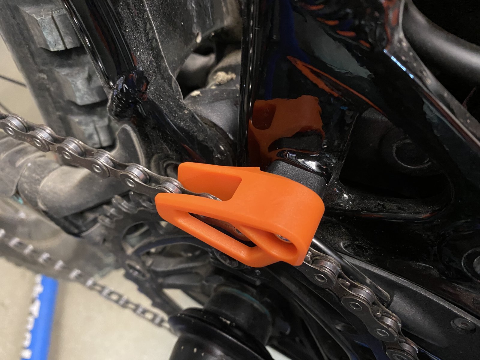

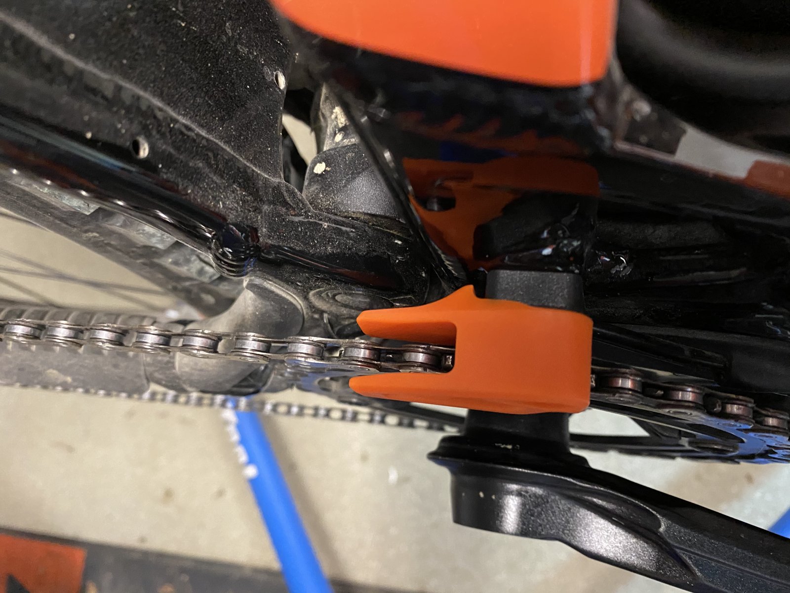

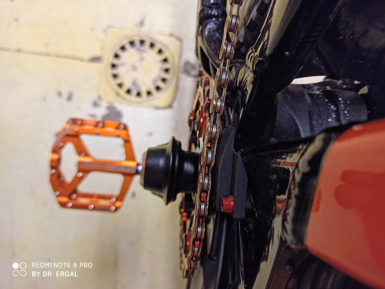

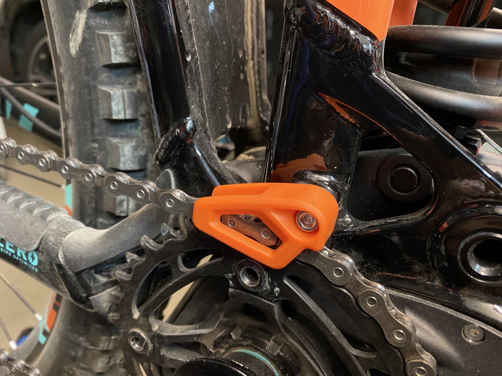

INTRODUCTION:
Never lost my chain, even in the roughest terrain or DH trail I run, but the delaer who sold me the bike (we're still in contact) refers me that some customers complaints about this issue
That's why I decided to make a 3D printed prototype to be installed in the place of the originale component
It has an appendix that follws the upper beam of the chain some cm before it engages the chainring. It also had a protrusion to host the rear deralleur cable
Standard stuff
"Dr. Ergal" stuff
even when engaging the last pinion, there's room enough
Still need to be improved; I had to refine some details with sandpaper.
After a period of test, I'll refine the final geometry per 3D printing, so I can help my friend (the dealer) to match his customer's complaints

just for info - the Haibike I ride also has a chain guide but it guides from both sides of the chain;
Dr. Ergal
Mar 4, 2020
46
73
Italy
I know (thanks for sharing :) )
The Level frame, unfortunately, does not allow to install such components
I also thought about a "2 sides" guide.
This is just the prototype; probably I'll embed your suggestion making a double side chainguide

Has anyone tried if a oneUp or similar chain guide slider will fit? I mean just the top slider if it will fit with the original screw position. On my Level I often loose my chain. Its a pity that there is no proper chain guide on such a bike, the crafty carbon also has one but the level which is for much rougher terrain hasn't.
