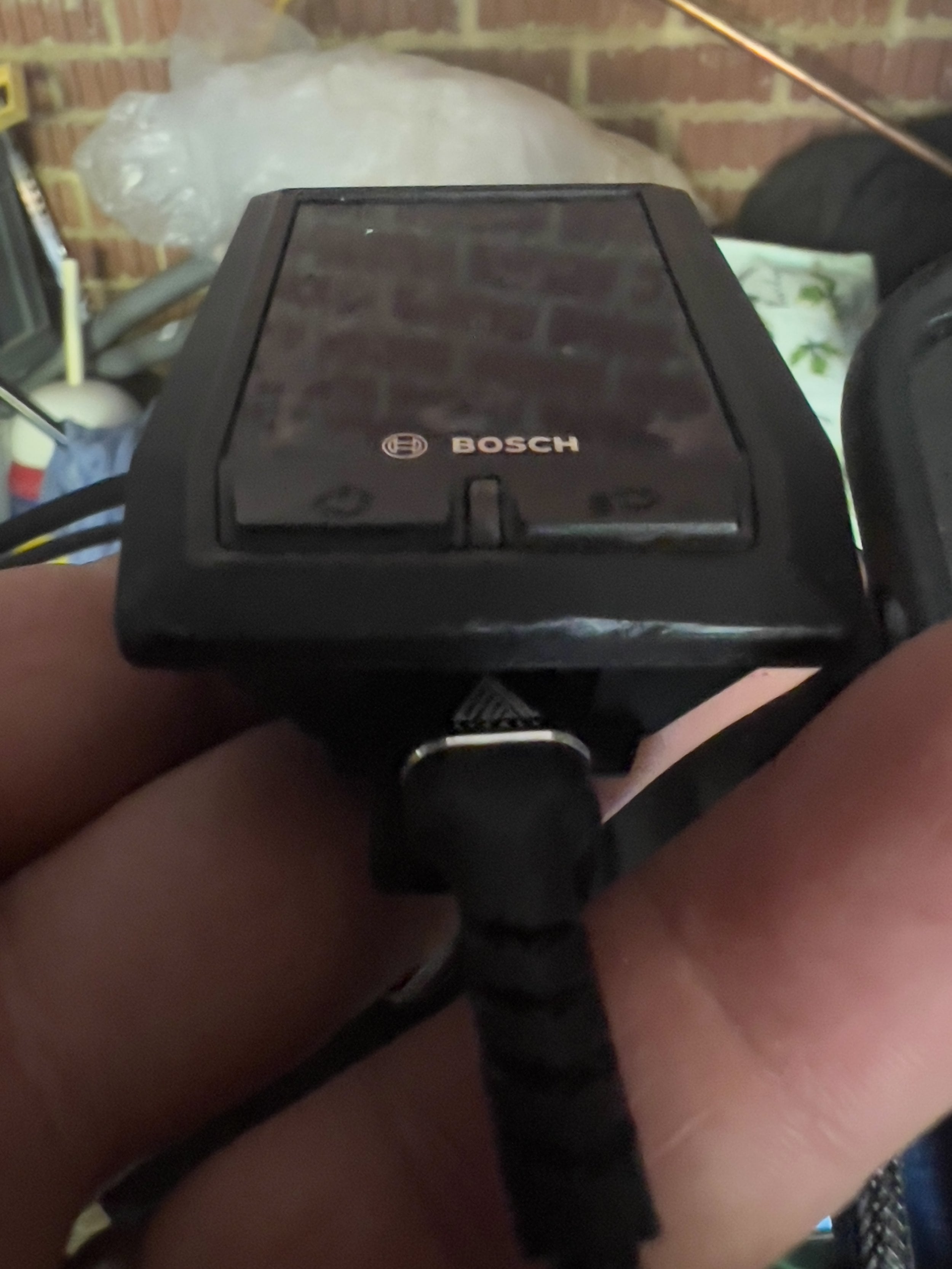

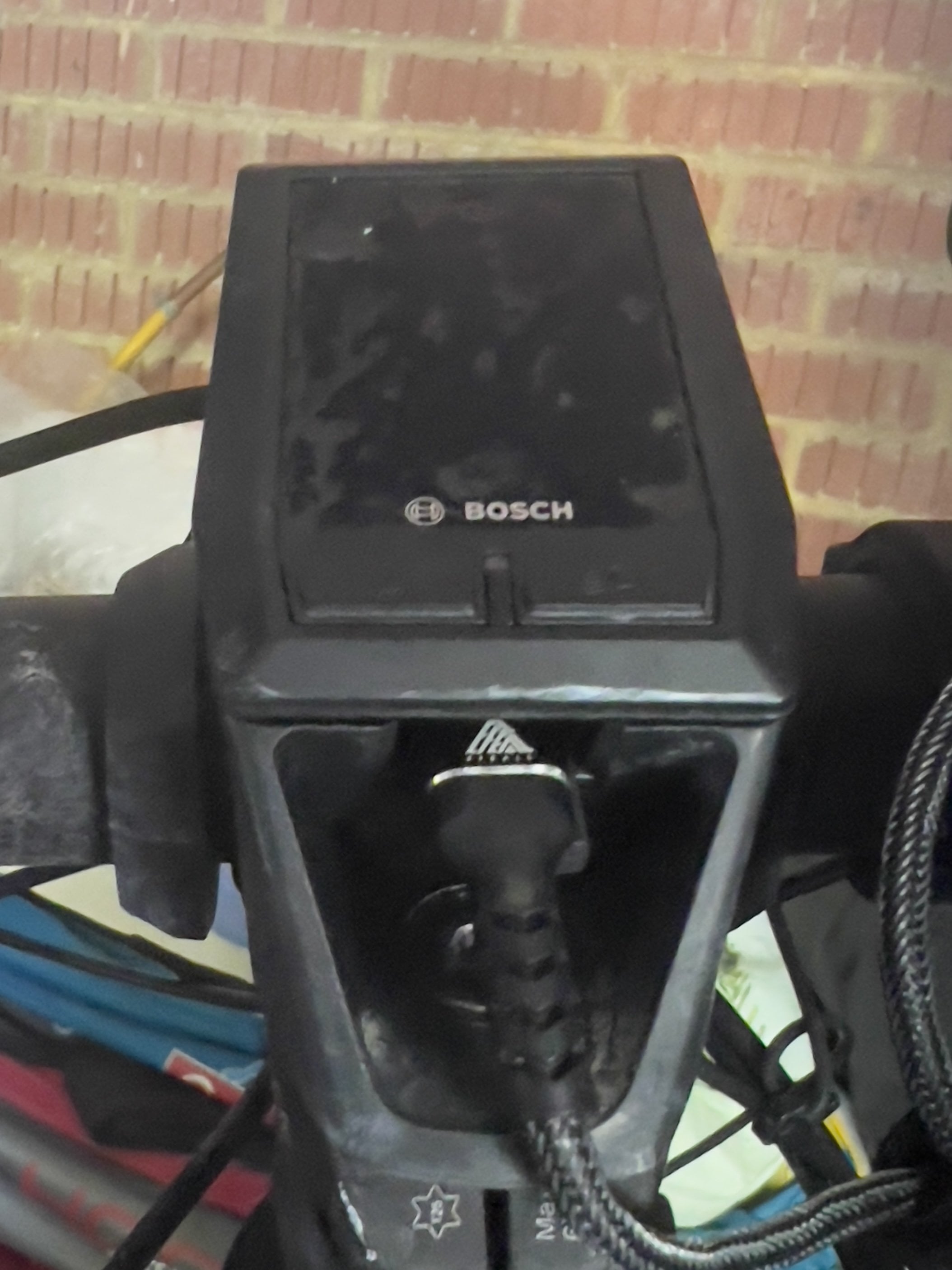

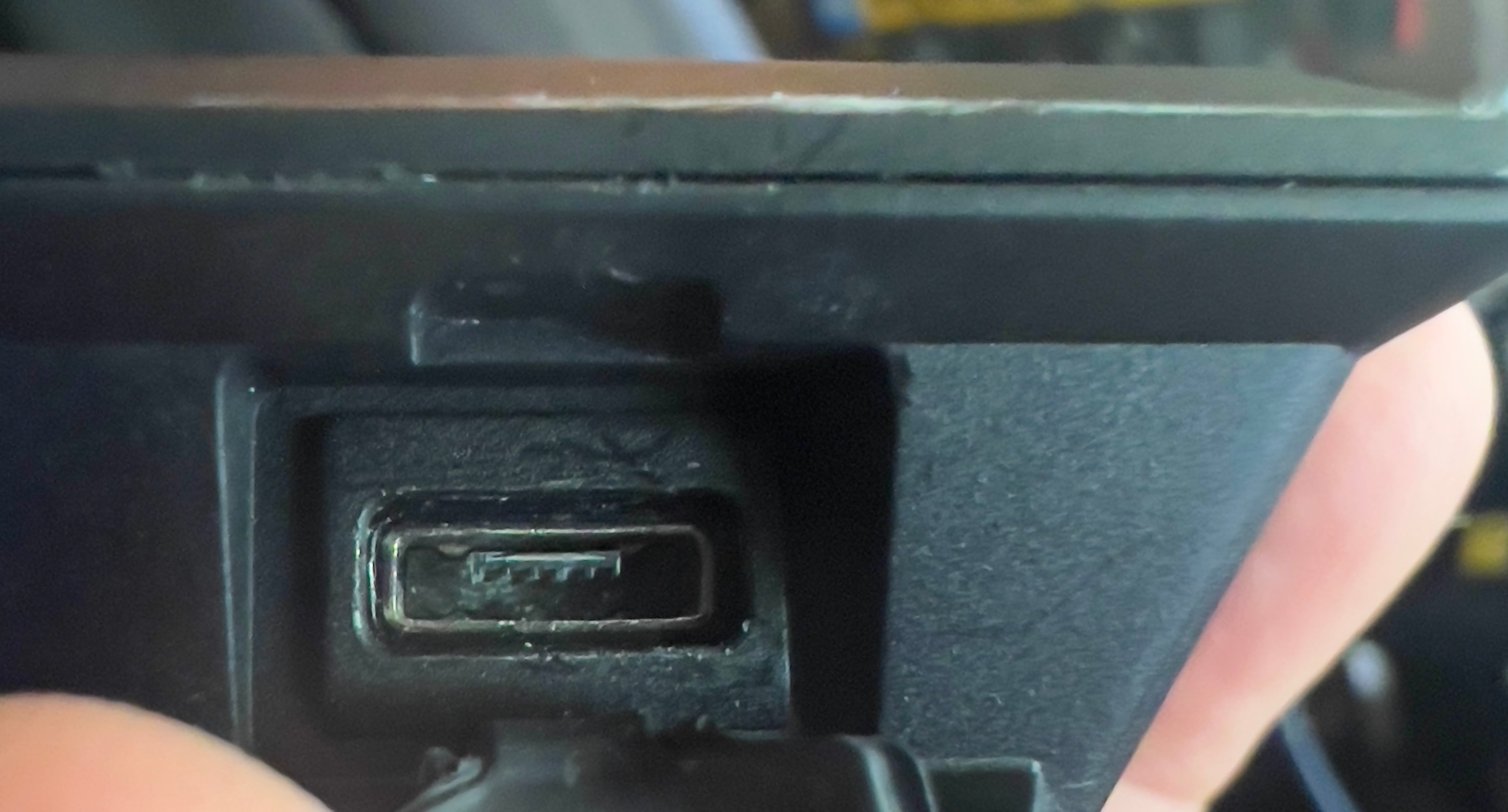

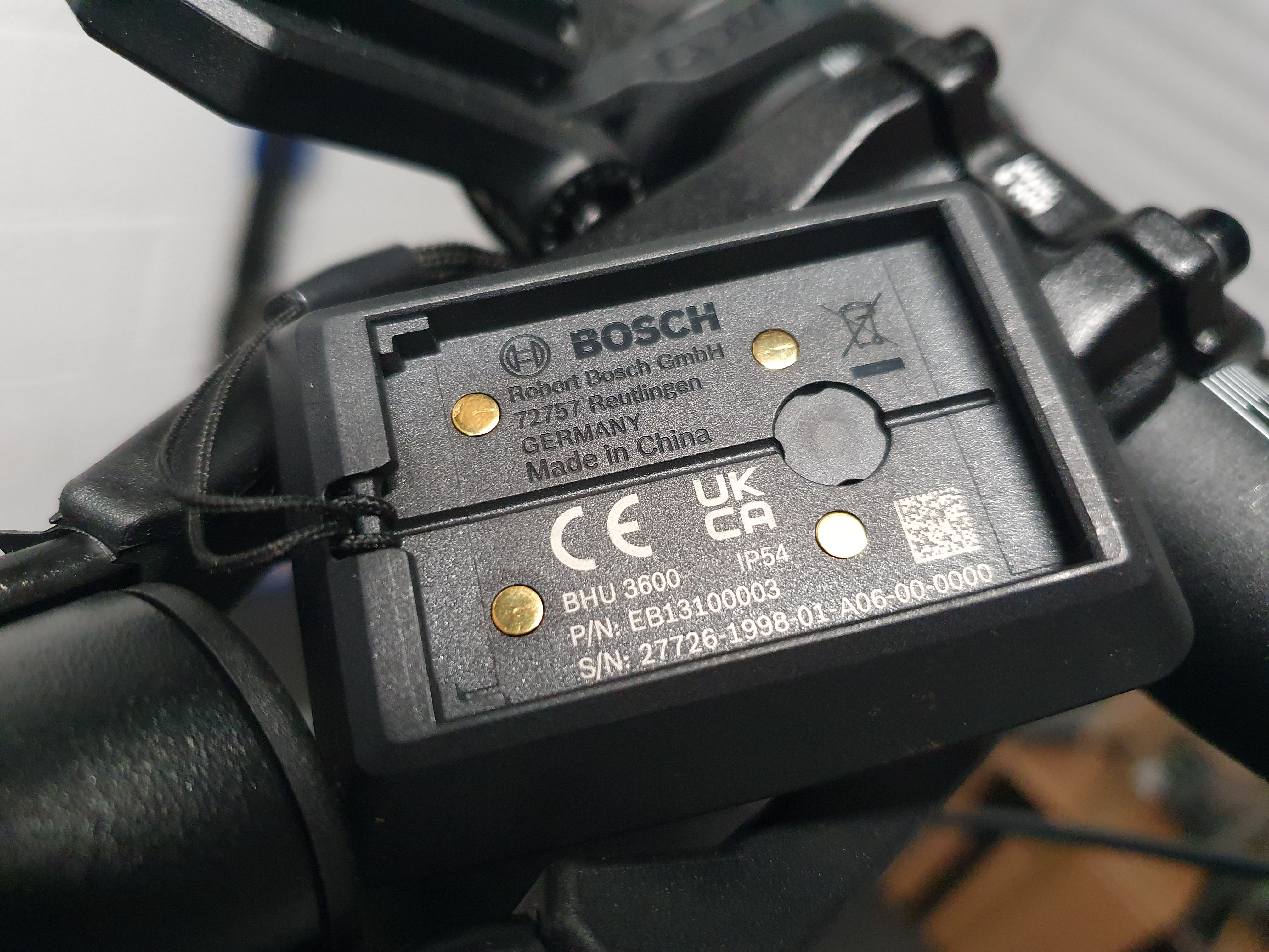

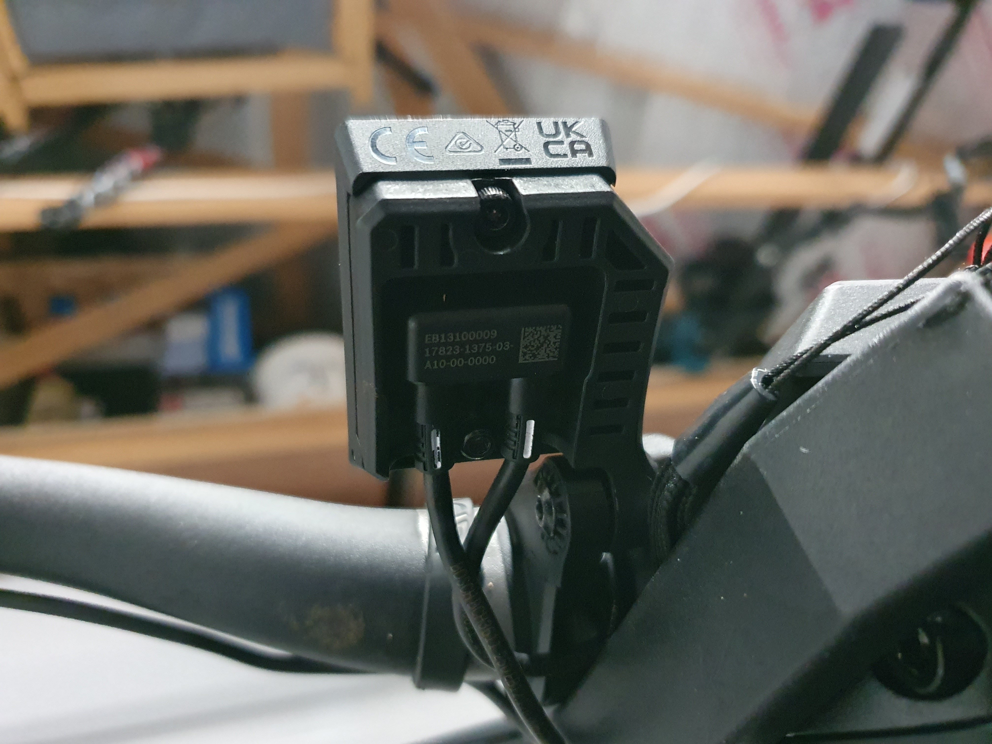

To help here’s some images of my Kiox 300 showing the power out port. The correct connector is a Micro A USB but a Micro B will work as it’s the same pin layout. This is on the non flow system

Ahhh, you are correct 😟
Got confused on the Bosch site. I bought the retrofit Kiox which appears on the same page as the 300. So assumed that was the unit! It looks like the 300 is for the Smart system.
Sorry for confusion.
